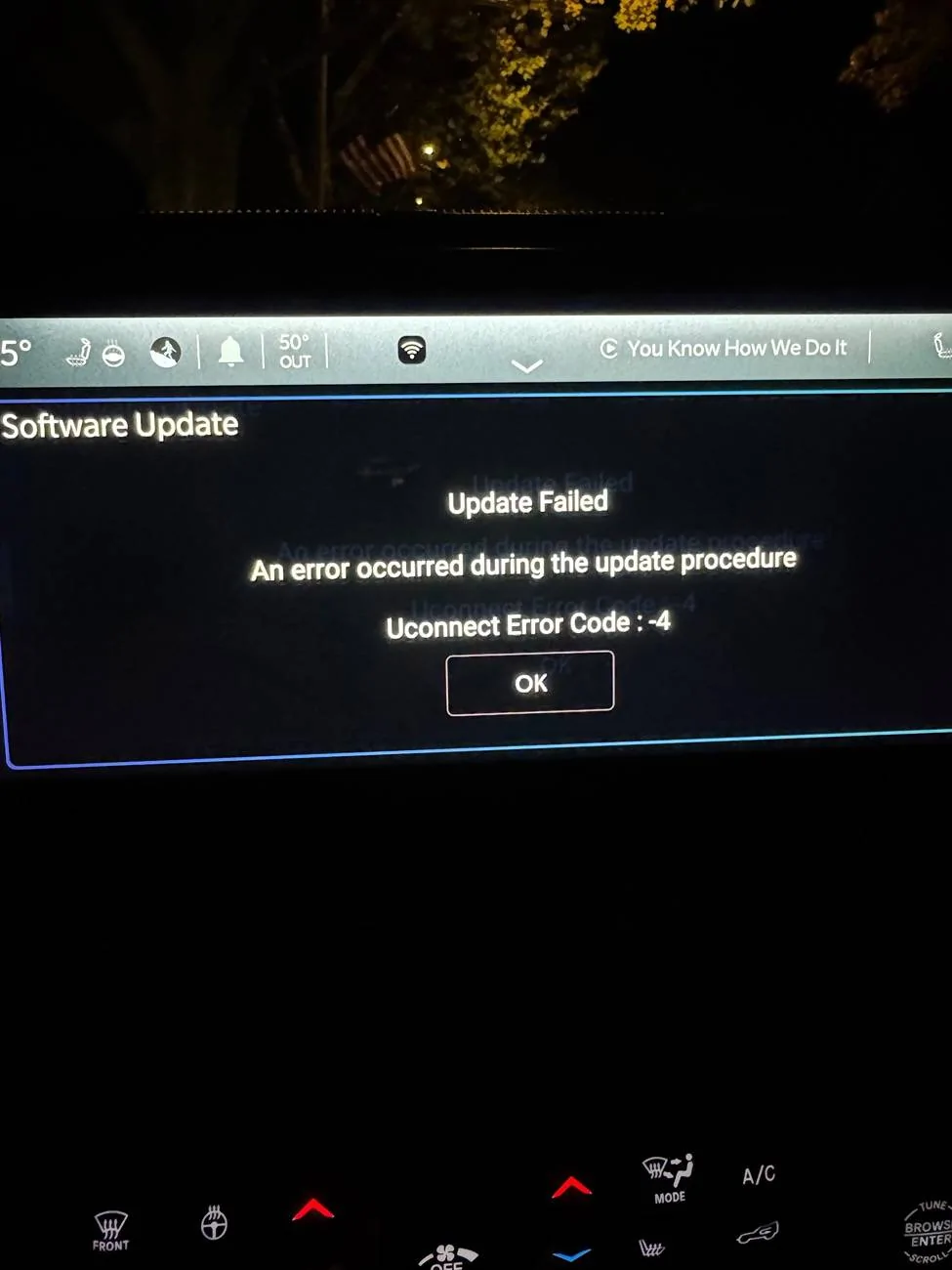

Unfortunately nothing positive to add. Every once in a while my phone won’t connect, no car play no Bluetooth. I’ll have to shut the vehicle and phone down completely and it usually does the trick. Occasionally I was getting this message, it seems to have gone away since I re-connected it to my personal hotspot on my phone. 🤞🏻🤞🏻. U connect is pretty terrible, Ive had jeeps for 20 yrs. I also have an Audi Q5 and what ever interface it uses is worse. Phones and cars have always been an issue.

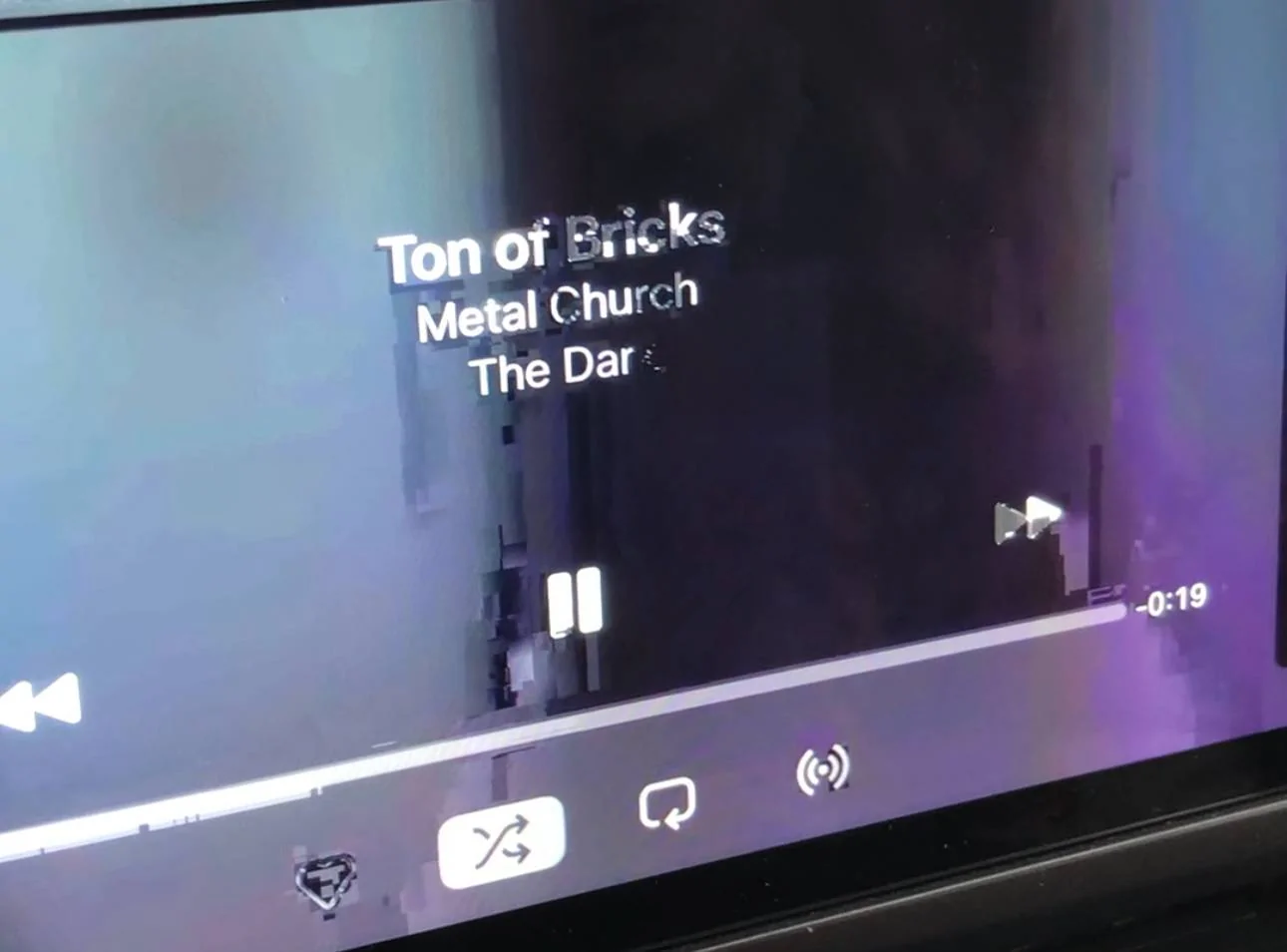

Purchased a 2024 Wrangler 7 weeks ago with a faulty system. Starting within the first 24 hours of purchase (2/10/24 - most recent on 3/23/24):
- COMPLETE loss of audio (radio/siriusXM/carplay). Reset resolved the issue.
- Screen freezing/unresponsive. Has occurred multiple times and often takes many resets to resolve and come back online.
- Carplay unresponsive (song appears on screen but won't playback - whether asking Siri or pushing button on screen). Can still make a phone call and view other apps. Has happened multiple times.
- Siri crashes - pushing the command button does nothing.
- Songs skip during playback (brief, 1 second blackouts). Sometimes 1-2 times per song, sometimes days pass without issue.
- Screen glitching and causing the graphic on the display to pixelate (Mar 24- photo enclosed). Reset resulted first in a black screen but soon system started up as if nothing happened.
Anyone else experiencing this? The dealership refuses to investigate further without first hand proof which is hard with these intermittent problems - but I’ve recorded multiple occurrences of each problem as it’s happened. Seems strange that the warranty wouldn’t cover this and I can’t imagine that that I’m just left with a brand new car that doesn’t function properly, right? I do have an consultation with a lawyer next week to find out what my rights are vs. theirs but thought it wouldn’t hurt to come on here and learn from others who’ve maybe experienced this in the past or present. Any stories or advice warmly welcomed.
