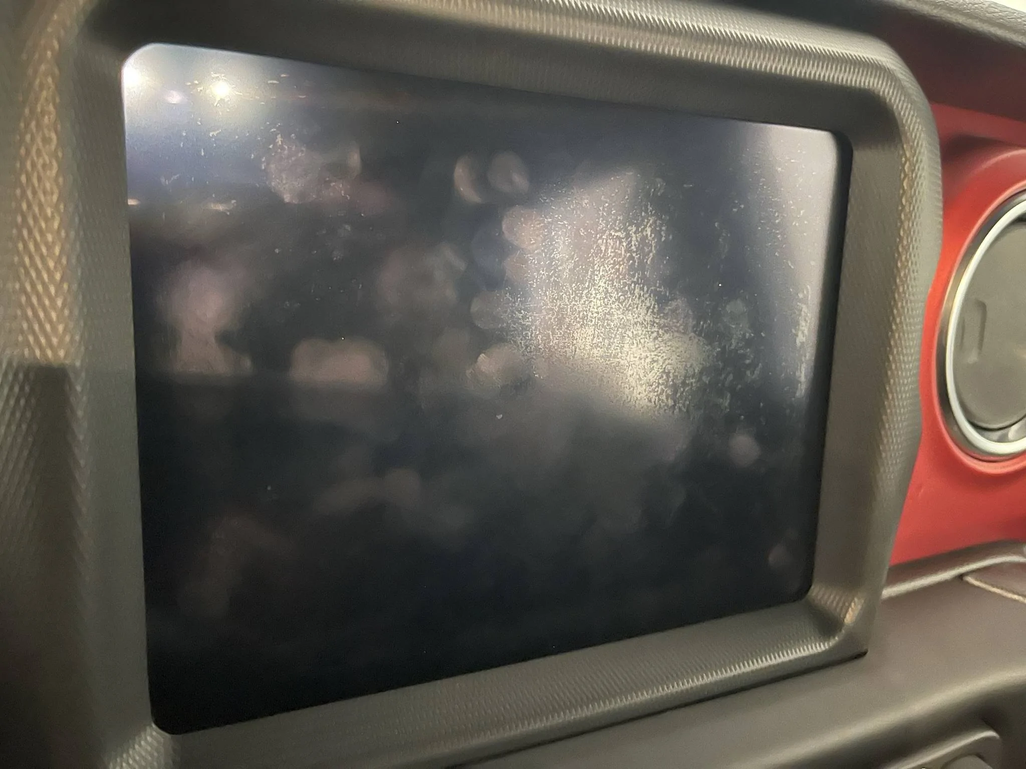

UConnect screen wear

Did you ever get this resolved? I recently bought a used Jeep thats still under warranty and the screen looks like this:
What you're seeing here is the oleophobic coating on the screen coming off. Unfortunately, Jeep won't replace this kind of damage under warranty. They'll cover screen delamination, but they'll consider this general wear and tear.

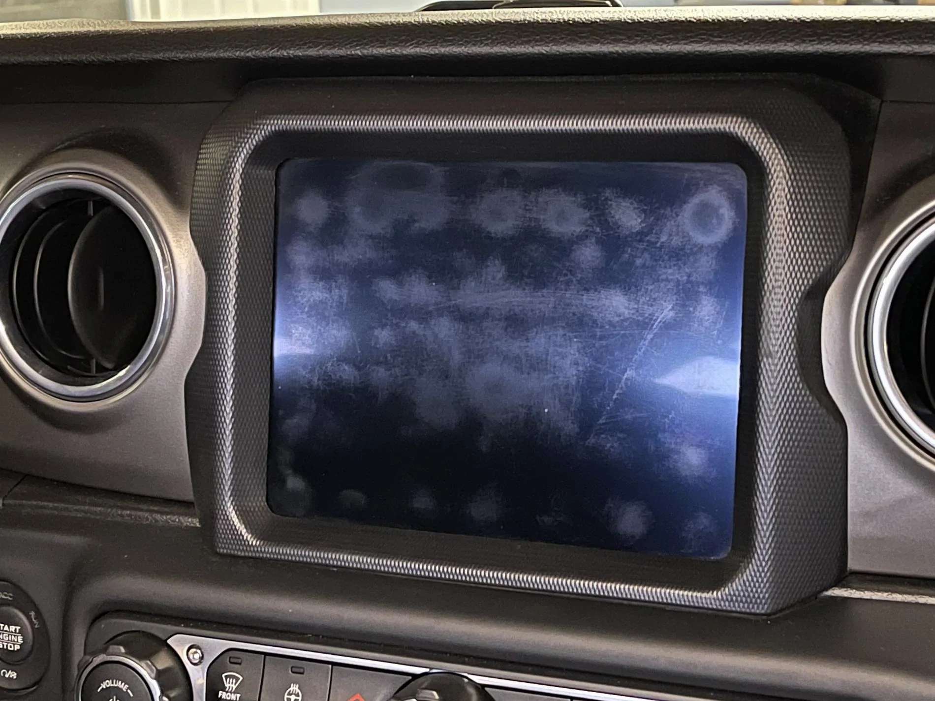

I am having a similar issue and the dealer is looking into this but not hopeful as the advisor was skeptic?
Jeep Wrangler JL UConnect screen wear AB2B6806-5C33-4962-B38F-EECD1F94CAA2
Hi Borismd,
Sorry to hear you're experiencing this! Since there are no active recalls in regard to touchscreens at the moment, this would be something that would be handled accordingly under the applicable warranty. Your dealer is equipped with the resources to properly diagnose the concern and appropriately apply the terms of your warranty. To learn more about your warranty, please visit Official Mopar Site | Current Model Year Coverage .
If you decide to proceed with getting your Uconnect touchscreen fixed, you can certainly hold onto your receipts/repair orders. In the case that this becomes a recalled item in the future, you are more than welcome to reach out to our team in regard to cost assistance, at that time.

The screen on my 2019 is all messed up too. I thought it was oil residue from my fingers, then tried to clean it with a microfiber cloth just to realize the coating is scratched and it looks like a cheap POS. I'm not happy...
Did anyone installed a protector over that shit? Does it "hide" it or it's just a waste of money and time?
I think it's possible to restore the oleophobic coating with a liquid application (it is for phone and tablets so I guess it would work on our screens), then put a screen protector over... but I don't know how risky it is...
