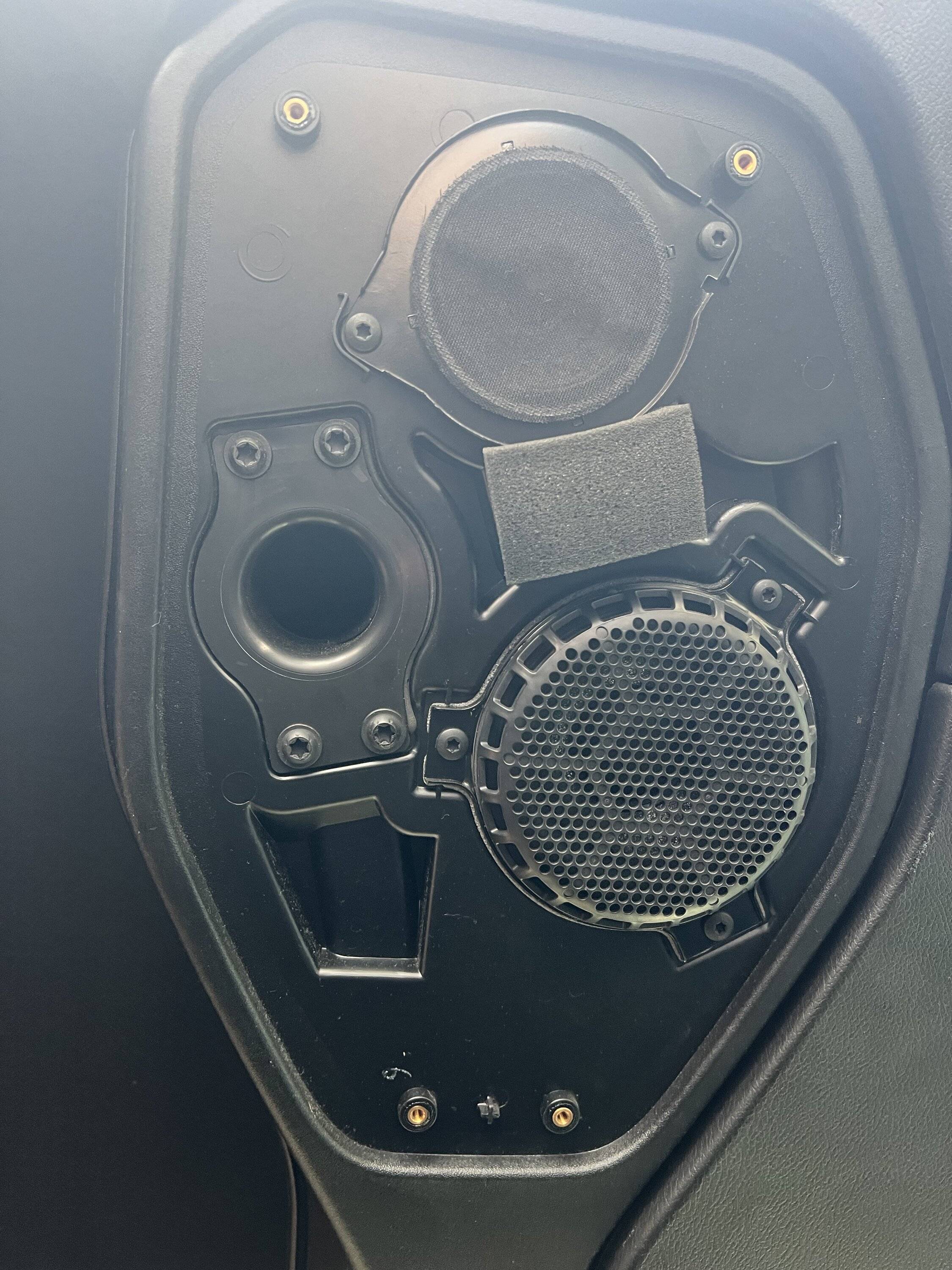

Hello all! New member here, name’s Dave. I live in the Hilton Head area of SC. I have a 2018 JLU Sahara, I’m the second owner, I bought it 2020.
I’ve never been thrilled with the audio system, and I’d like to improve it, but I’m realizing I’m not sure what is currently installed. I had assumed it’s the standard system, but when looking at replacement speakers for the sound bar, I “MAY” have the premium system? Except, I don’t have a subwoofer anywhere, so perhaps I don’t have the premium system (?). Attached is a pic of one side of the soundbar - I’m hoping someone can help identify what I have? Thank you in advance and I hope you all had a safe and happy Thanksgiving!

Do you have the 8.4” radio or 7”?

Thanks for responding! It’s the 7” radio.

If you have the 7" and no sub, then you have the "base" radio.

Yeah I was starting to figure that's what I have, the basic system. Thanks for verifying.
So, like I mentioned, I'm underwhelmed by it. Also, the soundbar vibrates horribly, to the point I have the fader adjusted 75/25 (front/back), and I have the bass turned down quite a bit, otherwise it's unlistenable due to the vibration/rattle. I've tightened all the screws and inserted some padding where i could between the plastic and metal frame, but no luck. The only thing that stops it, is when I touch anywhere on the soundbar, it dampens it and immediately stops vibrating. Currently I have a couple bungee cords wrapped around it which only helps a little. It sounds like a crappy transistor radio became of how I have the settings, but that's better than the vibrating!
One of these days I'll disassemble it and take a closer look. Maybe install some dynawrap inside it. And while I'm at it I'd like to replace the speakers. I'm liking the idea of the Select Increments pods, where you can replace the existing small speakers with 6.5" speakers.
If anyone else has been down this road, I'd love to hear your experience and what choices you made. Thanks!!!
