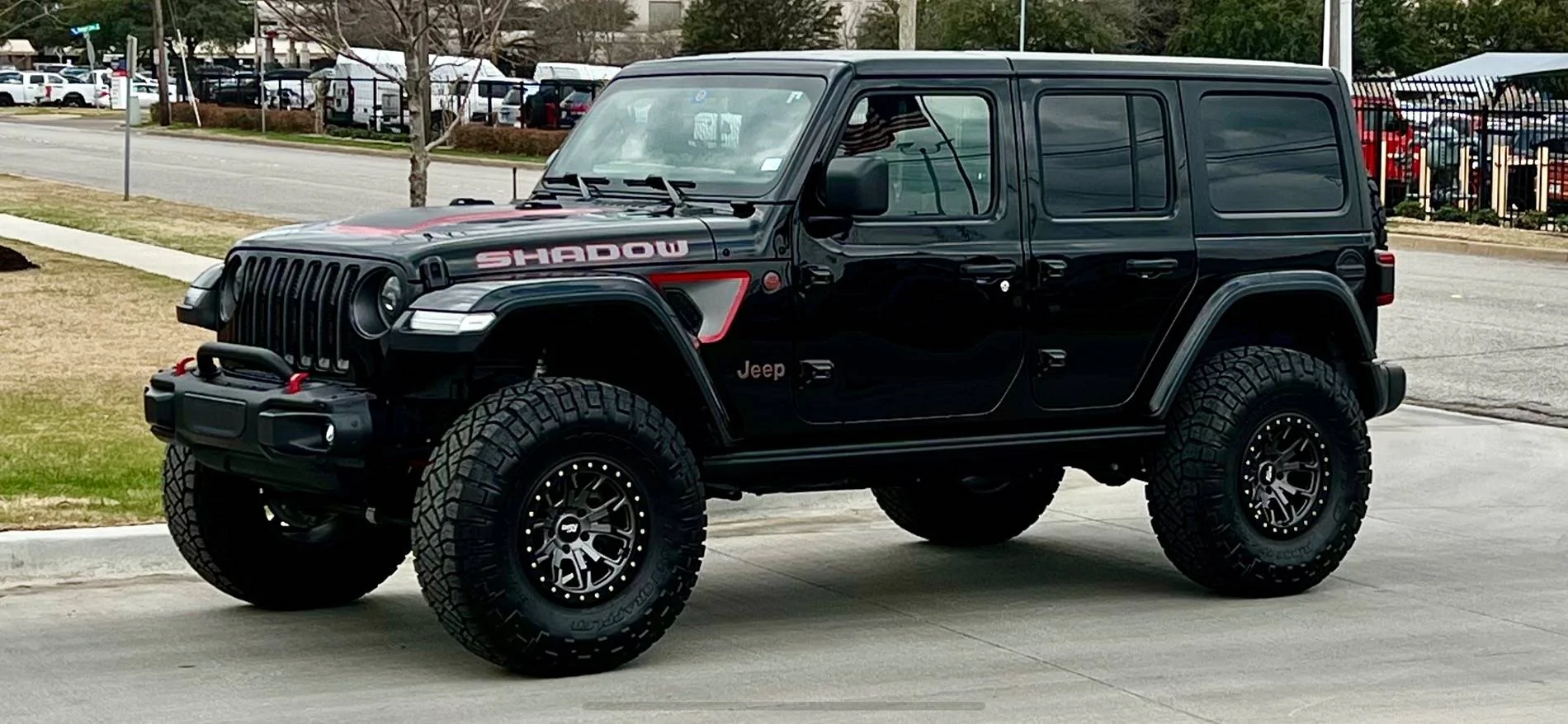

Many good replies here but I may suggest 3.5” unless you have a specific need for that height. LCG is always a benefit IMO. 3.5 would be plenty of lift for 37s, if you ever decide to go larger then consider gutting flares to gain a little more room. This is just a suggestion and my opinion. Here is pic of 37s with a mopar 2” lift with 1/2” spacer in front for reference.
rig looks good....thanks for the info..I'm not fully decided on what I will get yet...
