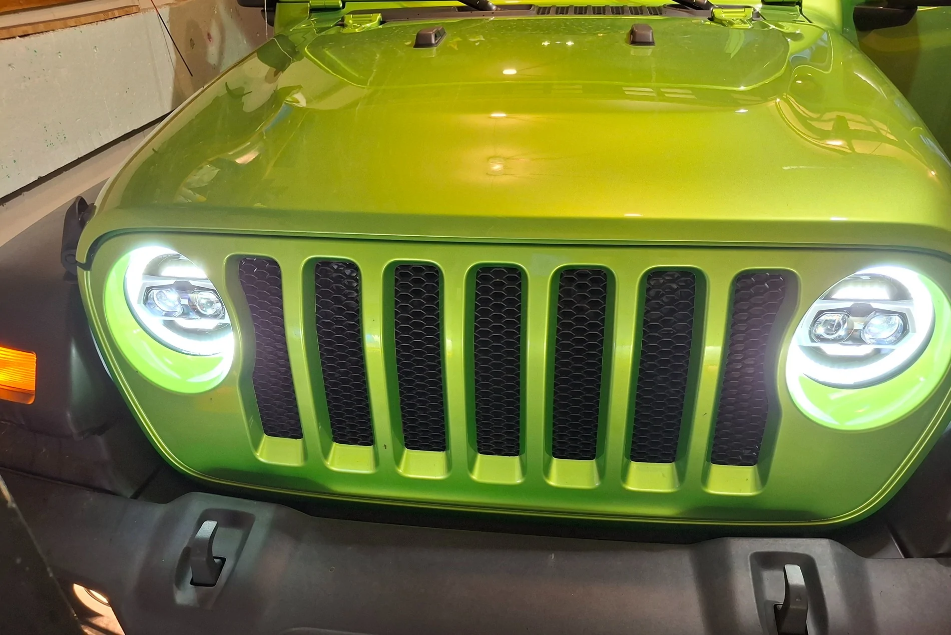

I mod my headlight with true mod, seems a bit improve from my led bulb and huge improve from my halogen factory light.
I got by 5 years with led bulb with original halogen housing, but finally want projector lamp. I hope it last long.
The only problem is when I put it on, my left headlight refuse to lit up when unlocked. I thought it is a burnt fuse, but it is back to normal when I started the engine.
By the way I still can't figure out where is the fuse for headlight.

Does it use a resistor? I would use J-scan to re-program the jeep to tell it its LED's now. That may help if the LED's are confusing the CAN Bus. Thanks

How to do that.
I notice an issue that light once turn off won't be back again untill I restart the vehicle. I thought it related to drl, but now I put the tap fuse wire harness. Issue persist.
J scan to reprogram jeep, yes that sounds like the solution, but never did it before.

Okay I got it right now, I t tap the drl from cigarette cable hence the halo is on. I also jscan set my headlight to be led, so it can switch on and off properly. Because I already ttap the halo as drl, so I disabled the drl setting from low beam, so now the low beam is no longer trigger on by low voltage signal, I think that is important to keep my light in long term.
I hope this after market led survive long run.
