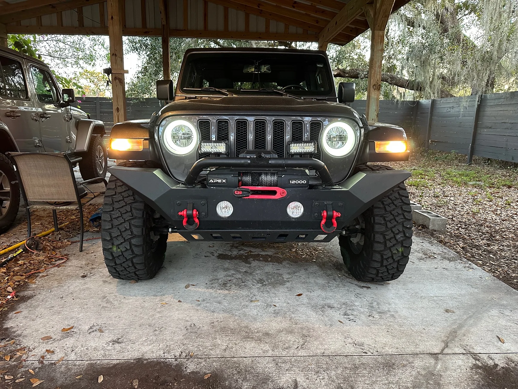

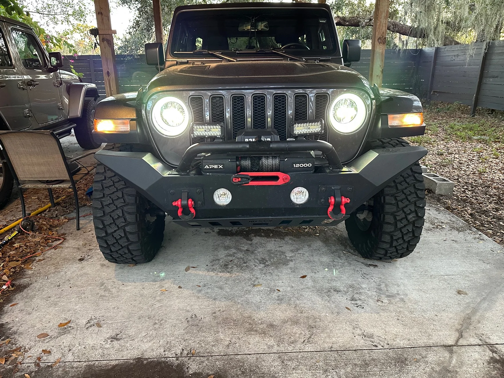

James, yes, there is a fused red wire harness for the DRL halos, that runs to F52 in the PDC (pull the 20 amp fuse and replace it with the fused end of the red wire harness).
I elected to purchase the dual-halo DRL version and connected them. The single halo is also an option; both are the same price. They also sell a version that incorporates turn signals, with another wire harness for that function.
These come pre-aligned from the factory for a stock Jeep JL. In spite of my 2.5” lift, mine are spot-on. I took it out on the road a few minutes ago. Everything was well-lit (better than my previous LED bulb in a halogen assembly setup), and nobody flashed me. The low beam cutoff is crisp.
Here are a few photos showing the appearance of the assemblies with only the DRL in one photo, and low beams in the other.

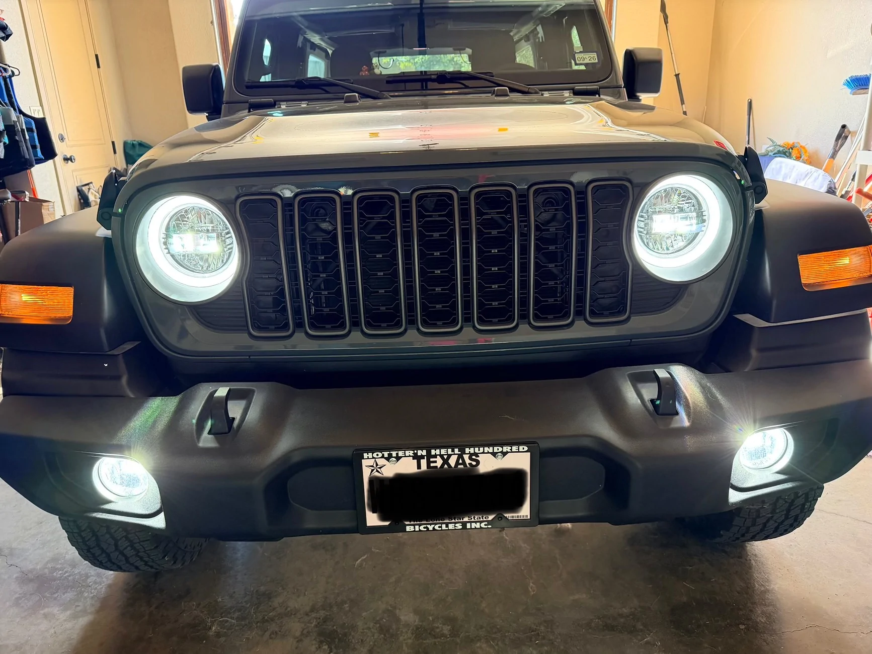

I installed these True Mods headlights about 3 months ago and love them. I did install the wiring for the drl and that works great as well. They were aligned perfectly and no adjustments were needed. Note* the oem fog lights will look ugly in comparison. I upgraded those to led bulbs a couple weeks later.
