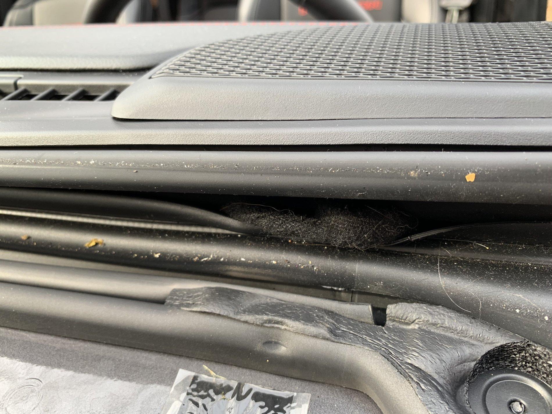

I hope I won’t need to drop the windshield ever again. I was chasing a rattle, and found it! Check out this wiring poking through the seal. It’s been making me mental since I got this Jeep.
Poked in in, some silicone, and flex tape over the top since the silicone wasn’t enough to keep the bent weather strip in place.

Geeez, I'm surprised you were not getting wind noise and whistling also...
