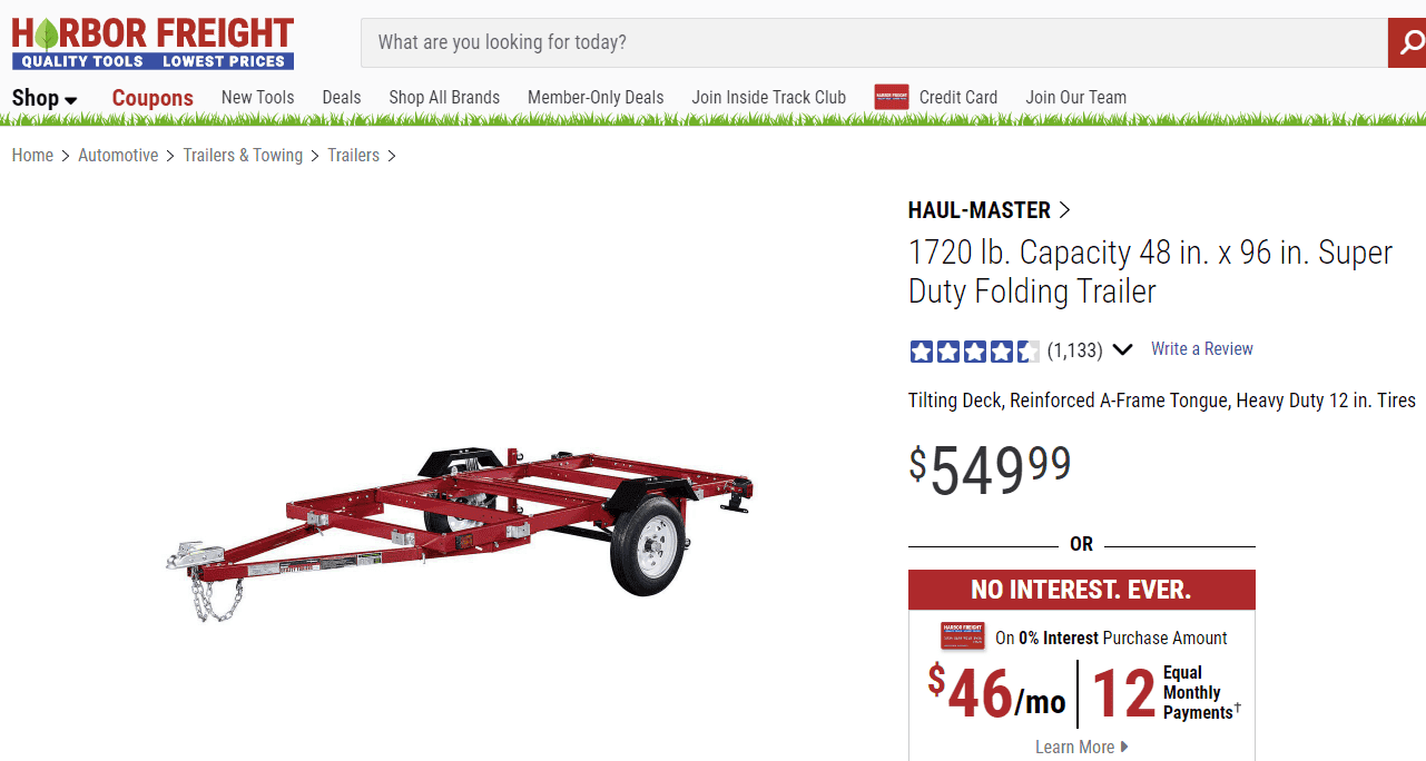

After going back and forth with myself about this as well, weighing the different options from a basic cargo trailer to something fancy that even throws in literally the kitchen sink, and at this point I think I'm leaning towards something super cheap and basic like this:
Jeep Wrangler JL Trailer - Where to Start bMRkZsD
And then upgrading the wheels and tires and buying or making some sort of cargo basket for it.

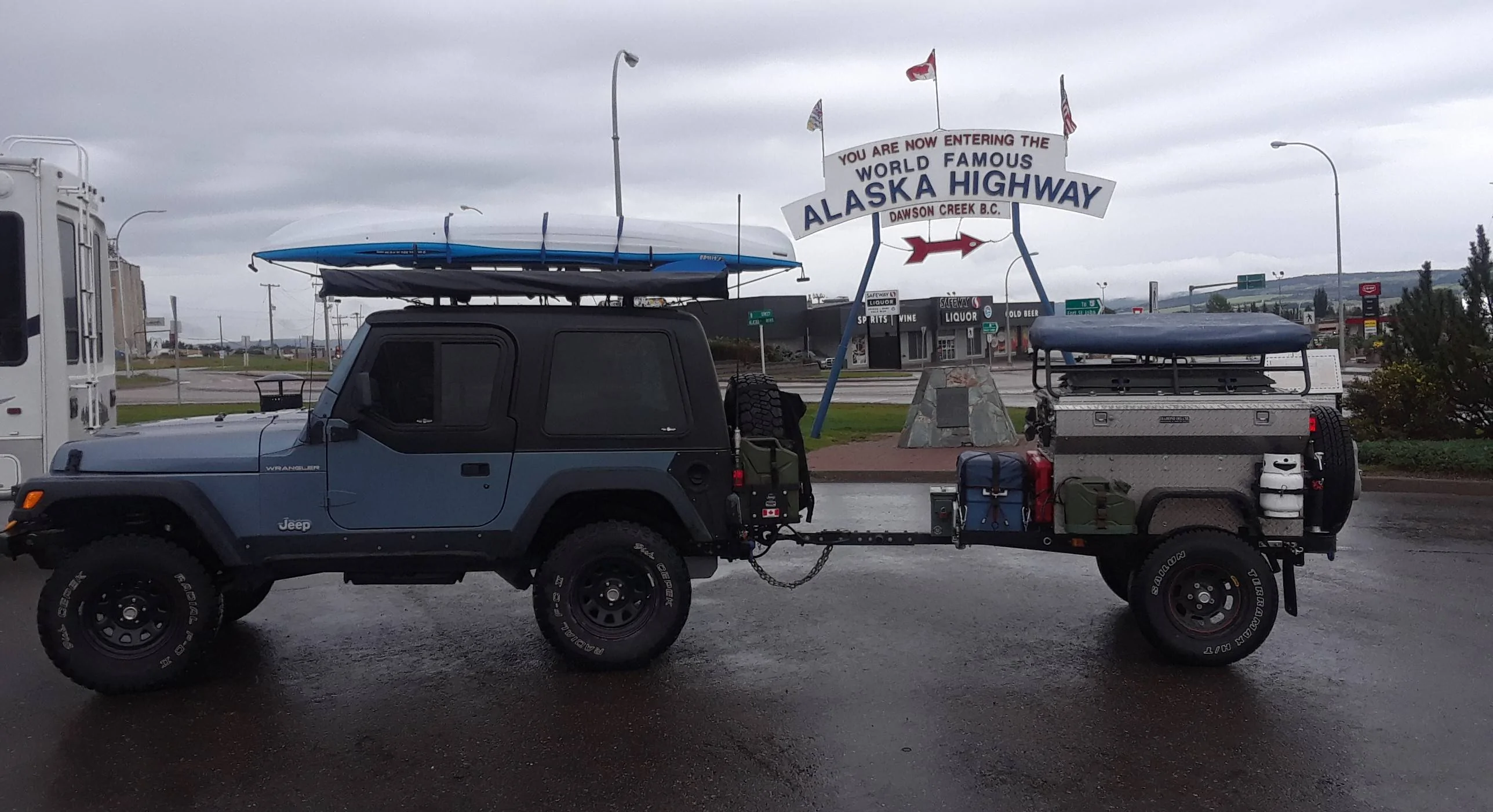

Yes - build your own off a HF trailer frame. That's what I did.
Here's a very long thread I started (with lots if input from others) regarding building a little expedition type trailer off a HF frame. The frames can be narrowed and shortened easily.
Mini Harbor Freight (type) Trailer Ultimate Build-Up Thread | Jeep Enthusiast Forums (jeepforum.com)
I would suggest you get comfortable and sit down and read through the whole thing. It is very long, but once you're done reading it, you'll be ready to build your own. It can easily be done for a couple thousand dollars at the most. Here's mine:
Jeep Wrangler JL Trailer - Where to Start arctic prerun.2
Jeep Wrangler JL Trailer - Where to Start CA pre-run.2 (3)
Jeep Wrangler JL Trailer - Where to Start Arctic Trip.3
That's a double-sized Cabela's Tent Cot on the roof of the trailer. 3500lb axle with electric brakes, real leaf springs vs. slipper springs, etc. etc. etc. Someone else made the tub for me (it is just a box with a hinged lid - nothing fancy). If you can do a Jeep suspension lift, you can build a trailer for off-road/overlanding.

^ @ArmyRN That trailer is epic!! Great job!
I bought one of these about 10 years ago when I had my first JKU and was doing a lot of camping trips with the family. I decked it and built side rails. It is a great little trailer and hauled my camping gear all over TX for several years.

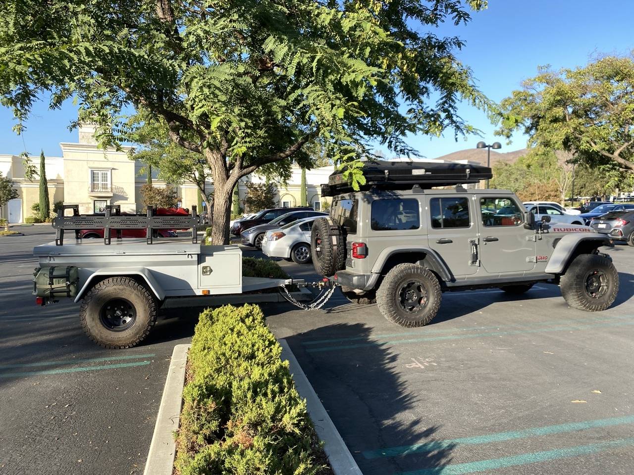

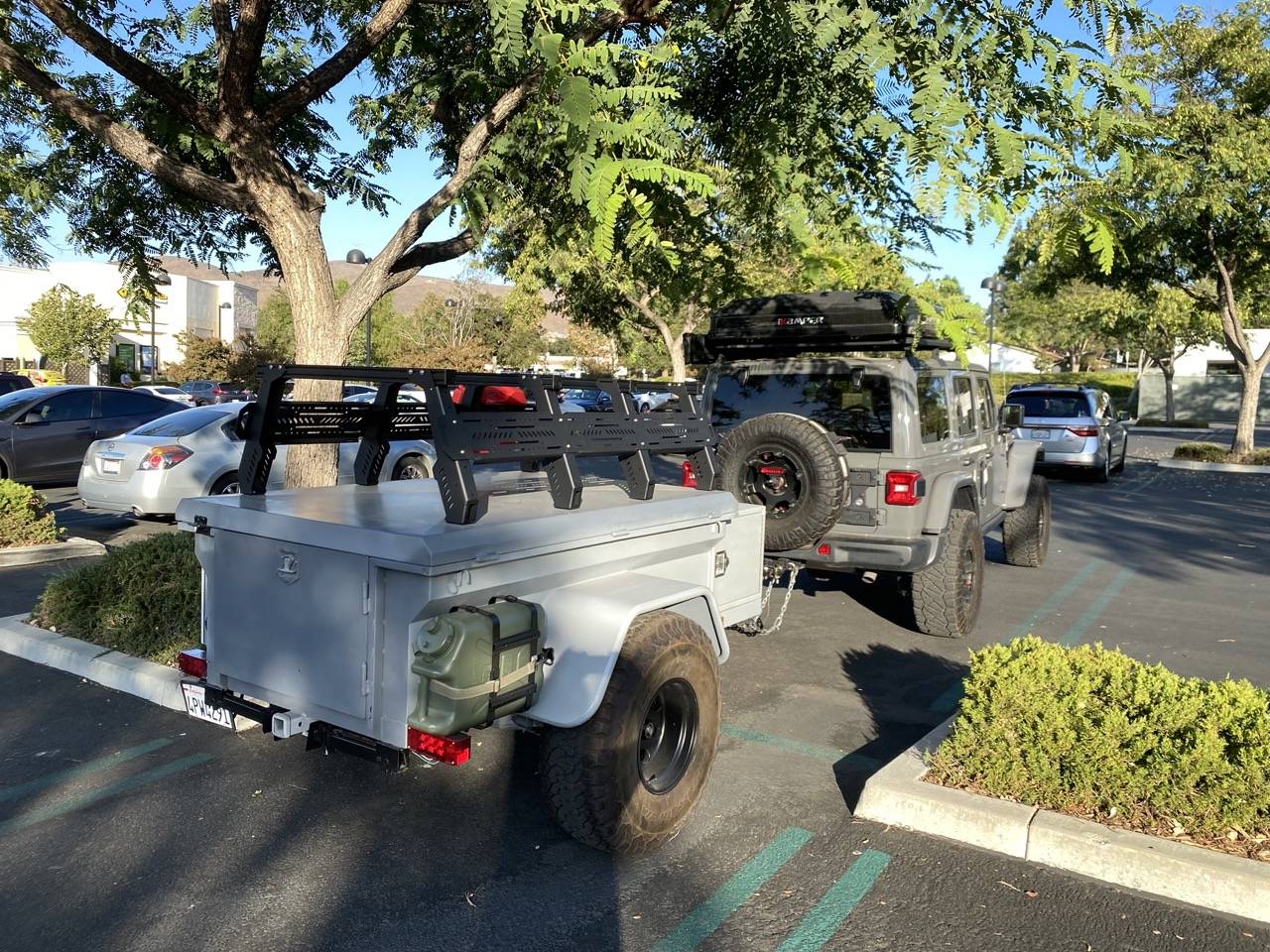

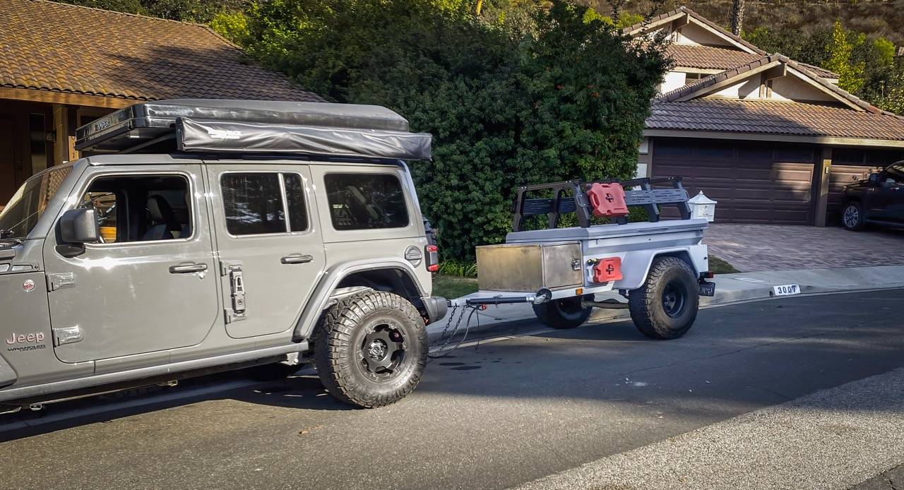

I still need to paint and mount the RTT and awning on the trailer. It has solar, camp kitchen with DC Fridge, running hot water, 20 gal water and gas, and a hot shower. I don't do hardcore rock climbing but getting off grid can get a little technical so you have to plan on rolling the trailer. You need to be able to winch it back on the wheels and continue on.
