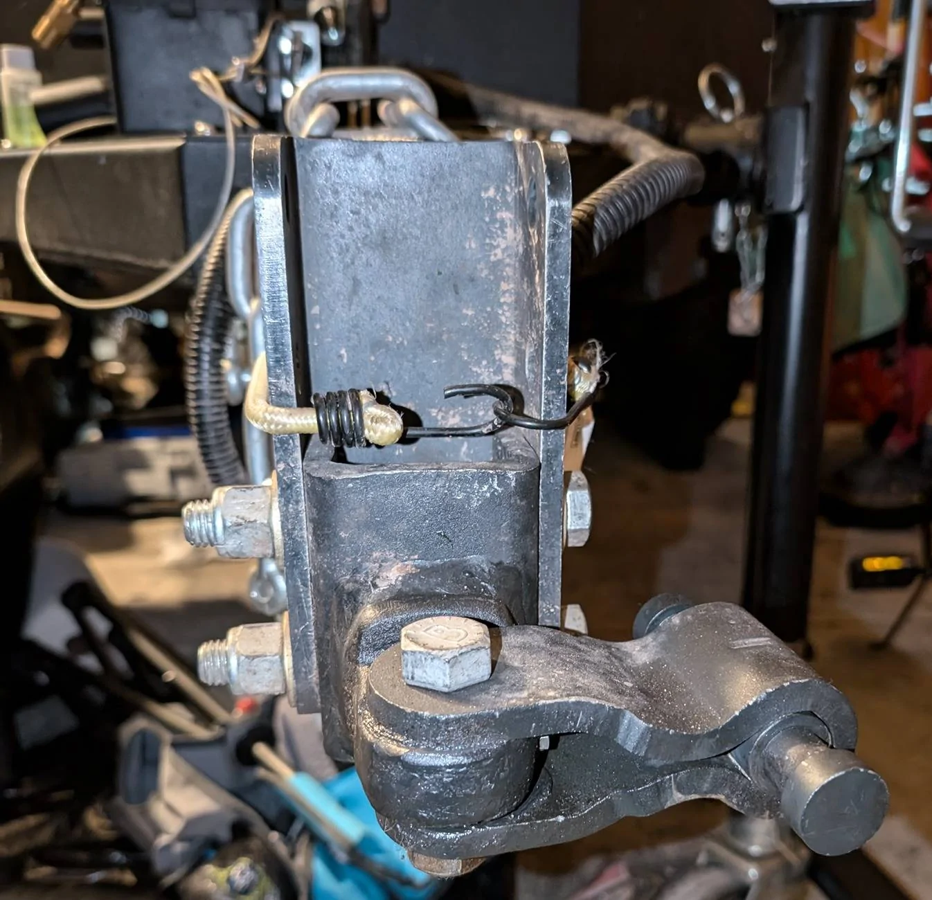

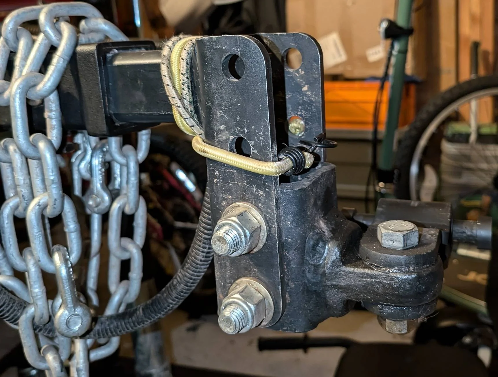

I ended up using the 'lock and roll' solution that I listed here in the thread. The hitch on the jeep part is just a straight tube that slides into the jeep. There's no lift on that end. On the trailer side, I used a drop to get it aligned.
I'm not sure on your boat trailer if you can swap out what gets inserted into the trailer tongue. On mine you could. On my stock rubicon with the 33" tires it fits fine without any rubbing. I can also get the trailer on and off without any issues.
Below are pictures on the trailer side. If you want to wait, I have a trip coming up in a couple of weeks that I can get a picture of it on the jeep.

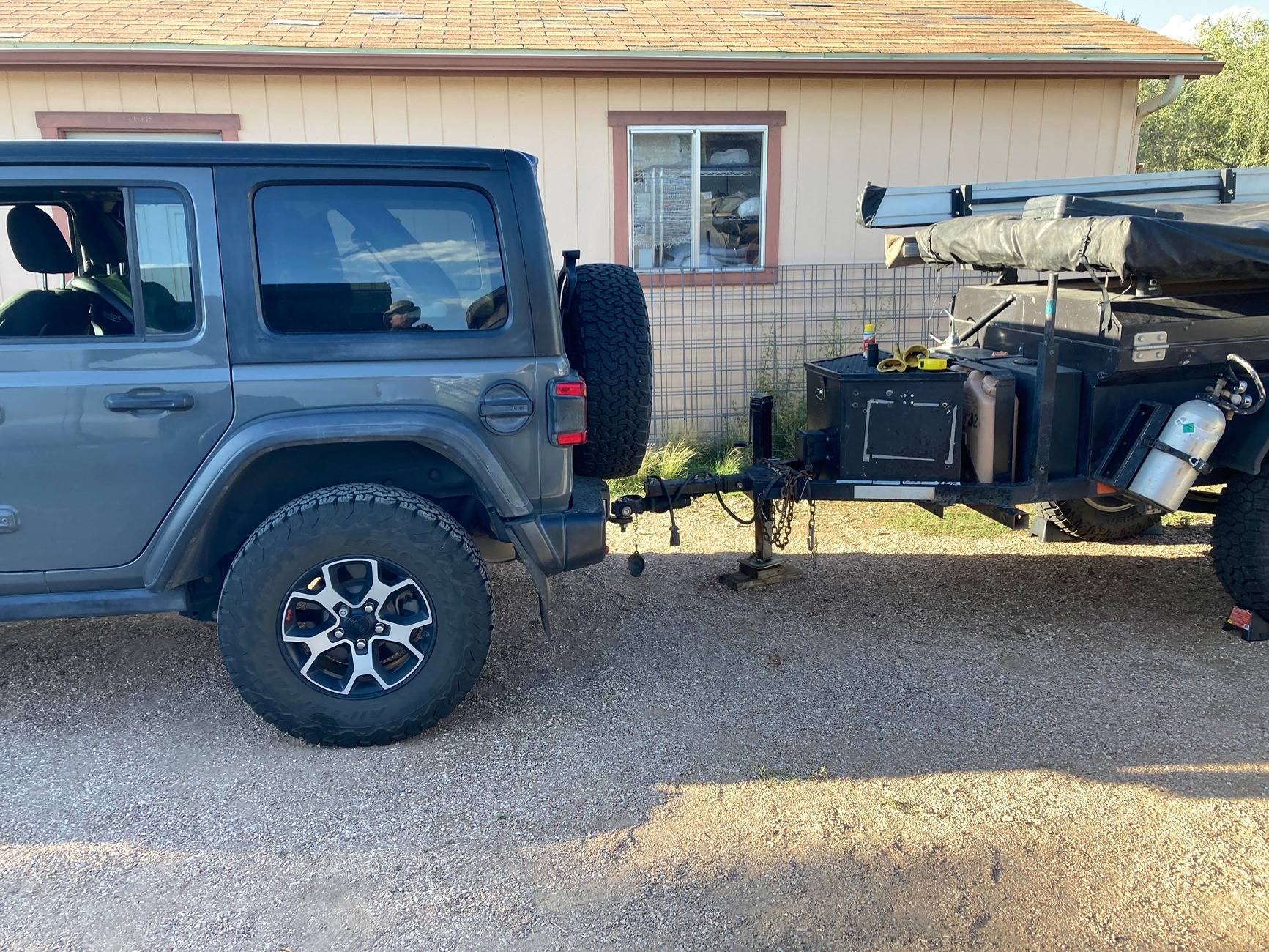

Attached is a picture of what my setup looks like. This past weekend trip was a pretty good test, as it was up and down sand and bumping all over the trail. The roads were just wide enough for one jeep and had numerous large roots across it. My trailer weighs probably about 2k to 3k and I actually got stuck going through soft sand uphill.
No issues with the hitch and it performed flawlessly.

Thanks for the update. Looks like a winning combo!
