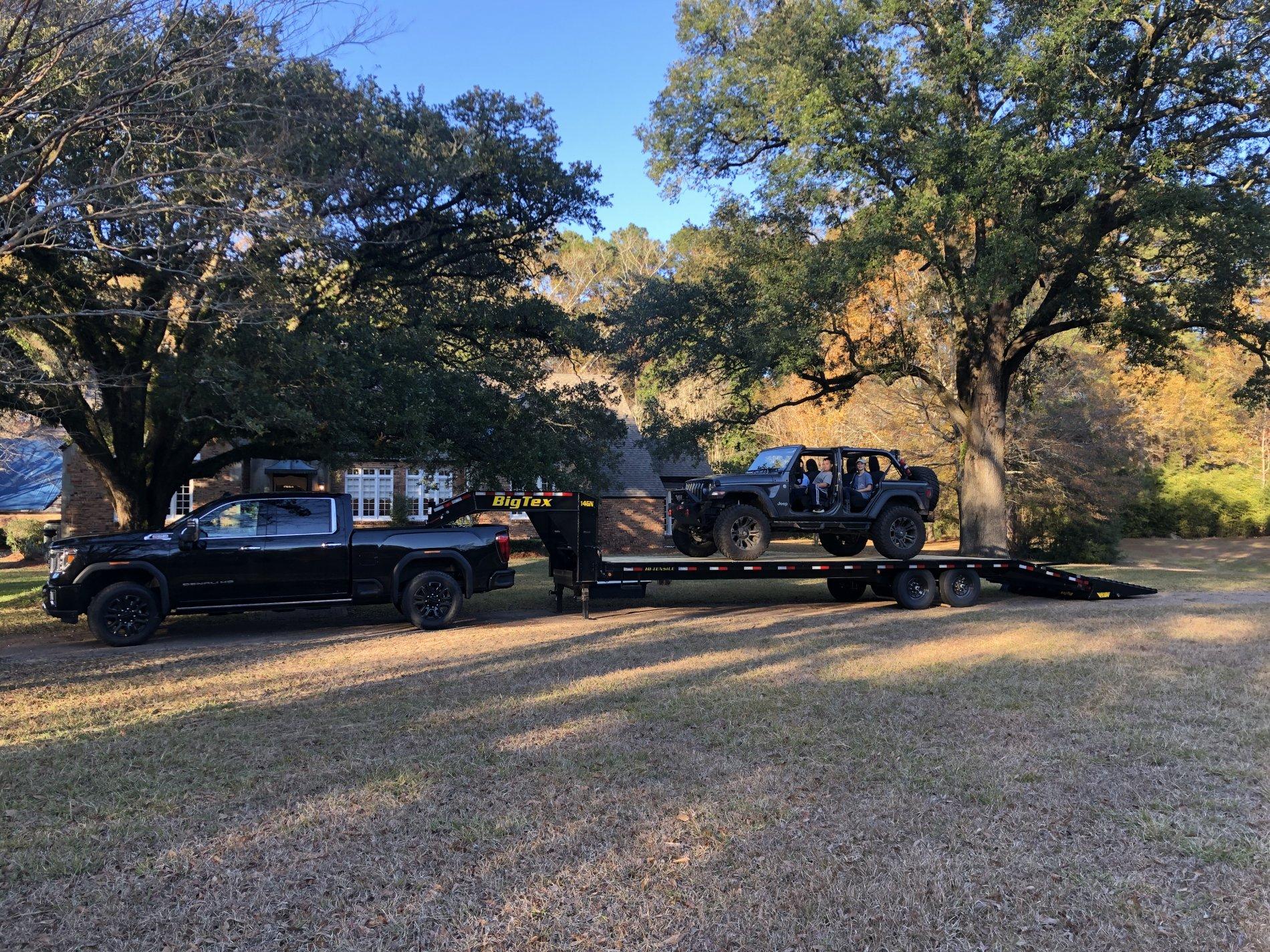

I got a flatbed to haul the Jeep to/from the trail and hopefully to do some serious traveling with the Jeep in the future on some long hauls. Those of you who trailer your Jeep, what straps do you use to secure it to the trailer? I've been researching these car hauler tie down straps and was wondering if y'all have found some to be better than others, etc.

If I were to tow my jeep on a flat bed trailer I would use chains and chain binders over straps, just my opinion based on hauling construction equipment on flatbeds
Agree, safer, faster and might even be required on a flat bed. Used them all the time while hauling tractors on goose neck flat bed

I came across those after I posted. It looks like a lot of people are using the Mac’s axle straps.
They're fantastic, and I use the 40" (42? Don't remember) axle straps with the fleece sleeves for tying my car to the trailer when going to the race track as well.

Chains and binders to the axles. Don't attach to anything above the springs. One chain pulling forward and one pulling to the rear.

Anything made by Kinedyne that suits your requirement. They are simply the transportation industry standard.
