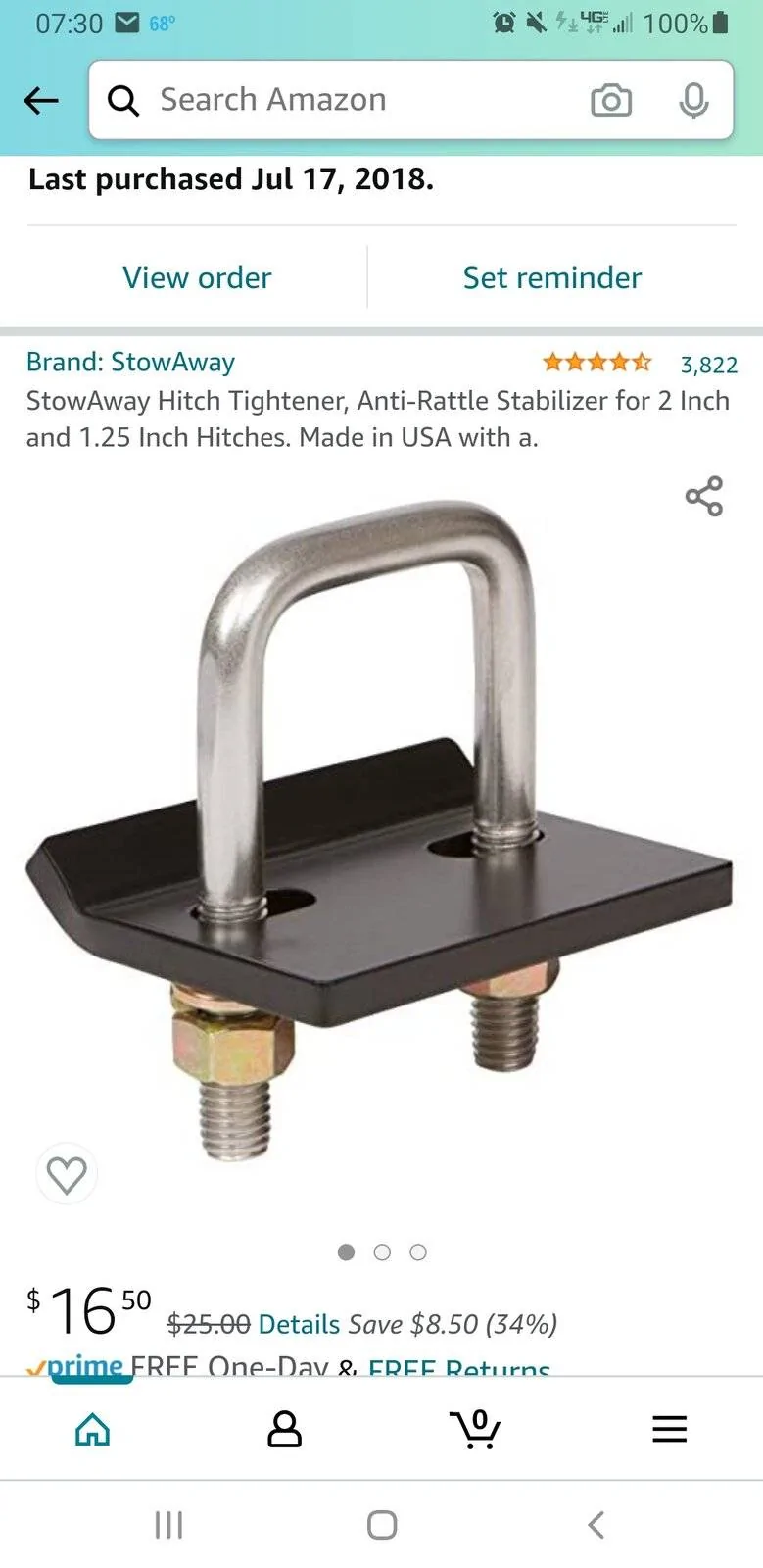

Installed the Mopar receiver, then install and 8" extender. The extended has a bit of play in it. So now when I am driving wit the bikes on the rack the rack sways from side to side. Makes me extremely uncomfortable looking to see my entire bike-rack swaying. Is there anything I can do about the swaying.
This should take care of that problem.
