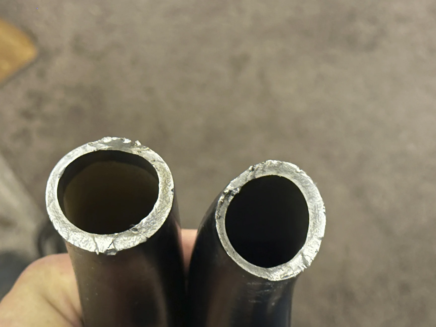

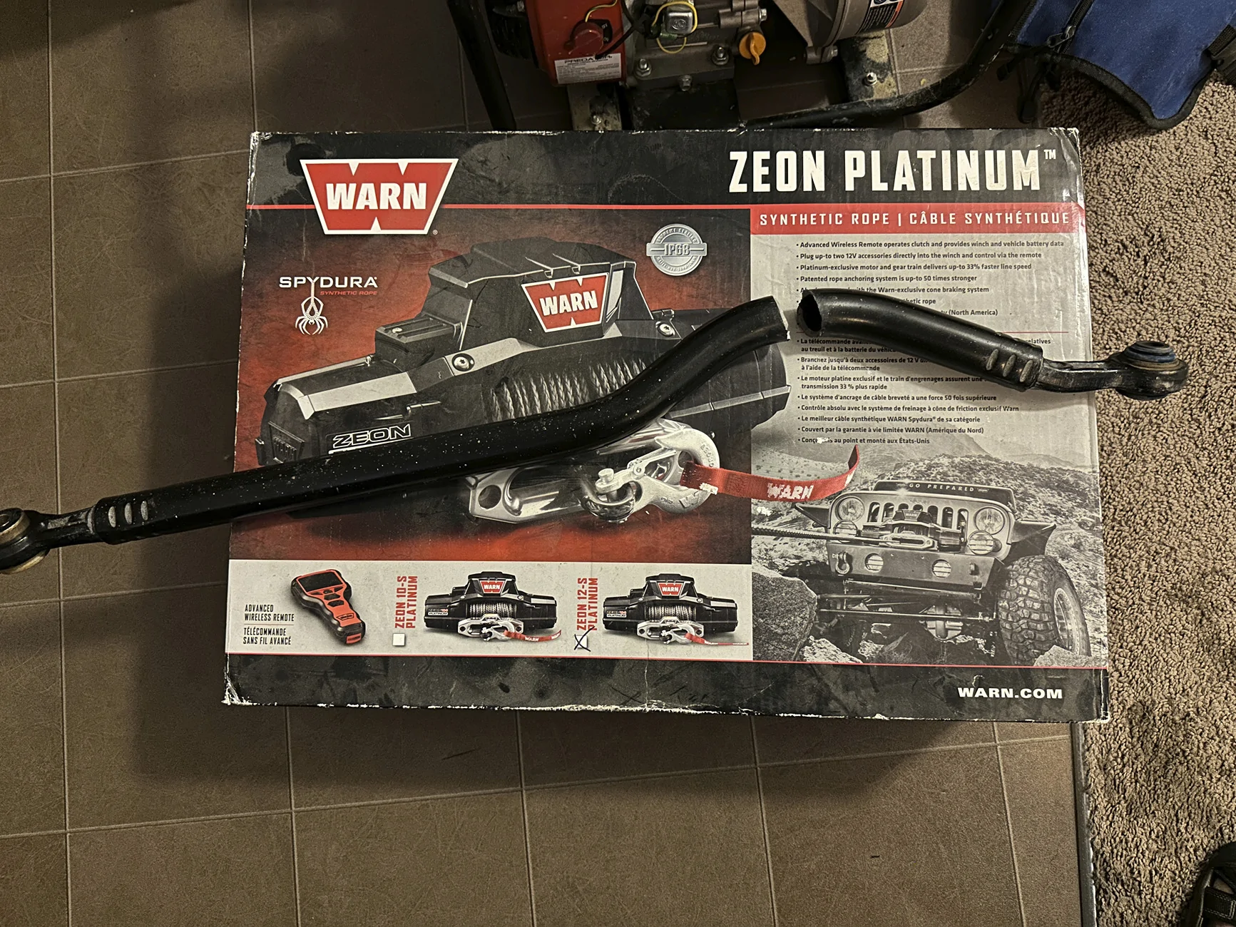

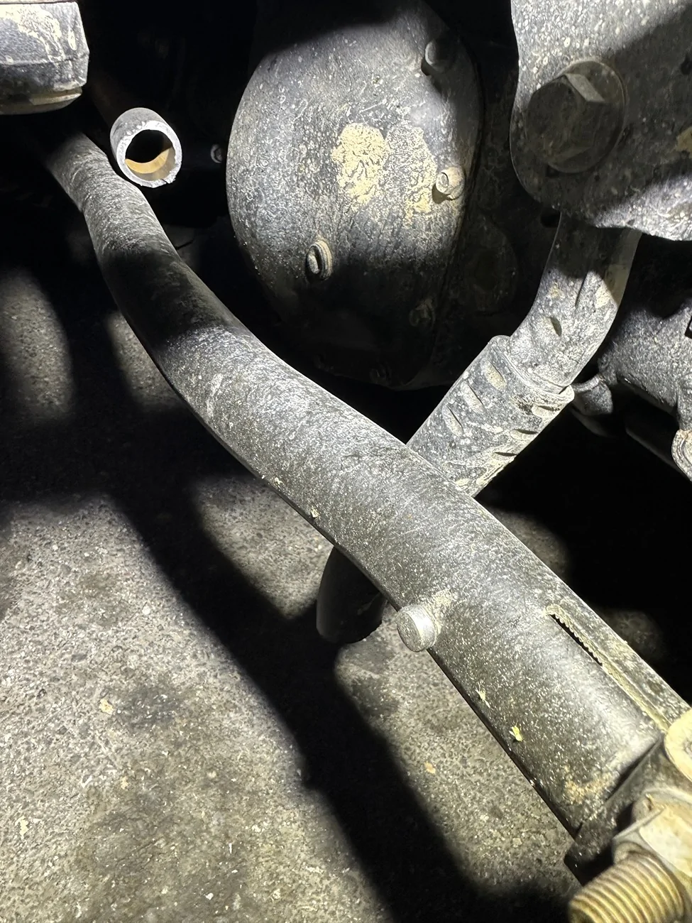

I believe this would be the track bar, correct me if I'm wrong pls. It snapped like a twig during an episode of death wobble at 60mph. Pretty scary the whole rig hopped to the left when it happened.
anyone else have this happen?

Looks like maybe the top part of the break had a weak section possibly. Manufacture defect maybe. First time with death wobble on the jeep? If that failed prior to DW it would definitely cause DW.
The death wobble came first. I dont know for sure but my best guess is the DW fatigued the track bar until it gave out.
