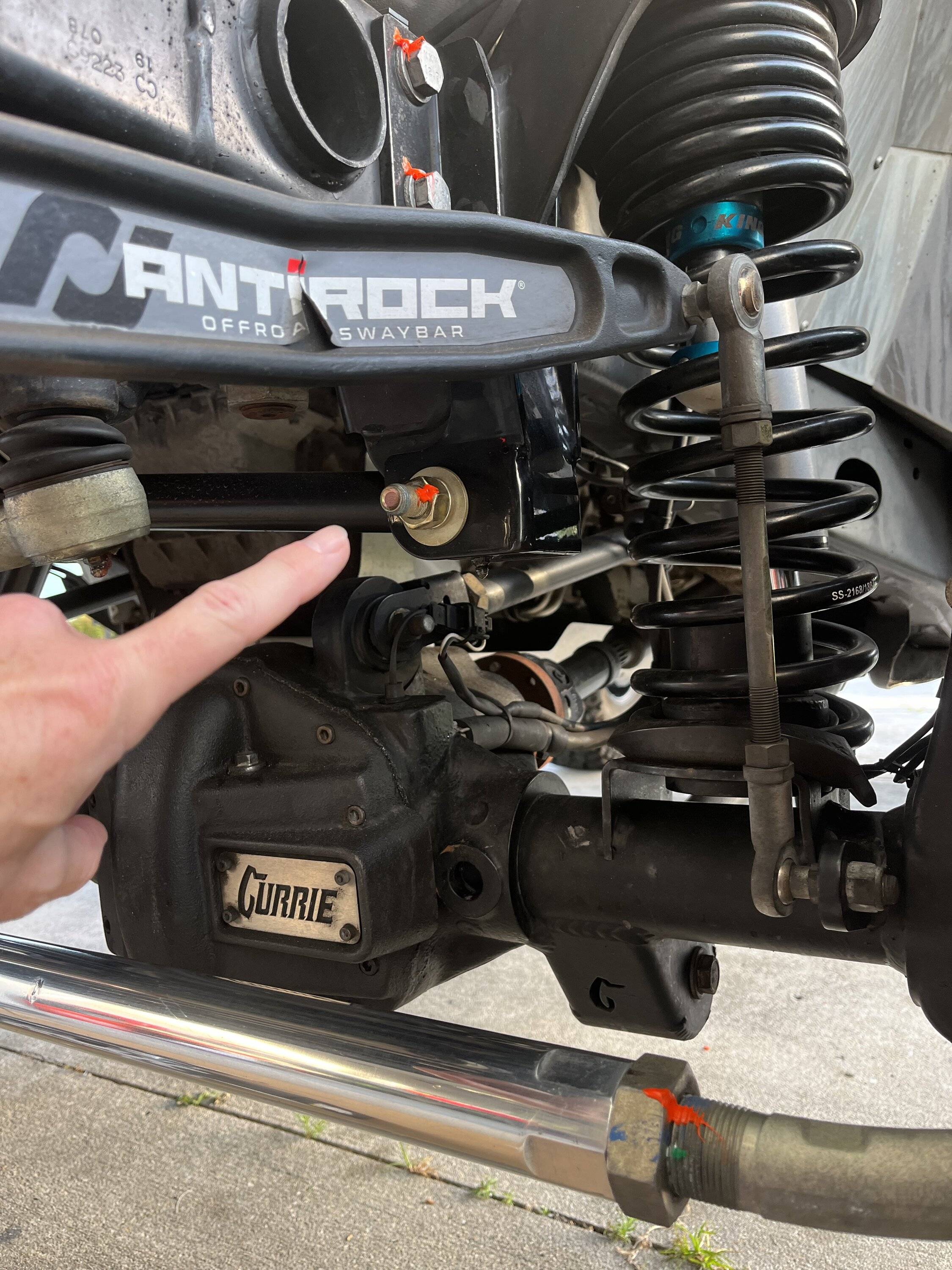

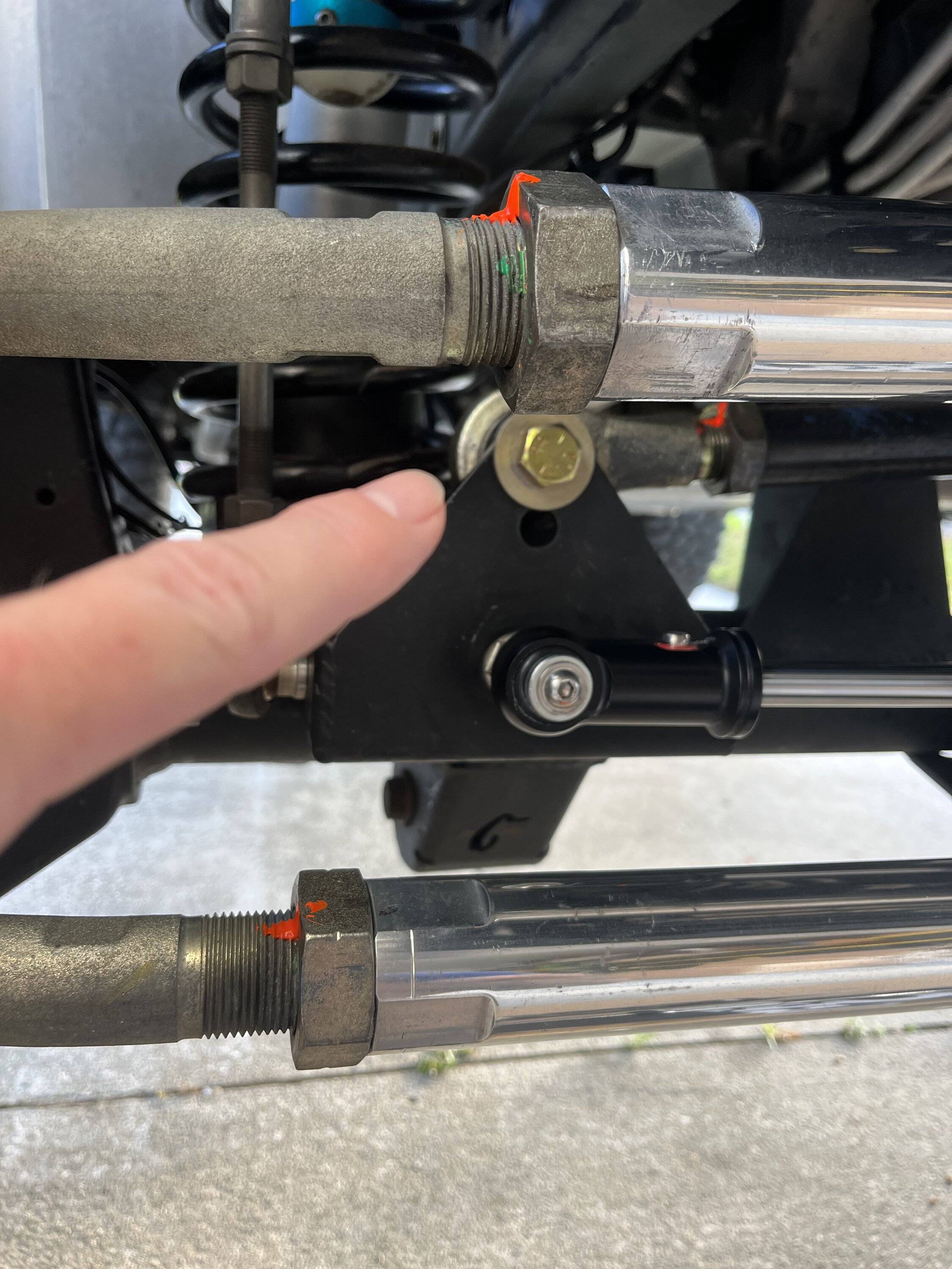

9/16 grade 8 (AceHardware)
Takes slop out of the holes.
-needs to be long enough there’s no thread in the holes.
I read somewhere that all these parts are made for 9/16 but Jeep is using metric so it’s got slop.

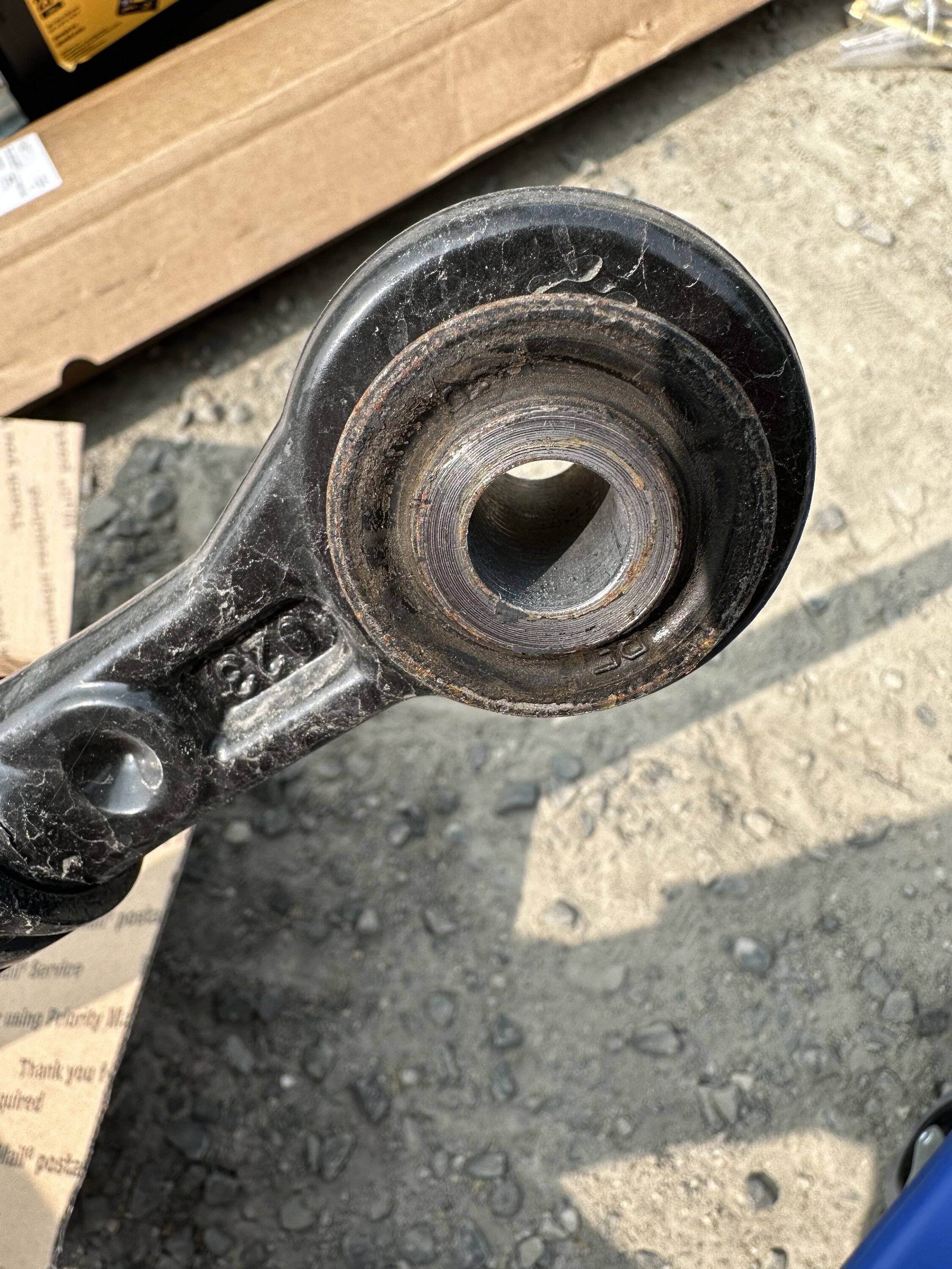

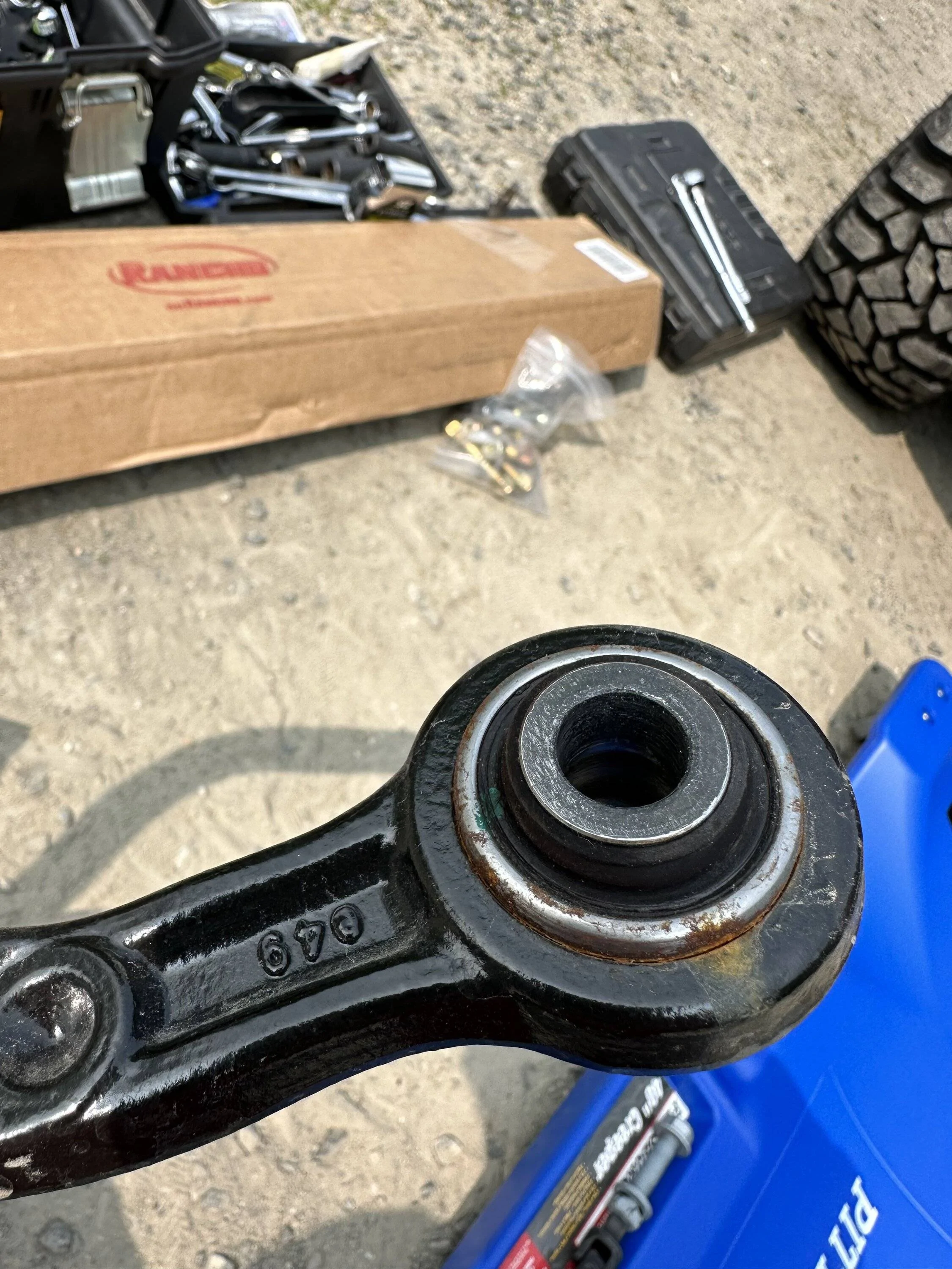

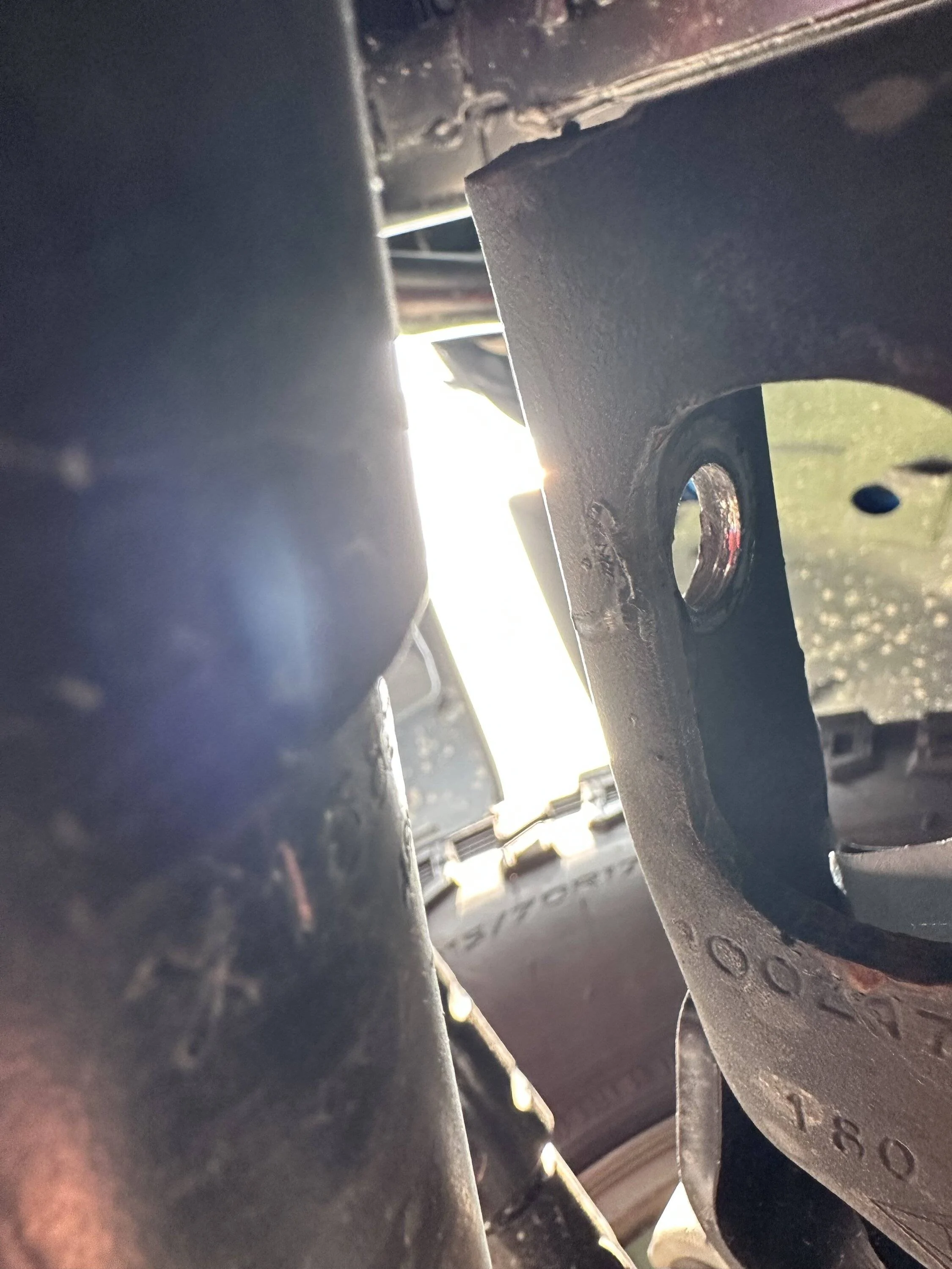

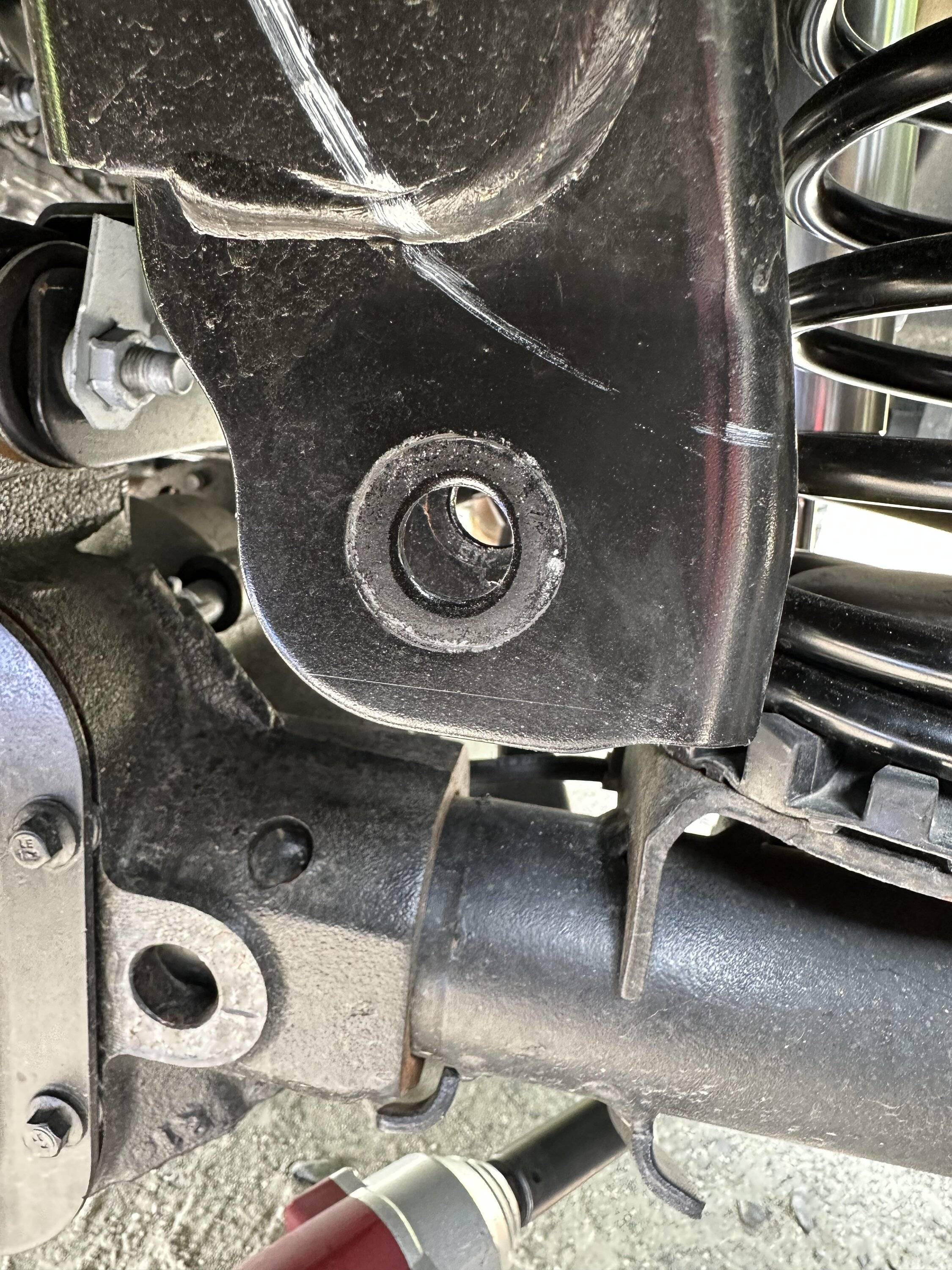

And this is why boys and girls, you change out the oem hardware at the very least.
Brand new Willys.
This wear is after 836 miles. Roughly 450 miles on 35s and maybe 200 miles on the lift. The oem track bar was already getting grooves in the sleeves.
The track bar mounts frame side and axle are starting to deform. And we’re cut into from the smaller threaded oem bolts.
