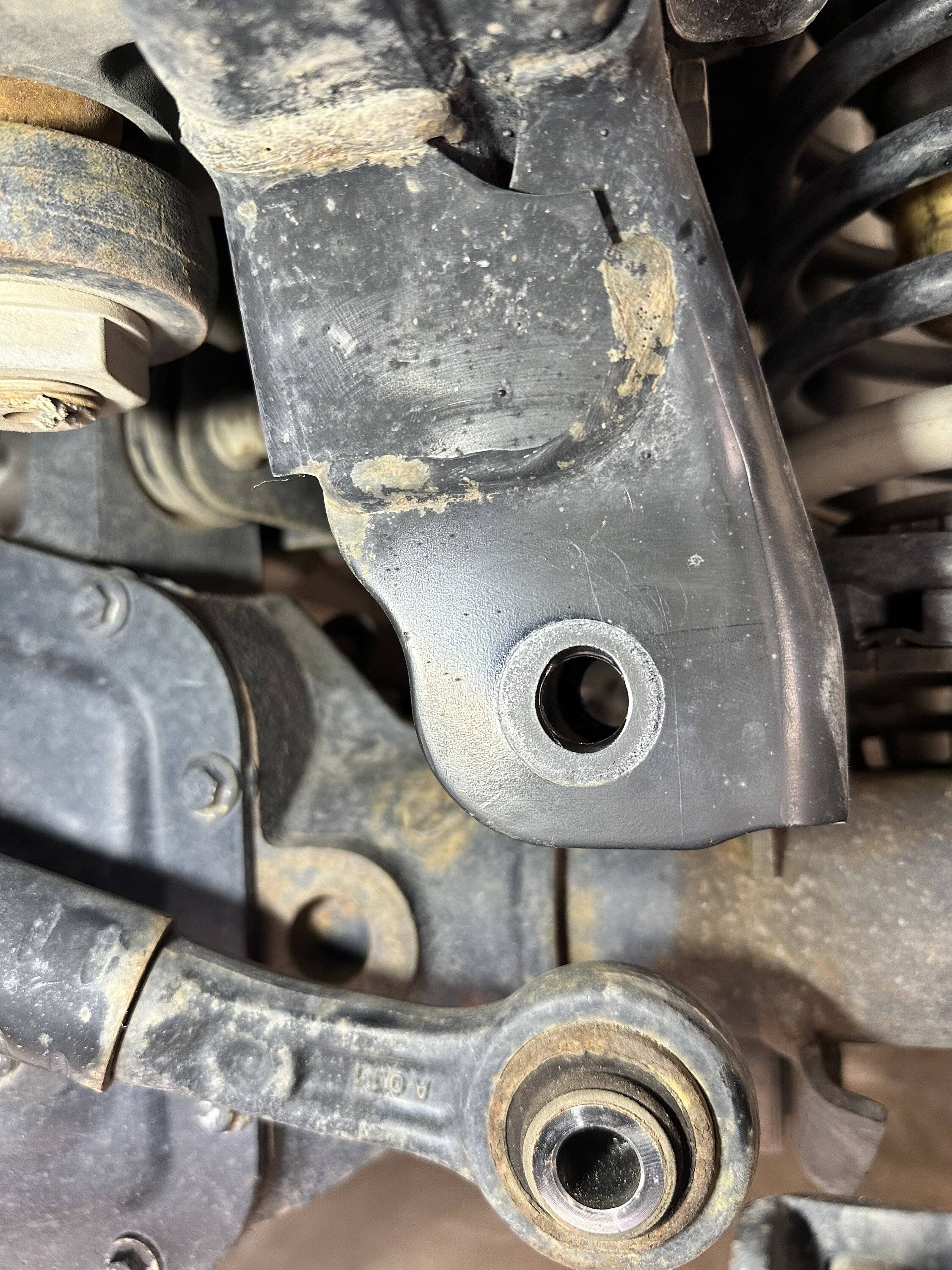

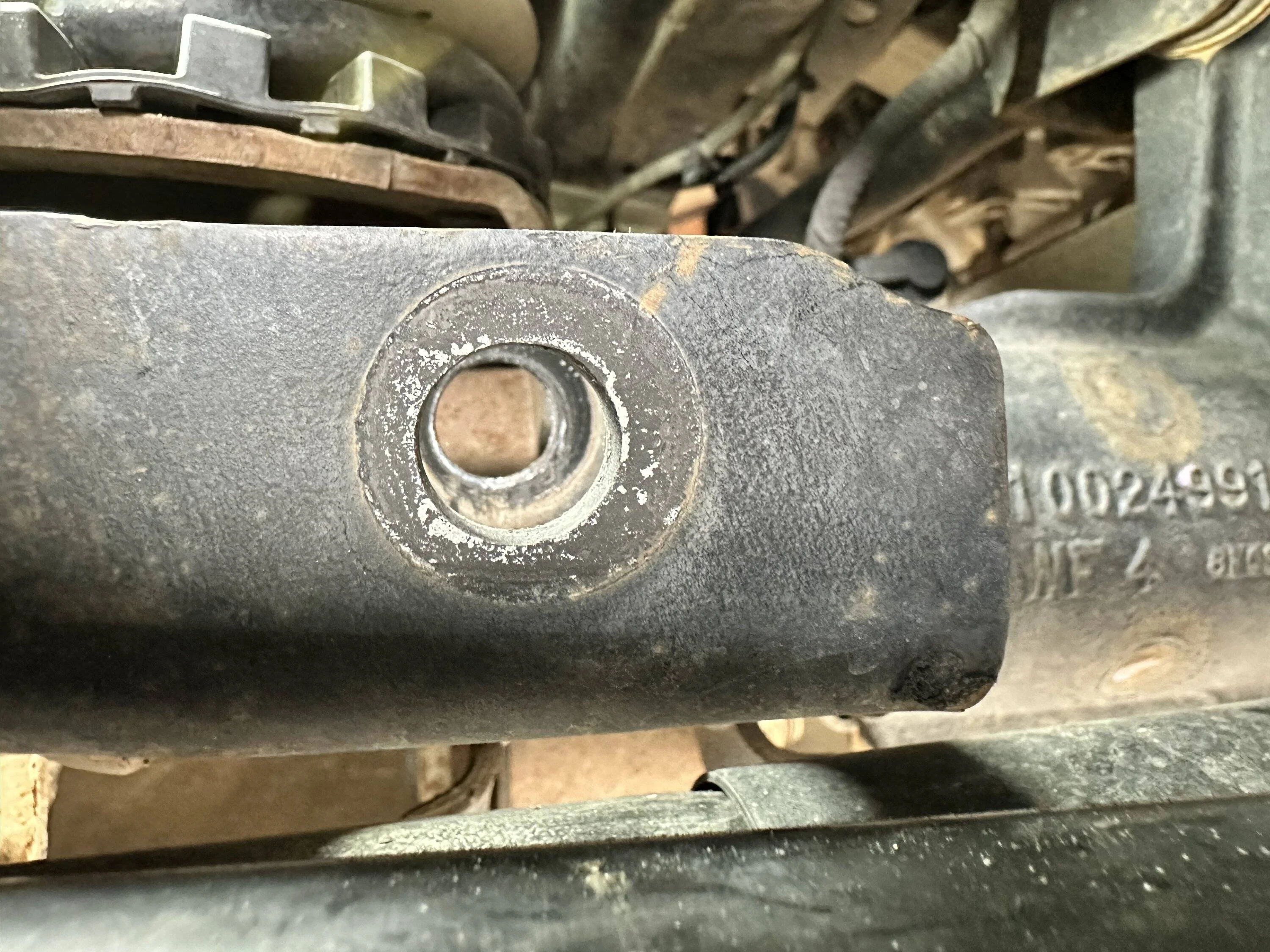

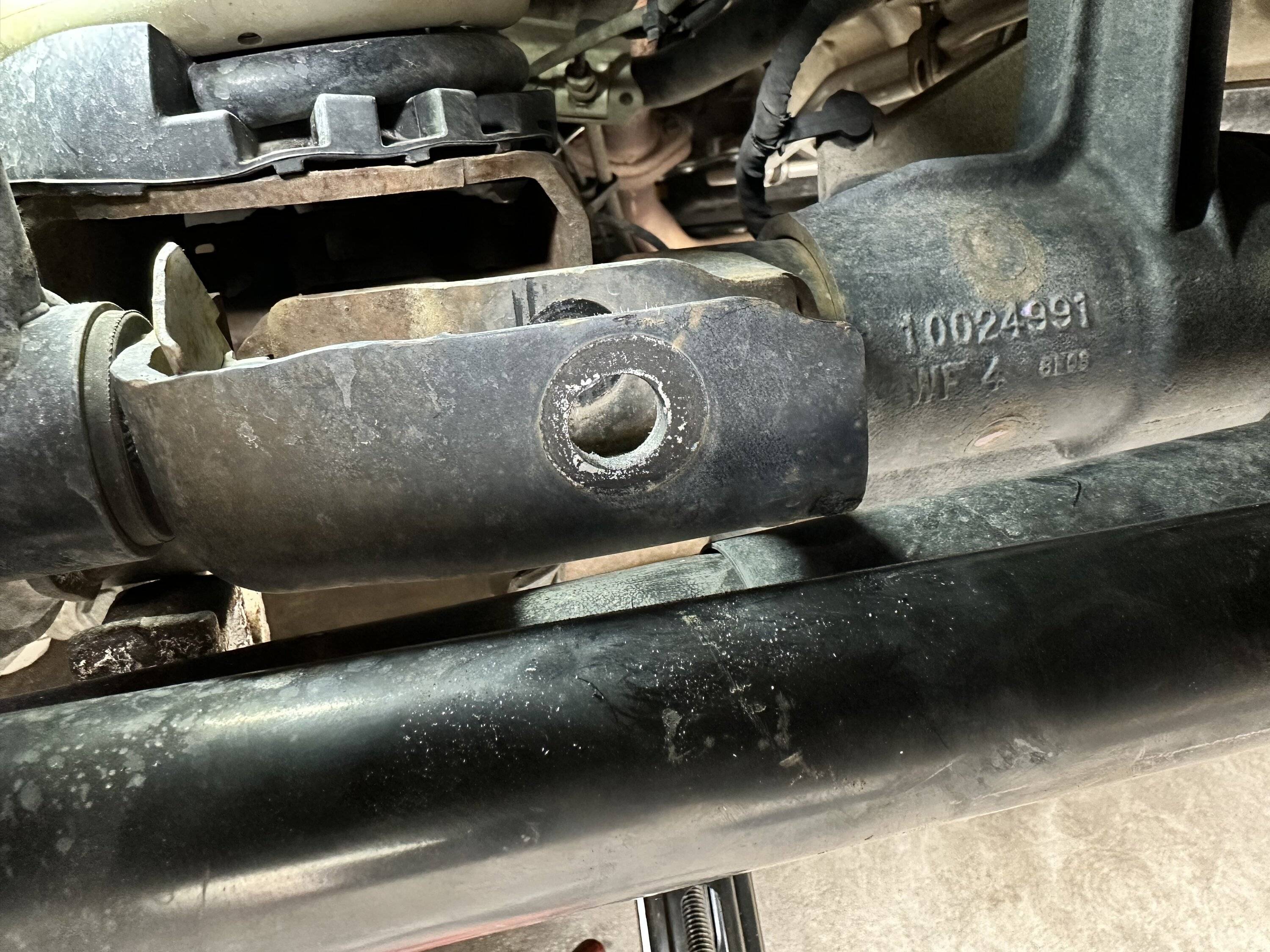

Update: Went through and torqued everything. A few things a bit loose. One thing I did find interesting though was the bolts for the track bar looks to moving around.
Yeah… that’s what happens when they’re left loose for a long period of time. You’ll need new brackets or supplemental brackets now.
