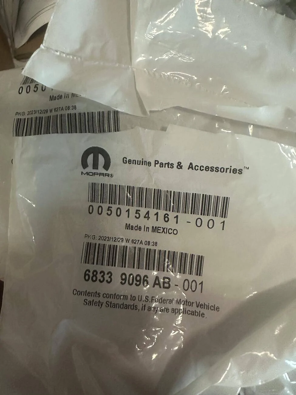

I definitely recommend oem sensors buy once cry once...not bad price through BAM auto or allmoparparts.com
Jeep Wrangler JL TPMS Question tempImagexntrqK

I recommend acquiring them from an authorized Mopar parts outlet and not from a third-party warehouse operation even if they say Mopar on the packaging. They very well were not made in Mexico.
bam auto is a jeep dealership...and allmoparparts is legit...they are a sponsor here and they factory ones are indeed made in Mexico. I have ordered from both places many times for mopar factory parts..
Why do people quote things that they have ZERO clue about. The factory Conti sensors are absolutely made in Mexico along with many other sensors.
