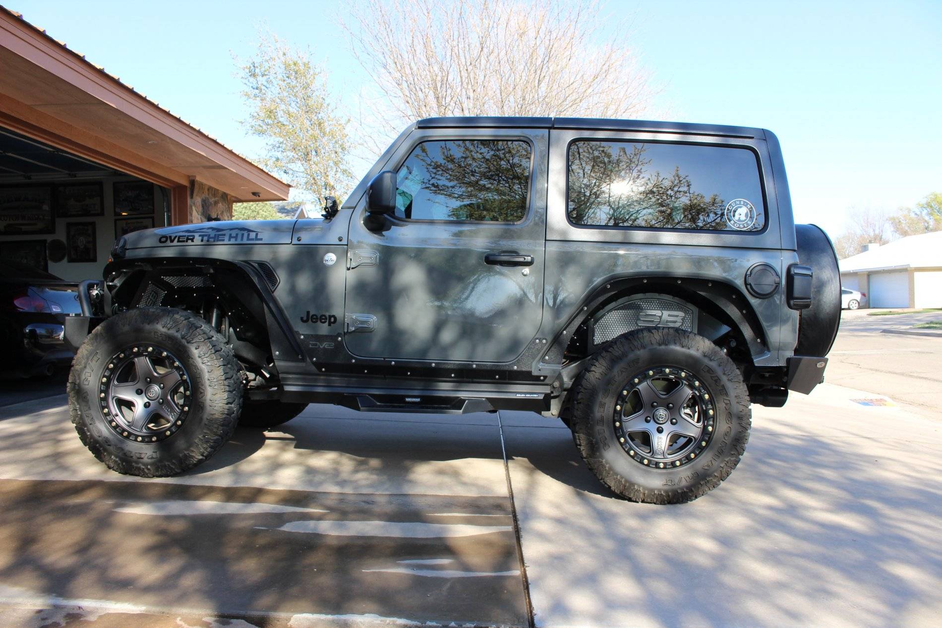

I run the Pats in a 295/70/17 on a 2" Rubicon suspension swap. Fit at the fender is good w/ my 8.5 +10 offset wheels, w/ your 7.5 +44 wheels you'll be in from my set by 1.3", so you may have contact in the inner fender/suspension area at full flex.
Here's the specs of my set vs the same tires on stock wheels
https://www.wheel-size.com/calc/?wh...-17X7.5ET44&fcl=2in&wcl=1.25in&scl=2in&sr=0in
And here's my fit at the fender stock, then w/ new wheels/tires before the Rubi suspension swap, and in it's current state :)
FWIW I wouldn't get Patagonias again, a tire that's ok at most things but not excellent at anything. If they had better tread wear the price point would make it more of a deal, but I'd recommend paying 30% more for a tire that performs much better and lasts twice as long :)

Looks great. How’s the mileage and power been on the 295s?
Any opinion on mastercraft mxt or Cooper evolution mt?

Not too much of a hit, about 2mpg, still get up to 23 mpg running 70 on the hwy. I'm getting a Tazer Lite next week so this should help w/ that. Acceleration is still fine but braking performance probably been affected the most. I will be getting Powerstop Z36 pads for better bite as the stock pads aren't really great at stopping, they are a low dusting high mile pad :(
Mastercraft is Coopers second tier brand, still a quality tire but the Cooper Evolution should be a step up from that, and the Cooper STT Pros are about as good as it gets :)
