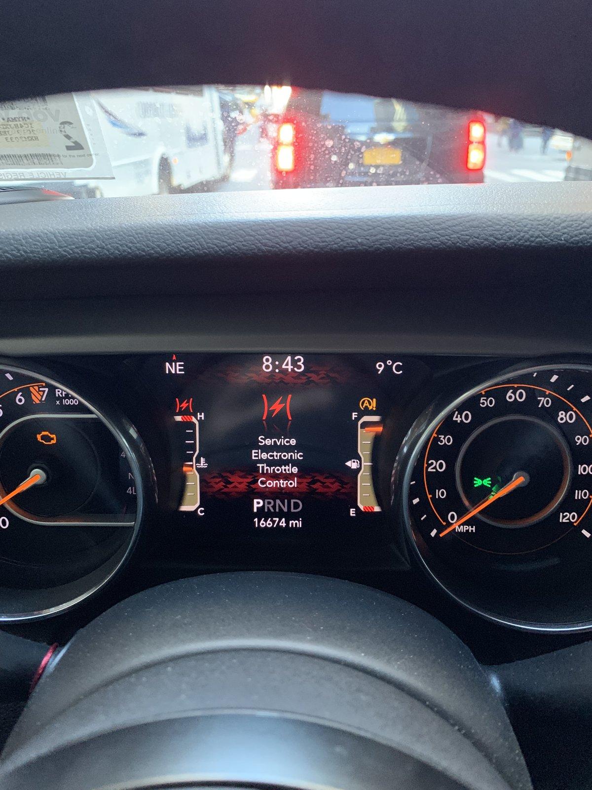

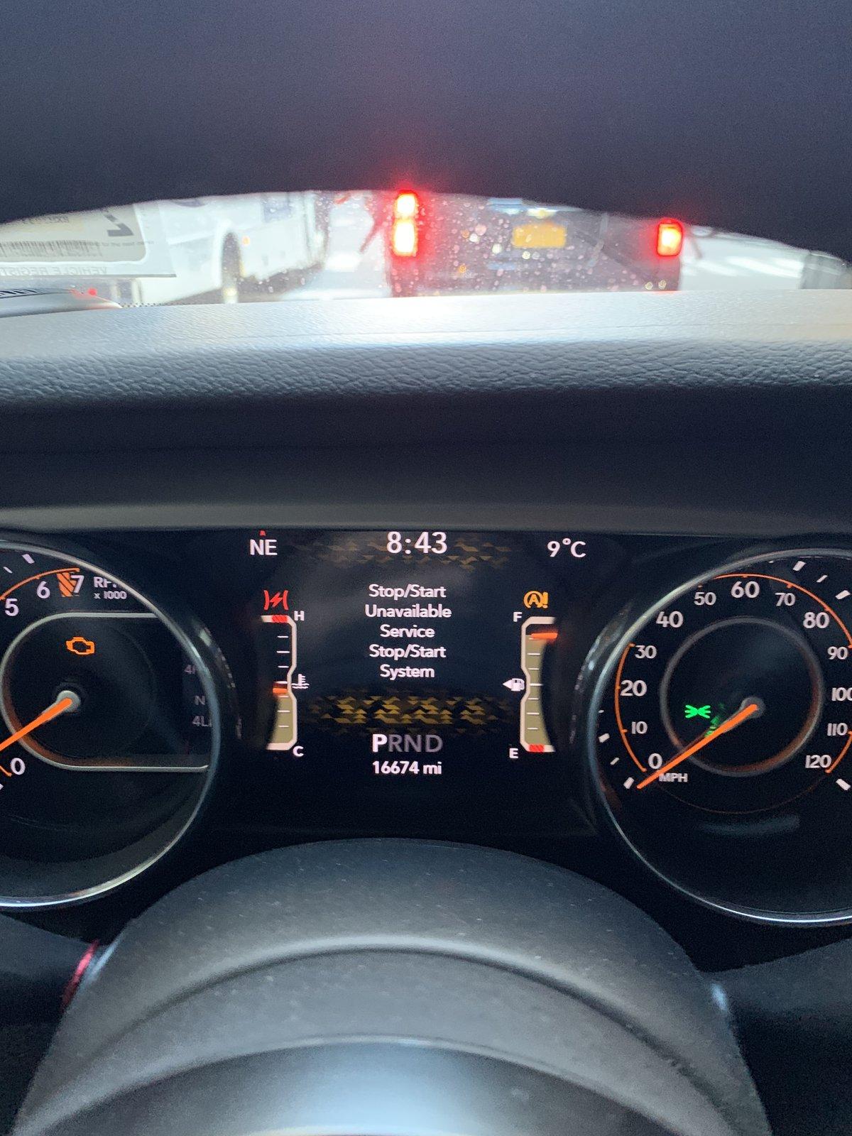

Are these the messages you guys are getting? Taking it in for service Friday.
The message I get is "Start/Stop Not Ready Battery Charging". I can put it on a battery charger and let it charge until the charger say Full and I still have the message. It does start working occasionally for a day or two then stops and gives the battery charging message again.
That first error...not the second. Mine is behaving better. Please let everyone know what the dealer finds out - I am going to give my dealer a list of things I've checked when I turn my truck in. Otherwise, it might take too much time.
