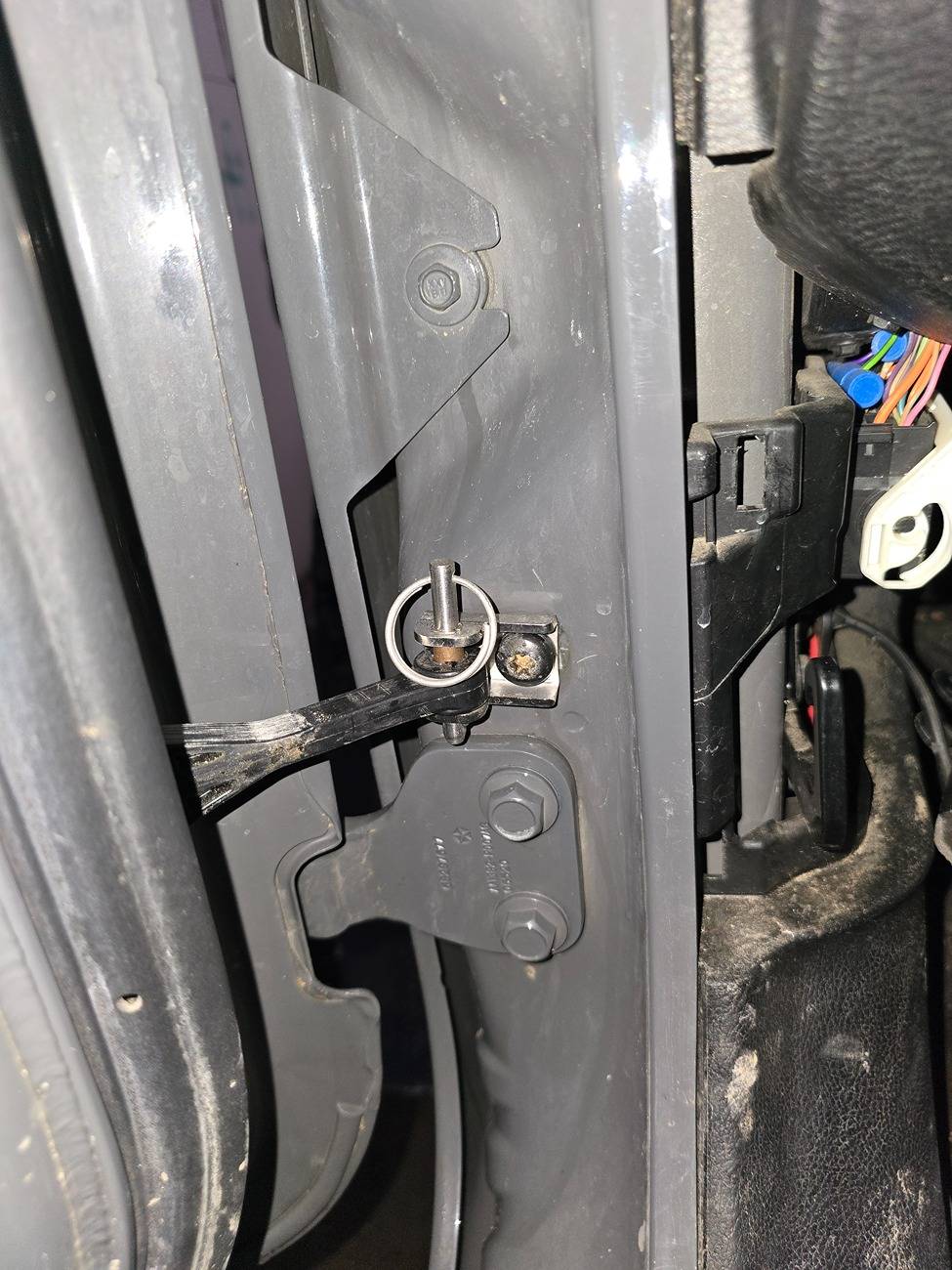

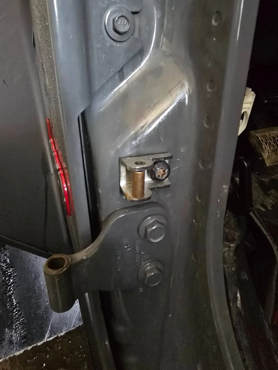

@TrailBuilt offered some brackets for tool free door removal.
I received the brackets and I have installed them and I find them to be a great mod so far!

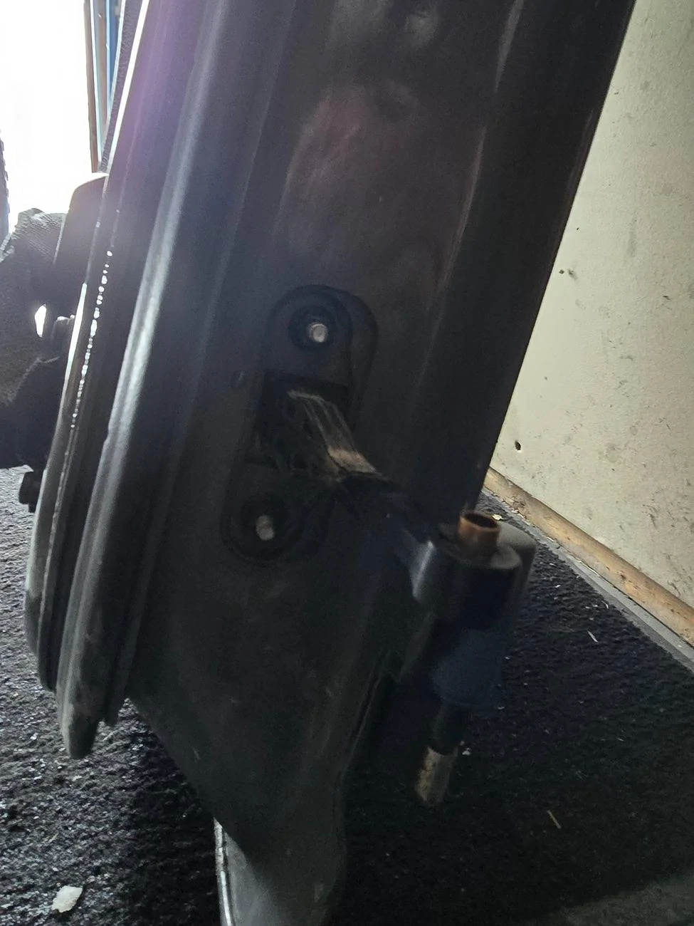

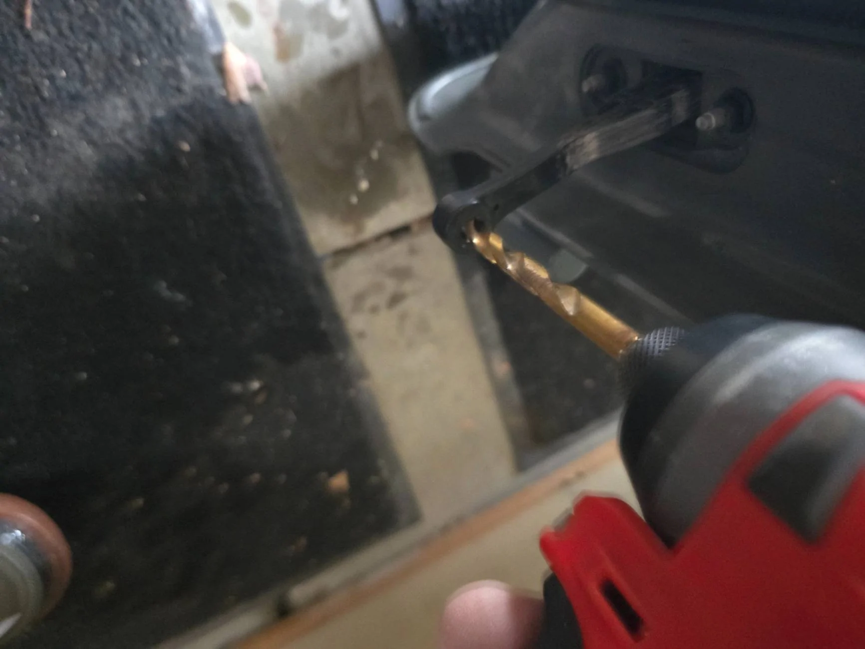

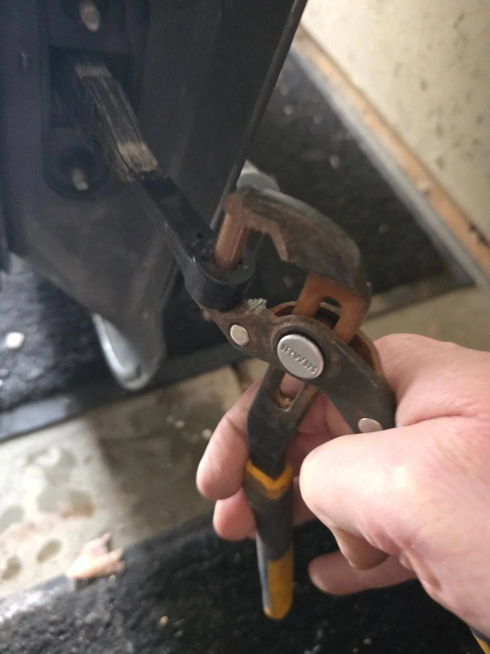

When I first installed them, there was a little bit more play in the bracket than original.
I found a 1/4-5/16 bushing at tractor supply company. I drilled out the arm to 5/16 and pressed in the bushing, and this has removed any of the play from the arm.
Aside from that, I love that my doors are now tool free for removal and still have all of the factory function.
Thanks @TrailBuilt great thinking
