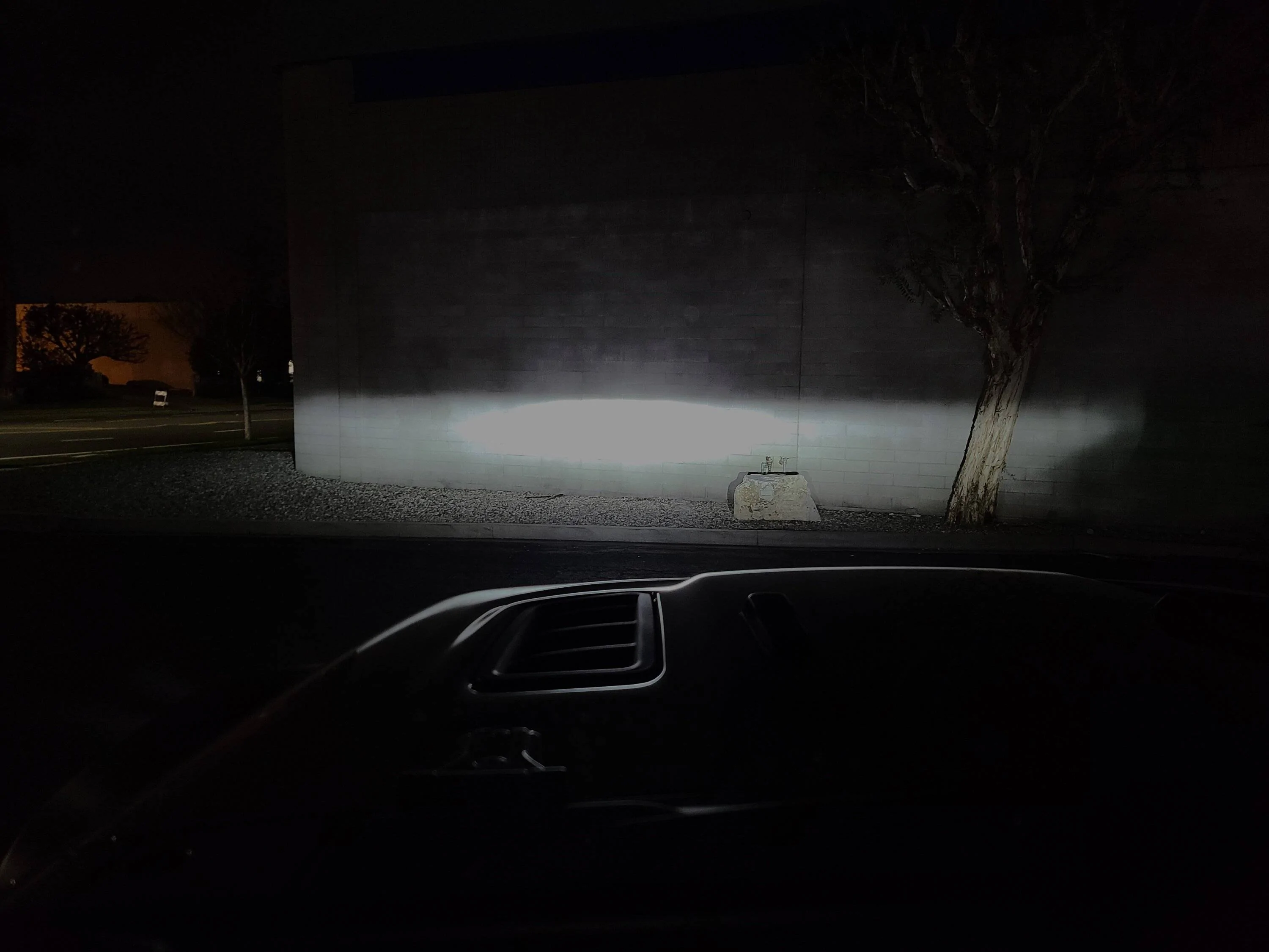

Here's my SV4 LED bulbs in my halogen fixtures. Impressively controlled beam and incredible illumination, without pissing off everyone else too.
Jeep Wrangler JL (Too) Bright Headlights sv4 on wall
Jeep Wrangler JL (Too) Bright Headlights 20210211_184510

Can you please give me some details how you adjusted your lights? About how far away from the wall are you and roughly what is the distance from the ground to the light shining on the wall where you adjusted it to? I know we don't have the same set up, but this would give me a reference.
You have that dialed in very nice. About how far away from the wall are you when you made those adjustments?

John, the way that has worked for me is to find a multi-level parking garage at a mall or hospital or such, then find a wall within the garage, park with the headlights about 25 ft from the wall, measure up to the center of my headlights and measure on the wall to the cutoff line of the light beam. I generally use 1/4" downward adjustment per foot from the wall. So 25 ft from the wall comes to 5" down. Start there. That should work. If you are getting flashed after that, consider going down another inch or so. I tend to be more conservative and adjust down a bit more, because I have a lift and big tires resulting in a very high jeep.
Also consider your payload at the time you were flashed. Consider your average payload when adjusting the lights as well. In my pickup, I will bring along the tool to adjust the headlights for trips where I put a lot of weight in the bed. The adjustment is significant. Same with the jeep.

Perfect, thank you very much!

For my 2 centavos, I find the optics of the JL halogen reflectors to be outstanding. But, the output really is well behind the times. Equipped with the SV4 bulbs for almost 3 years now, my halogen fixtures have been outstanding and I'd put them up against the factory LED fixtures for both beam pattern control and output.

Just watch that the parking garage pavement is not rising as it gets close to the wall, as that will throw off you measurements, as will an irregular floor of the garage that causes the vehicle to set with the lights slightly up or down.

You want the top of the light beam to be below 3 feet at a 25 foot distance.
This is the easiest way I have seen it done: https://www.[Banned Site]/threads/tech-tip-jeep-jk-wrangler-headlight-adjustment.4213/
