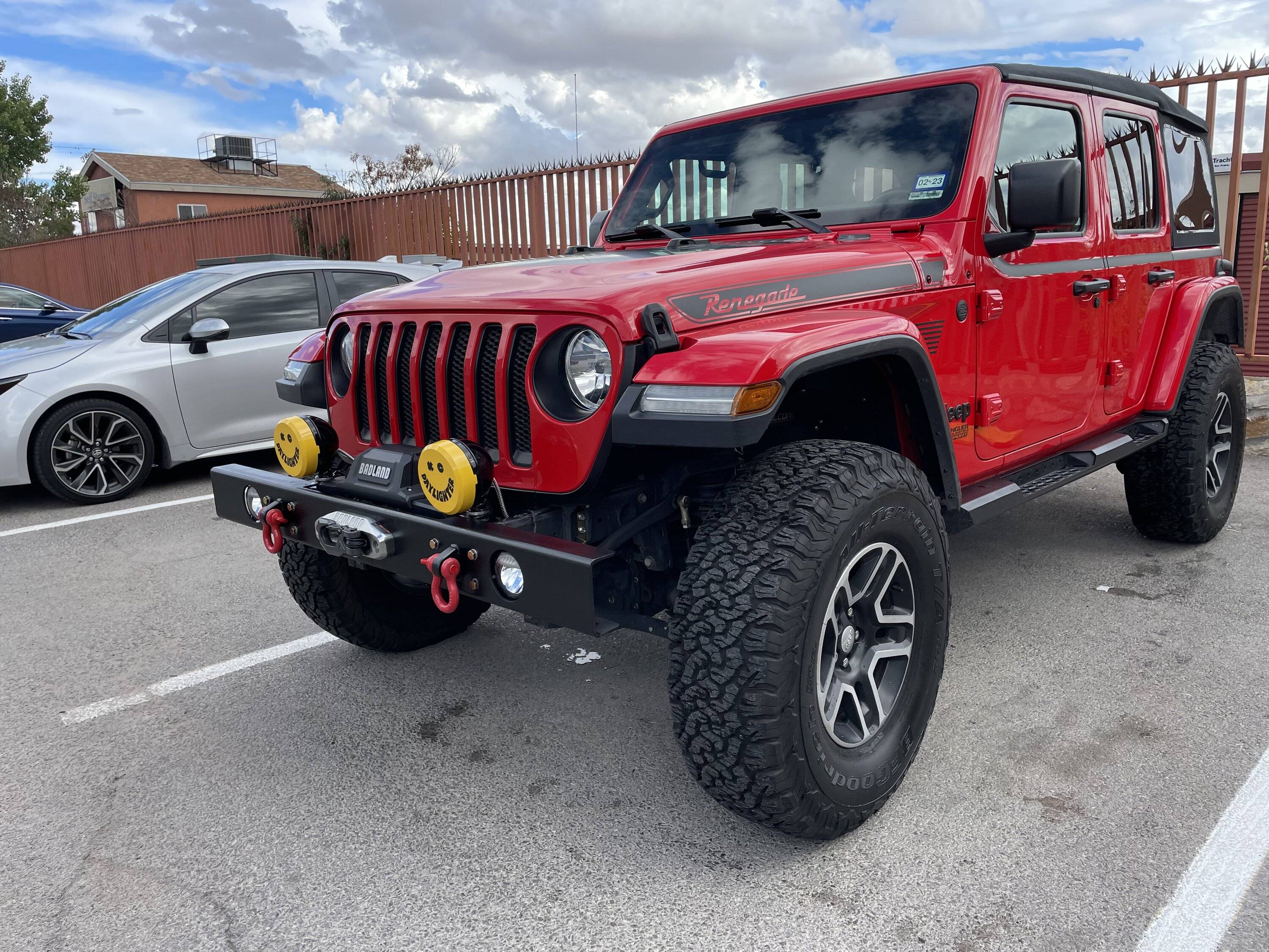

A fellow forum member, @Gregj, fabricated his own bumpers with an identical aesthetic. I'd certainly buy one if it ever went into production.
The aftermarket seems to be stuck on variations of a single front bumper design for the JL, so you may have to DIY a similar solution.
As for the rear bumper, this one deserves a little credit for its attempt at the old school look.
Jeep Wrangler JL TJ Bumper Gregj DIY front bumper

Gregj
Yours actually looks 100x better than the standard TJ front bumper. If they would have used yours it would have been much better designed with hooks and lights.
Gregj
Greg
Dec 15, 2018
2,762
5,668
West Texas
Thanks, I wanted to keep the modern lights and recovery points with old school aesthetic. I didn’t use channel iron as it has a sharp corner, the CJ bumpers have a rounded edge. I started with 6x6 square tube. I used 1/4 wall but I think *if* I ever did it again I would use 3/16. Drilling all those holes in thick metal sucks! And it would be a bit lighter, ?.
I was just getting ready to tag him here if someone hadn't already. I like the take he had on the rear bumper as well.

What Gregj fabbed up is awesome. Appreciate him sharing details for how he did it too, over the summer I messaged him to ask.
My metalwork skills are non-existent, seems like the aftermarket is missing an opportunity, not everyone wants faceted bumpers. I’ve seen similar simple bumpers, but those always seem to be stubby where I’m looking for full width.
When time allows I may give this a shot, otherwise fourth in line lol.
