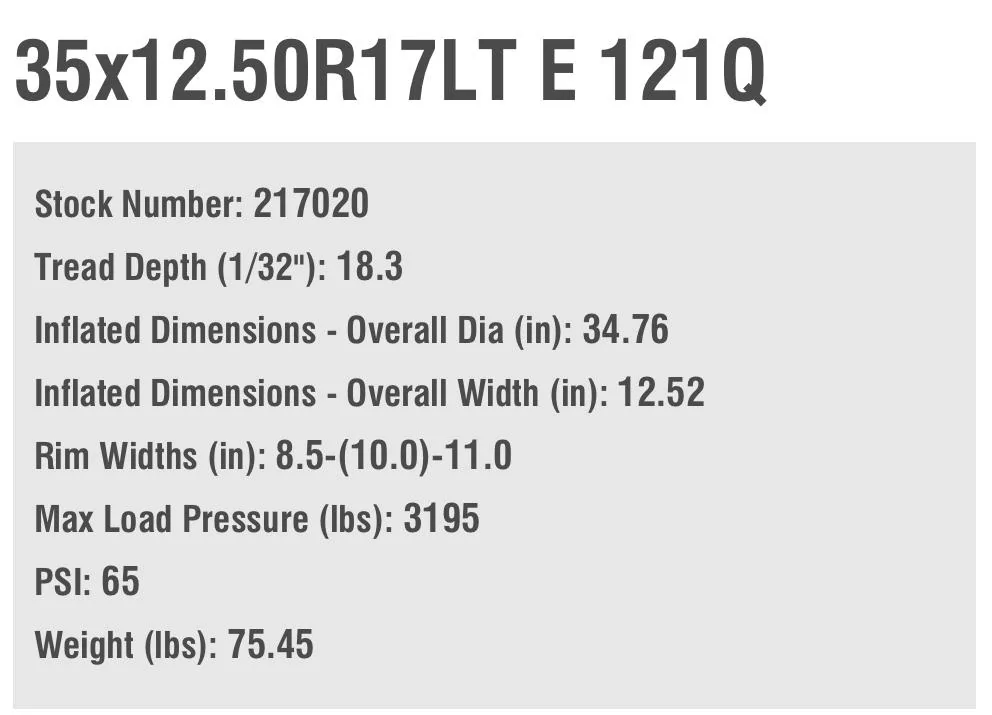

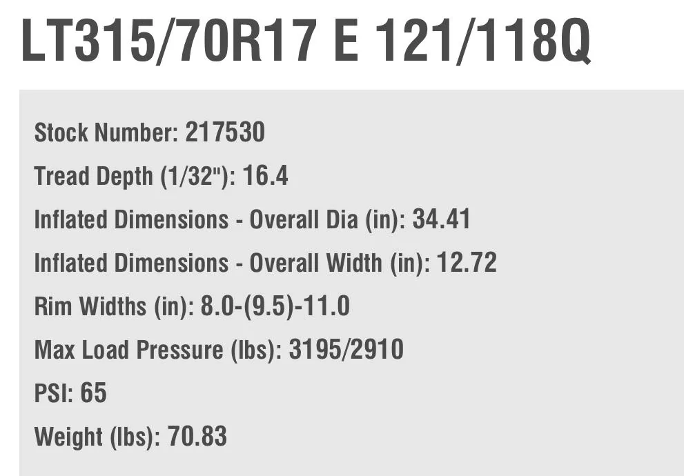

I bought myself the 8"x17 Mopar Beadlock capable wheels. I am definitely going with Nitto Ridge Grapplers. I am going back and forth with what size to get.
315/70/17 or 35x12.5/R17. Both are E rated, very slight difference in size. Probably not even noticeable. Very similar specs.
I originally wanted the 35x12 but it says the wheel should be 8.5"-11" and my wheel is 8".
The 315/70/17 says wheel should be 8"-11" and it is also 5 lbs lighter than the 35x12 which would help a little anyway.
Which would you go with?

What’s the price difference? Either will be fine as the tire width difference is in actuality probably .3 of an inch.
Usually 315s are slightly less wide but the nitto specs show the 315 as wider than the 12.5 which is strange.
Like you say the 315s are lighter but either will do.

Yeah I thought it was strange that it was wider than the 35. Tread depth is a little less which lead to the weight reduction. Not sure about price difference yet though.
