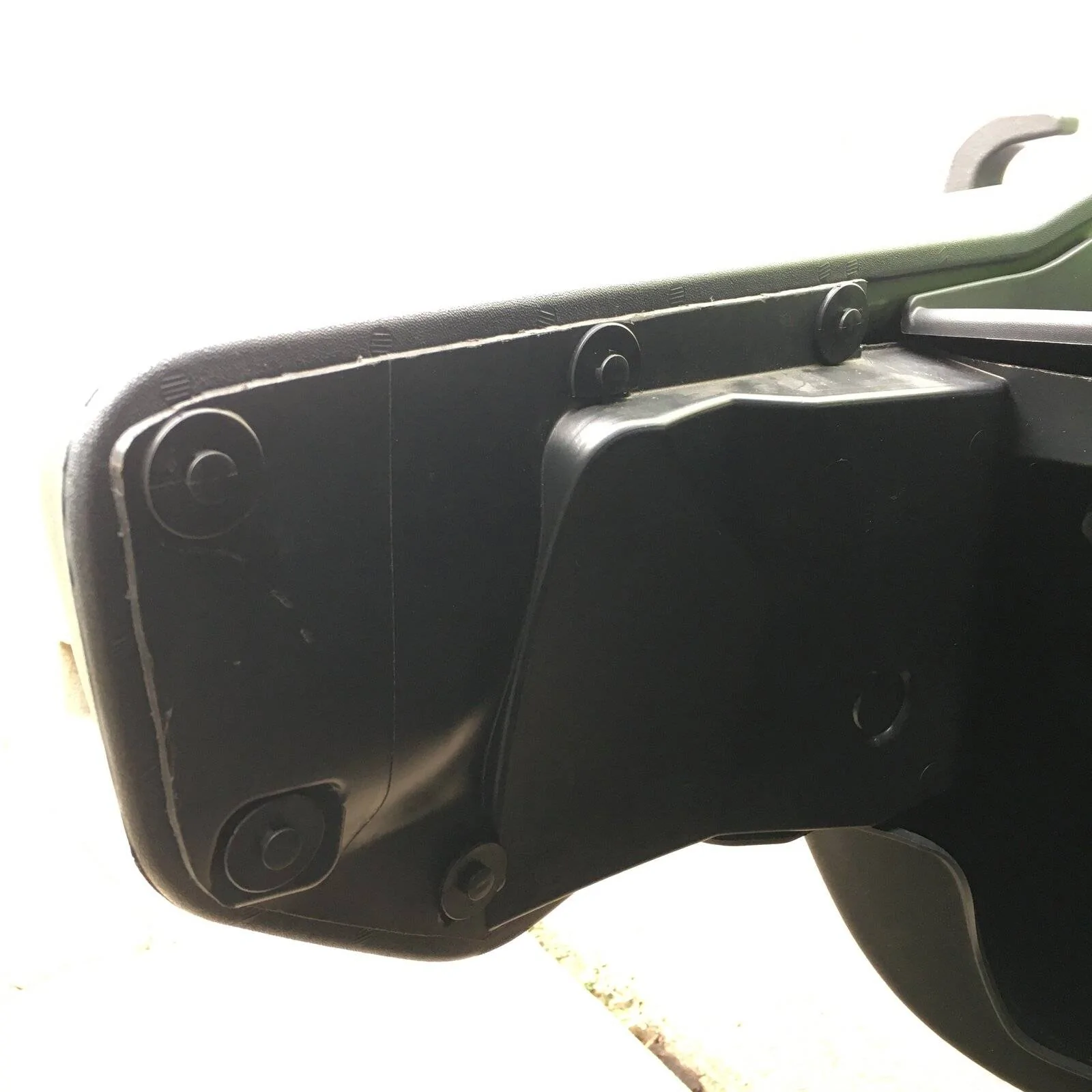

You can ride with the covers off - the Rubicon steel bumper has the wiring exposed near the fog lights. I drove for several months like that on my own, before deciding to trim the fairings and reattach them. I used trim panel push pins, since I removed all the nutserts that were in the bumper.

appreciated, I couldn't think of how to modify them for reuse as cover and get them back on...I needed a plan until I can afford a nice bumper winch setup, that rocks....did you need to remove the bumper to get those dammmm nutserts out?

Sure thing! No need to remove the bumper - just a pair of needlenose pliers or a flathead screwdriver to pry them out. It was relatively painless. I cut those covers with a Dremel, but I've also read on here that some members have used a fresh blade on a utility knife and had good success with that. Good luck and keep us posted!
