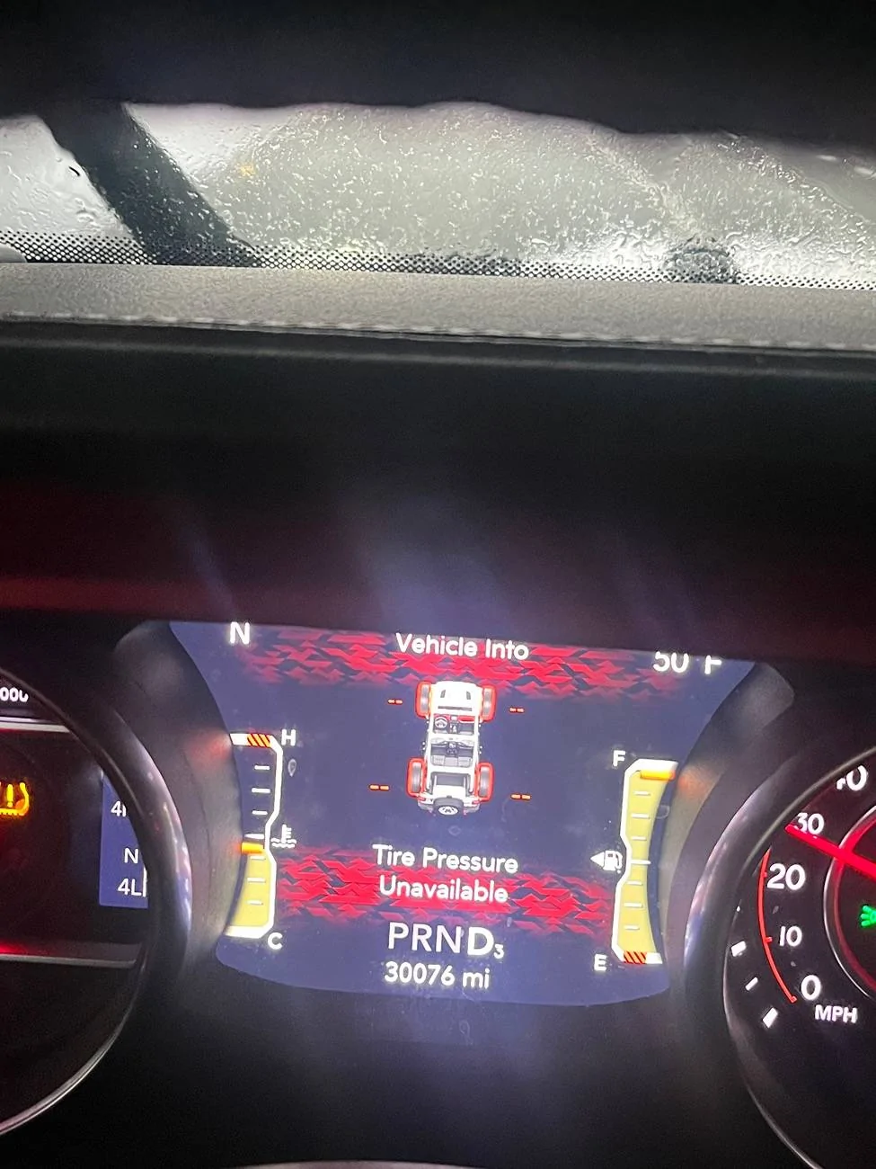

Replaced rear tpms sensor and now this ???

you should check the codes man. you can even get a wireless scanner to verify all 4 sensors are reading properly. your spare might not even have a tire sensor
The spare has a sensor
Yeah I guess
You have to program them.
Oh my bad
I guess I would need an expensive scanner ?

Them ?
I replaced the rear tpms receiver
The sensors do not need programming on an early ‘21
