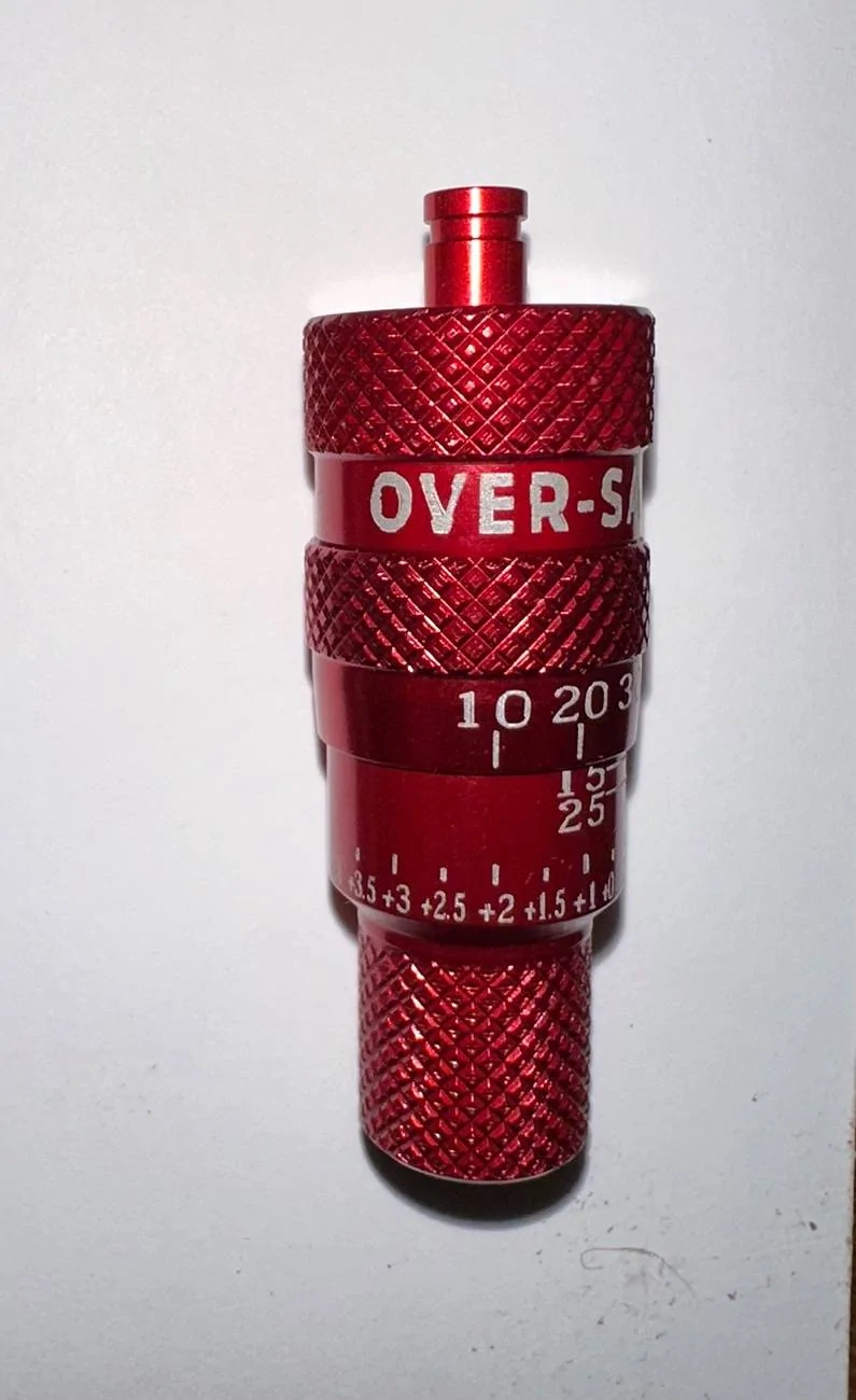

I have Over-Sand tire deflators. I have used Staun and Coyote tire deflators with good results, but there are no reference marks so I would use a black sharpie to make a line as a reference to try to fine tune adjustments. Even if the Over-Sand deflators are not 100% accurate out of the box they seem consistent and repeatable across the 4 deflators.
For example setting them all to 12 PSI might show 12.3 to 12.5 taking into account my AutoMeter, Morrflate and Jaco tire gauges aren’t 100% accurate. But you have reference marks to make very small adjustments on the deflator.
This deflator pictured is set to 12 PSI with 10 at the top ring and +2 at the bottom. It’s far less complex than me trying to explain it.

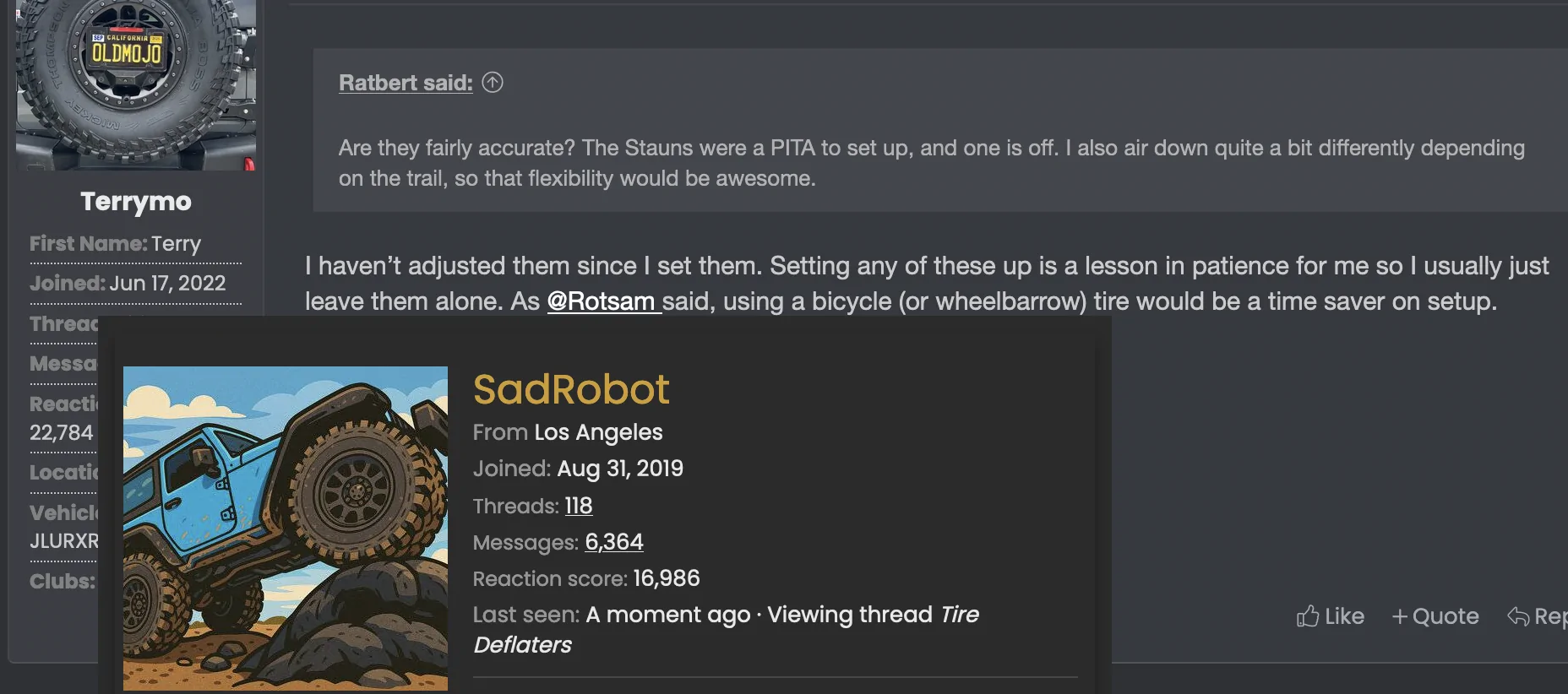

I haven’t adjusted them since I set them. Setting any of these up is a lesson in patience for me so I usually just leave them alone. As @Rotsam said, using a bicycle (or wheelbarrow) tire would be a time saver on setup.
On a side note I think the forum is having a meltdown because I got a notification you quoted me but your post is actually quoting @Rotsam. And if I hover over @Rotsam's username in the post my profile comes up.
Jeep Wrangler JL Tire Deflaters Screen Shot 2025-10-05 at 6.37.48 AM
Either that or @Rotsam and I switched bodies somehow and maybe he's actually the one who came back from Texas all those months ago. 😂
