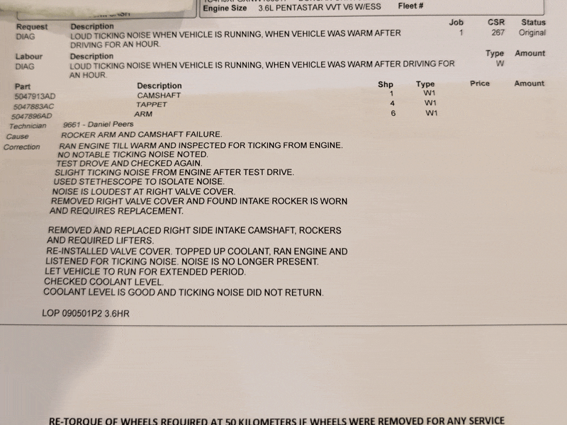

Update: 2022 Jeep Rubicon Wrangler was at the dealer today about the ticking and they said one of the intake rockers was faulty and are going to be replaced under warranty. Said we could drive it home but not to drive it until part come in. They wanted to keep the jeep there but I didn't want it sitting outside on the lot for 2 weeks while they wait for parts to arrive.

Good thing you didn't waste any time, I think time would have wasted your motor
