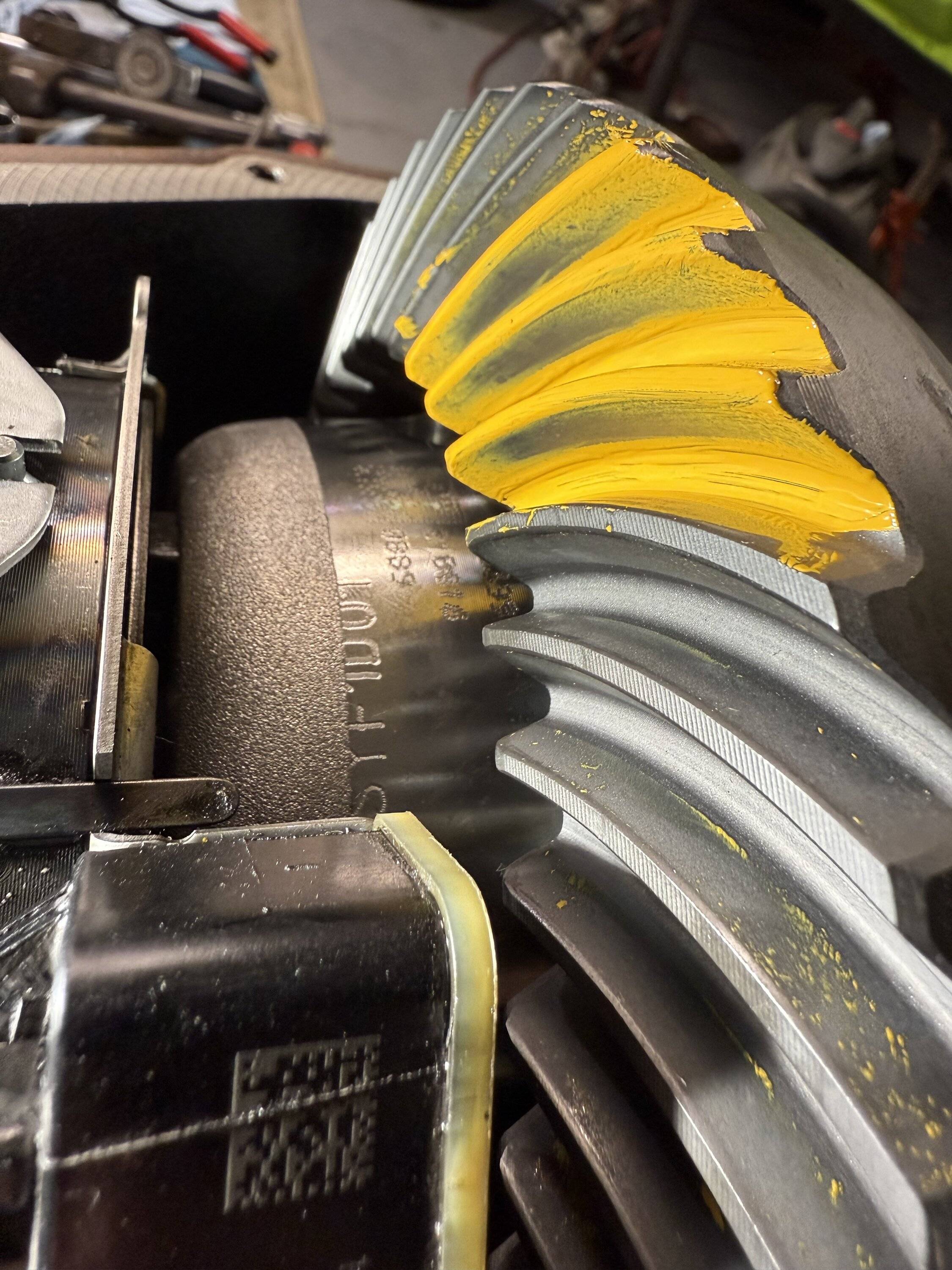

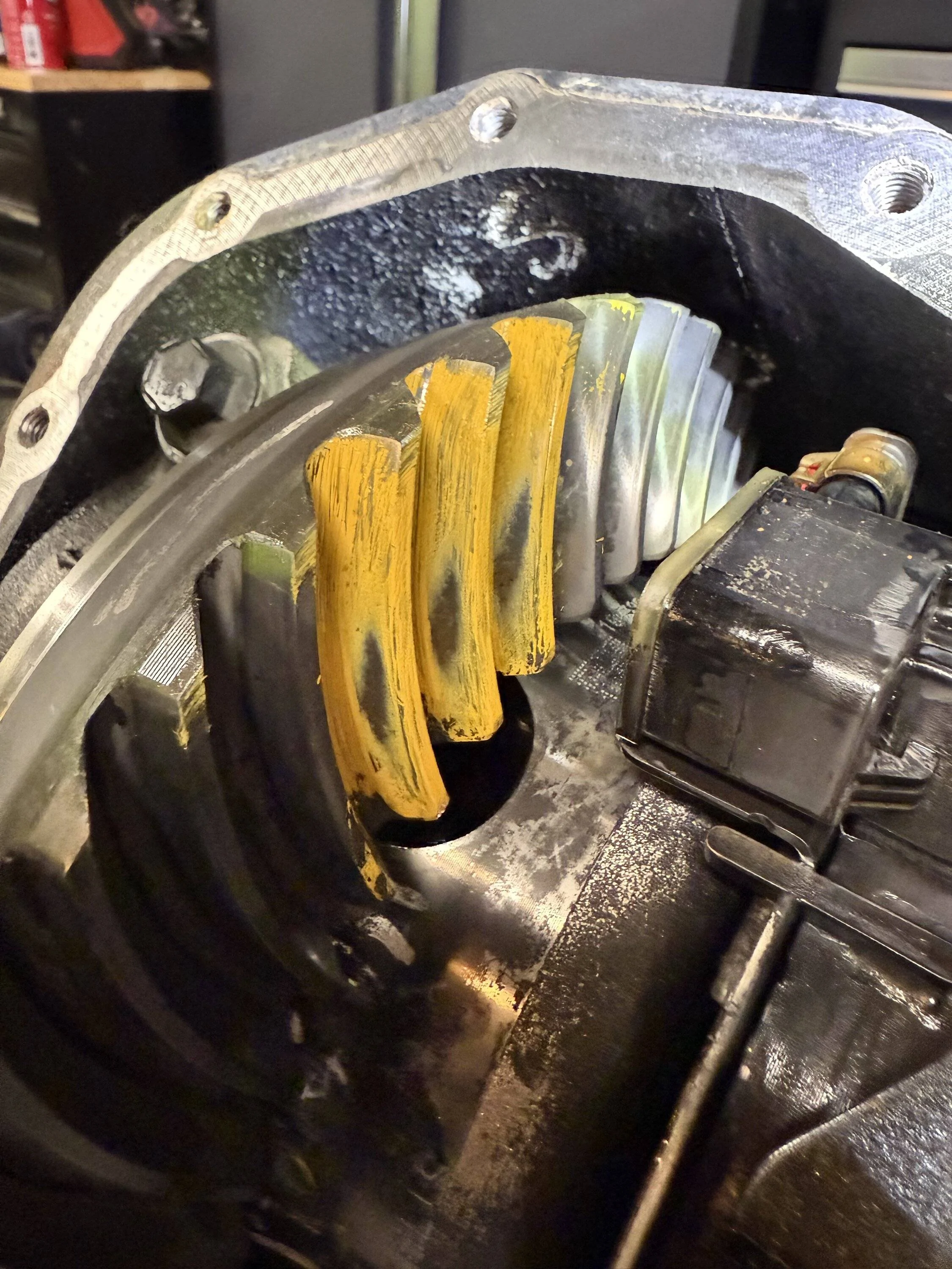

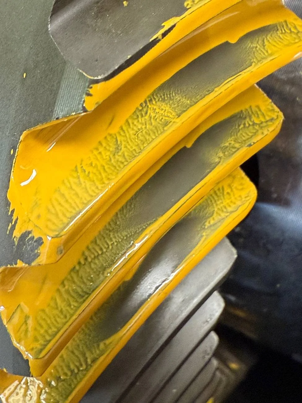

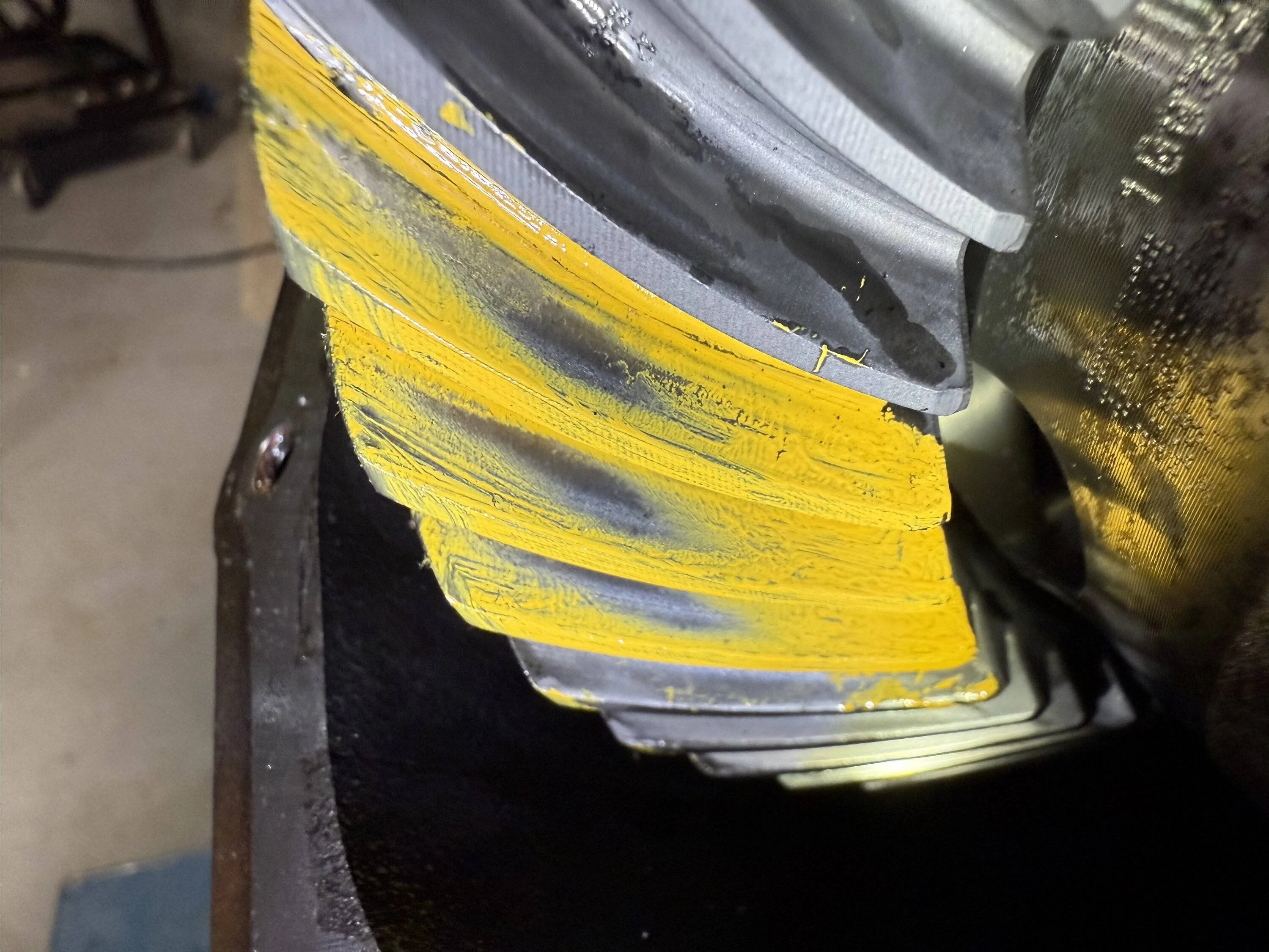

First 2 pics are factory gears thought I would see what the pattern was before teardown… I have installed Dana gears 5.38 I used the factory shims on reassembly
PTR 18 in-lbs
Backlash .004-.005
PTTR 25 in-lbs
The last 2 photo are these specs
thanks for the help

The new pattern looks good to me. Really close to what I ended up with when I went with Dana 4.88s.

Looks great. Roll with it.

Thanks for the feedback got lucky or Dana is that good lol

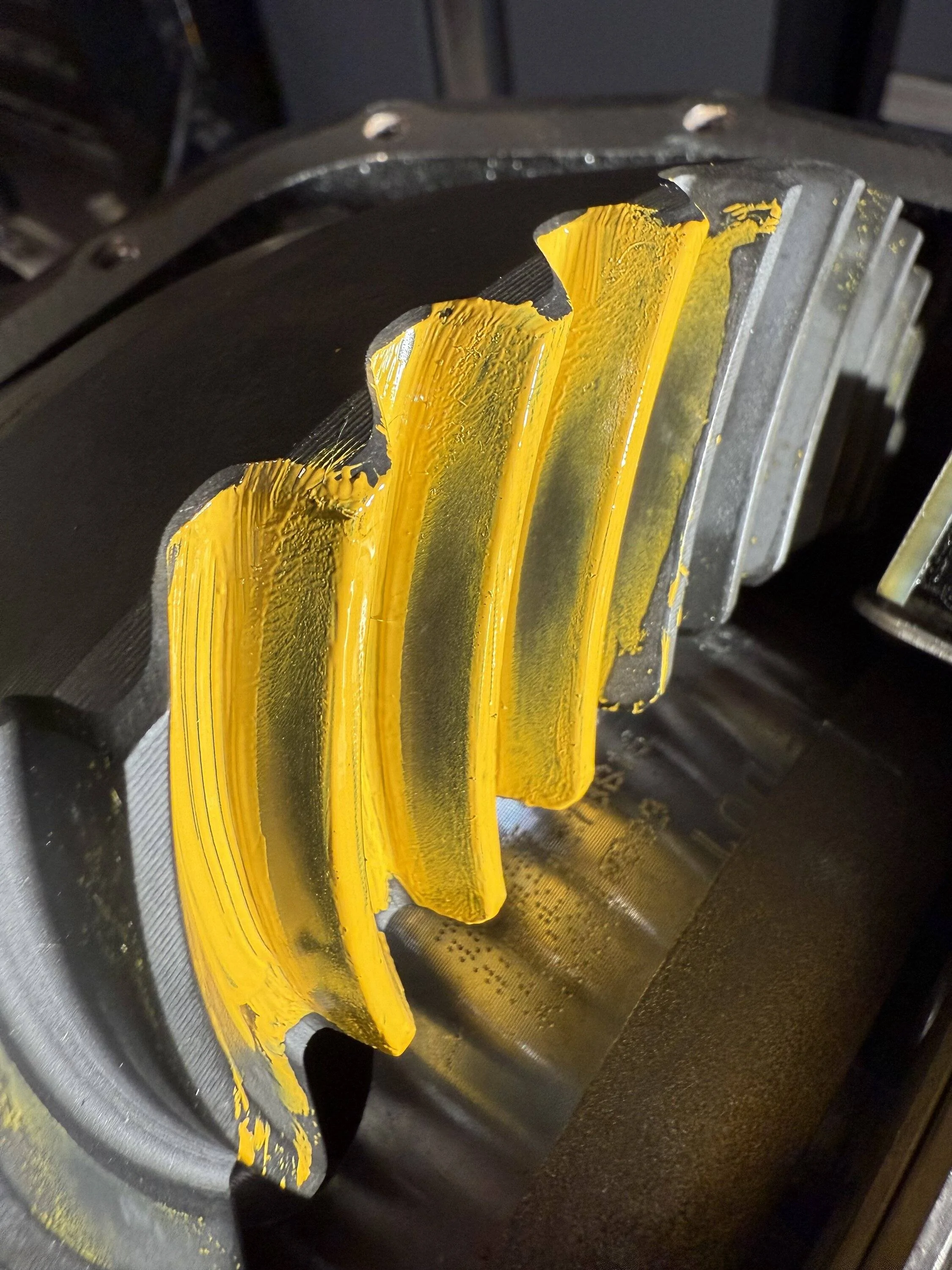

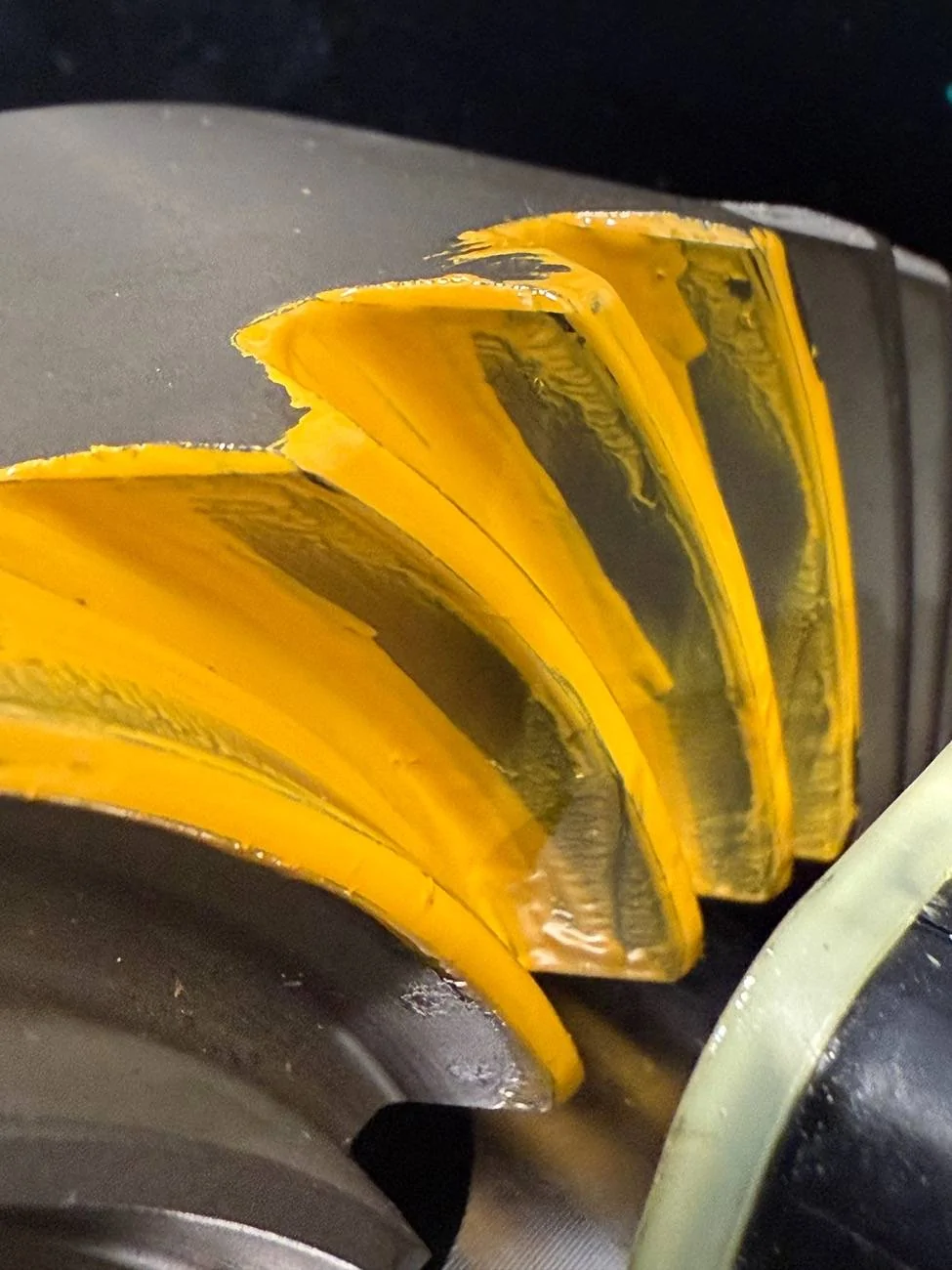

Finally got around to the front axles m210 just put it back with original shims thoughts?
