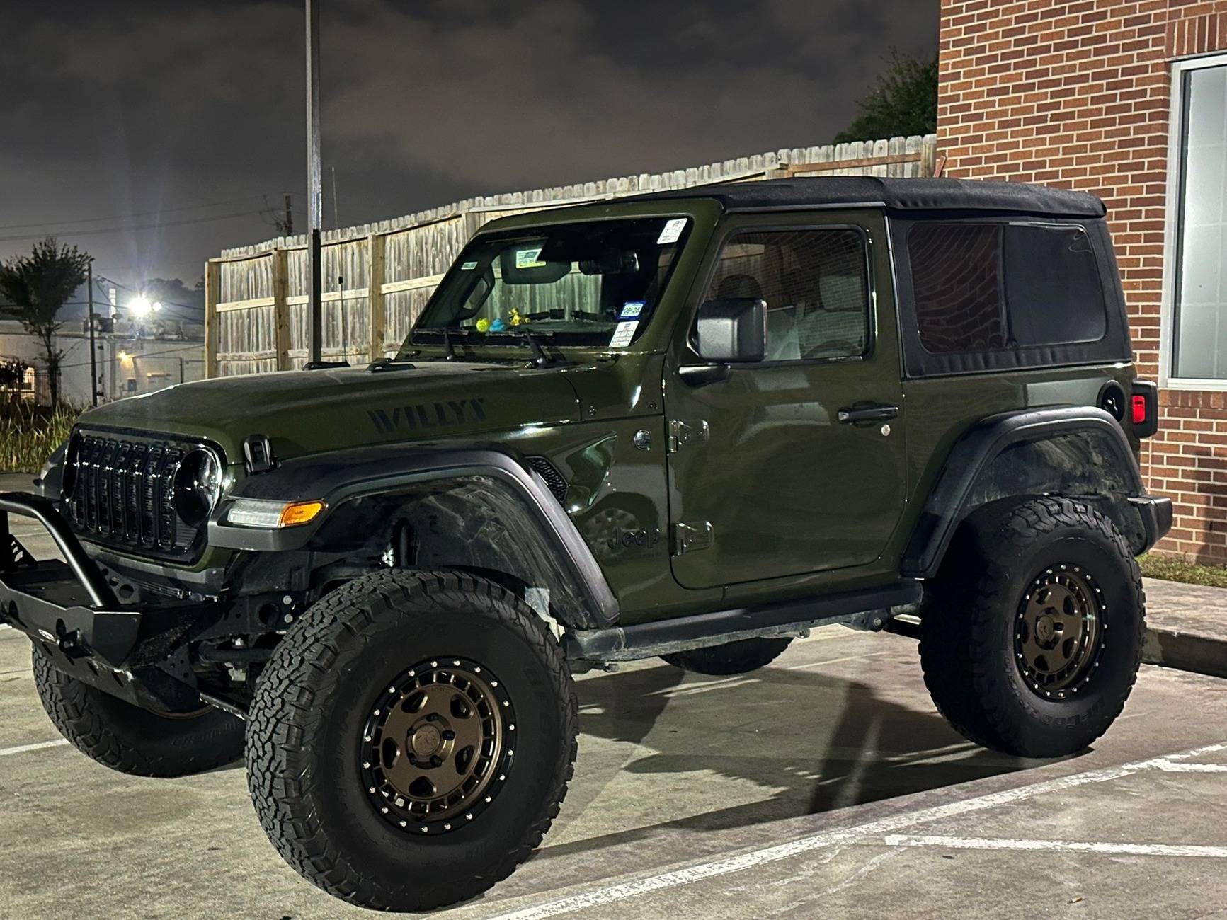

I have a visual for you of what 37" KO2's look like on Clayton Offroad 2.5" Overland lift. I gained a little over 3" in lift. Your sport doesn't have the high line fenders, so you probably won't see this much room between top of tire and fender. But here's a visual for you of what it could look like with 2.5 to 3" lift.

see i think it will be perfect with the sport fenders. I guess if not i could always just go rubi flares...
i like the colors on this Willys

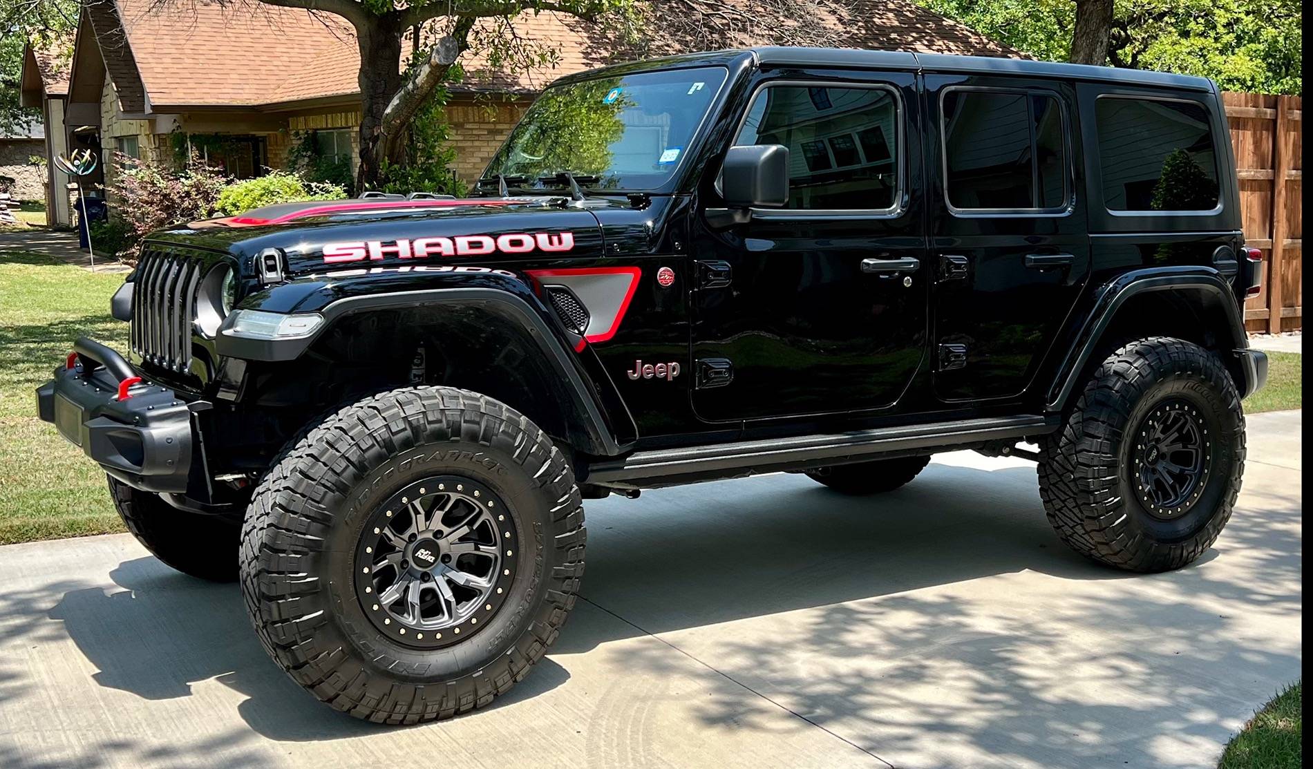

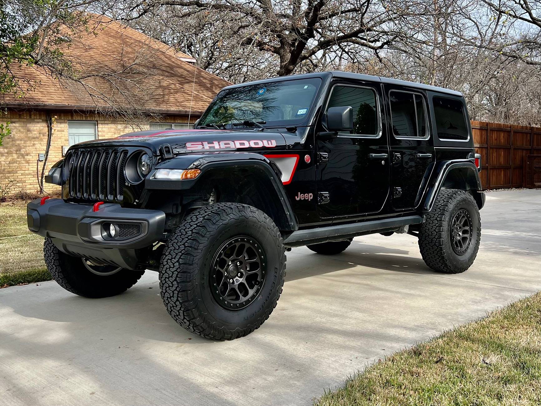

Give you a couple picks for reference on a Sport S with Rubi flares. This is with a mopar 2” lift and 3/4” spacer in front to level. It gained about 3.5” in front.
with Nitto 37 RGs

with 35 KO2s

Correct me if im wrong - The Mopar 2" number is based on stock Rubi - In other words its more like 3.5, or +2' on an already 1.5 higher Rubicon.
I like the rubi rear flares, but for some reason the highline fenders look off to me on the front...I think its the space between the tire and fender.
Im sure its needed but it always looks like too much. The rear looks perfect. Maybe I'm a wierdo...

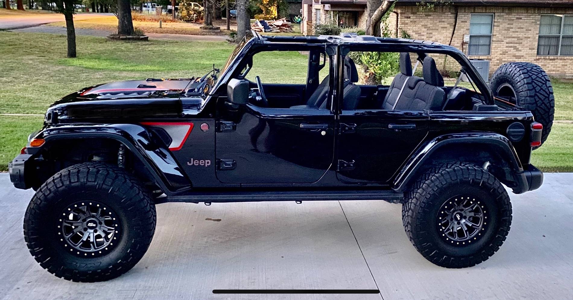

Correct on Mopar 2” lift. The extra space provides room to stuff the front wheel when articulating. It could be angle of these pics as well, not as noticeable on this one
Jeep Wrangler JL Thoughts on my combo with 37s IMG_9825
