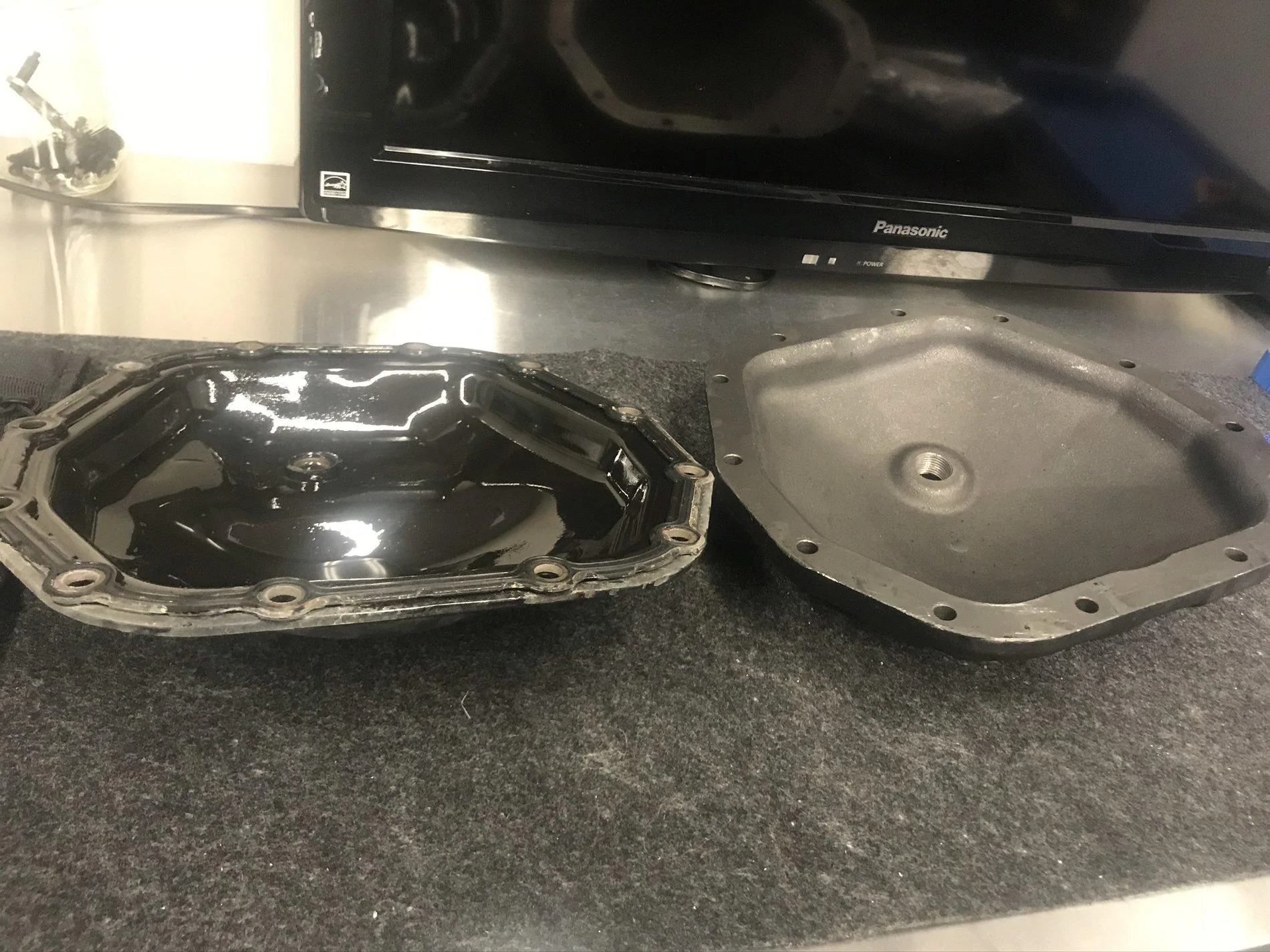

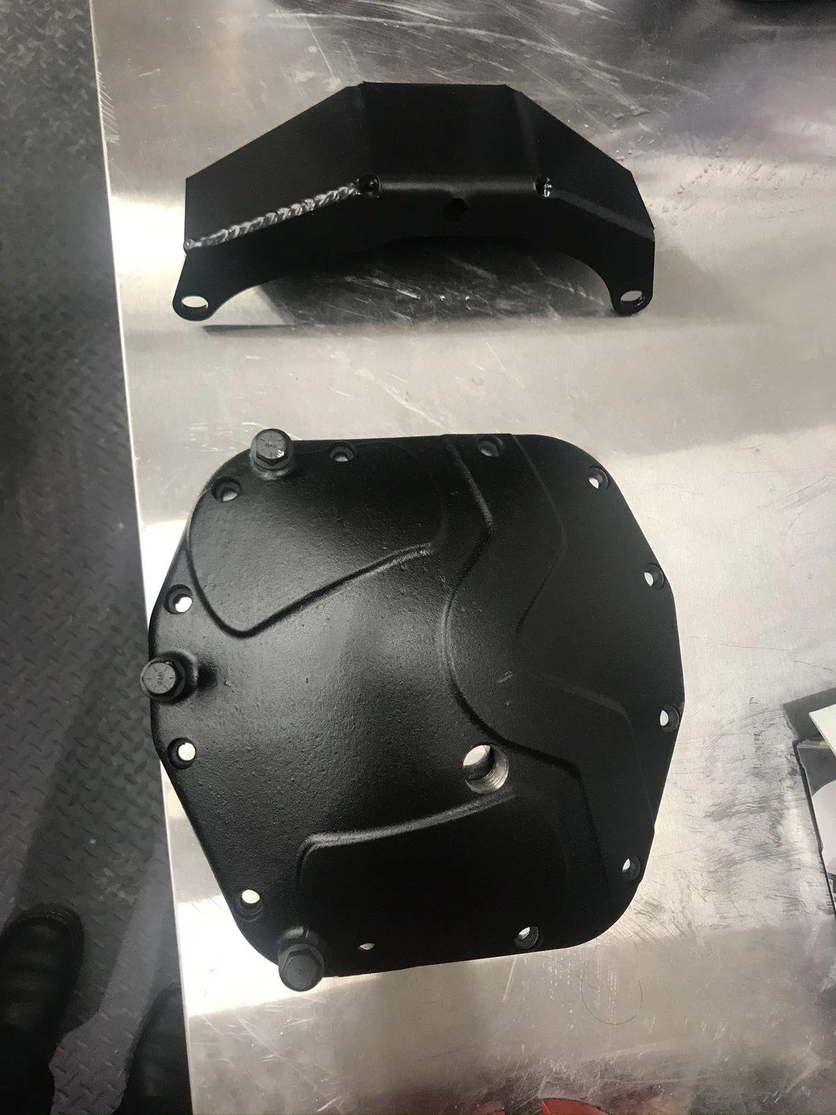

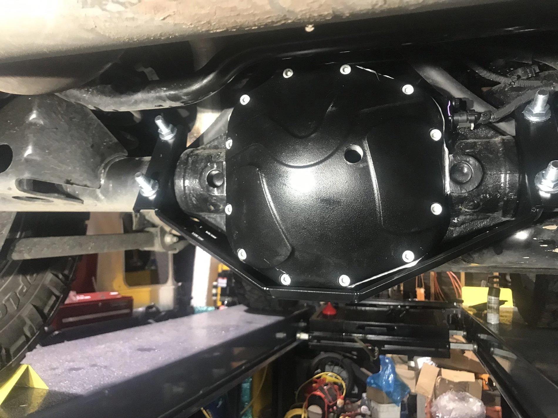

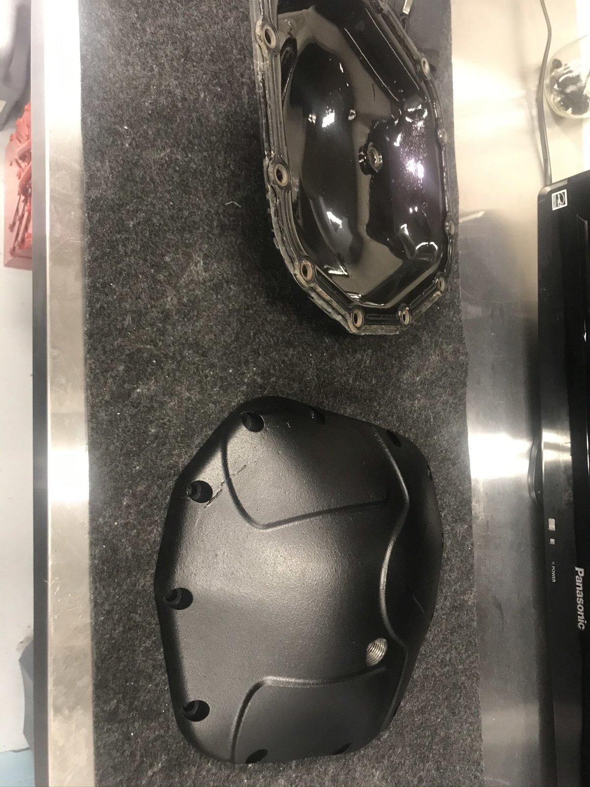

I second the metal cloak. I prefer how the front skid attaches to the diff cover and protects the vulnerable drain plug. Compared to the stock ones, they are stout, nice if you accidentally back into a rock.
I powder coated my skids and painted my covers.

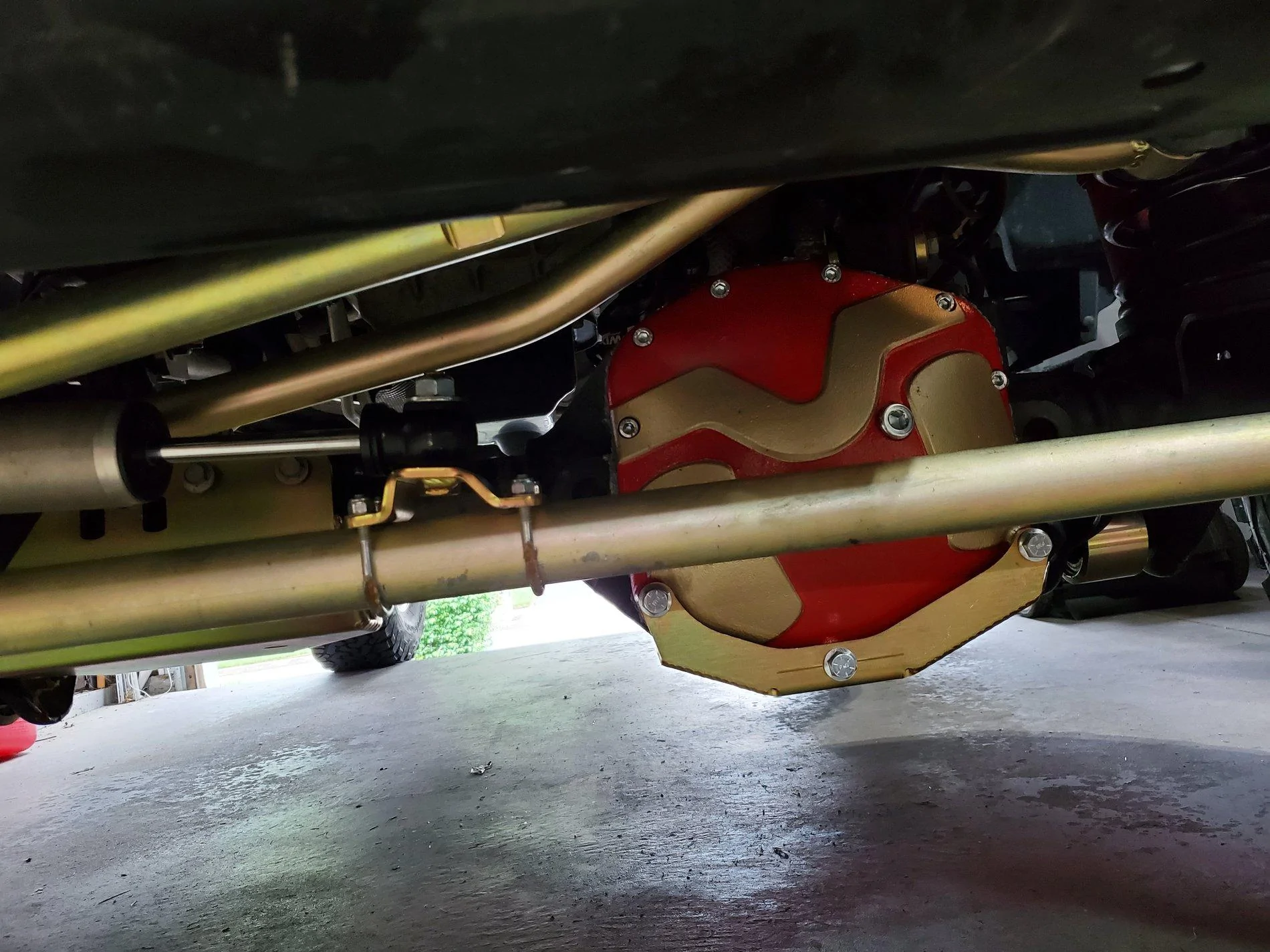

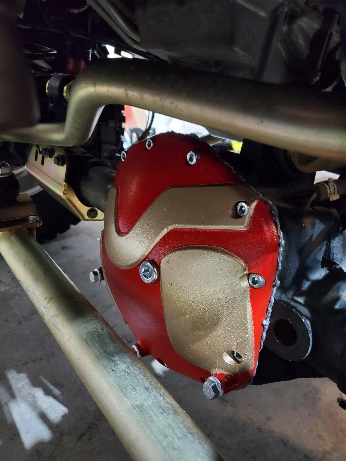

Metalcloak for me.. Doing the rear next.
Jeep Wrangler JL Thoughts on aftermarket Diff Covers? 20200604_214842
Jeep Wrangler JL Thoughts on aftermarket Diff Covers? 20200605_174917
