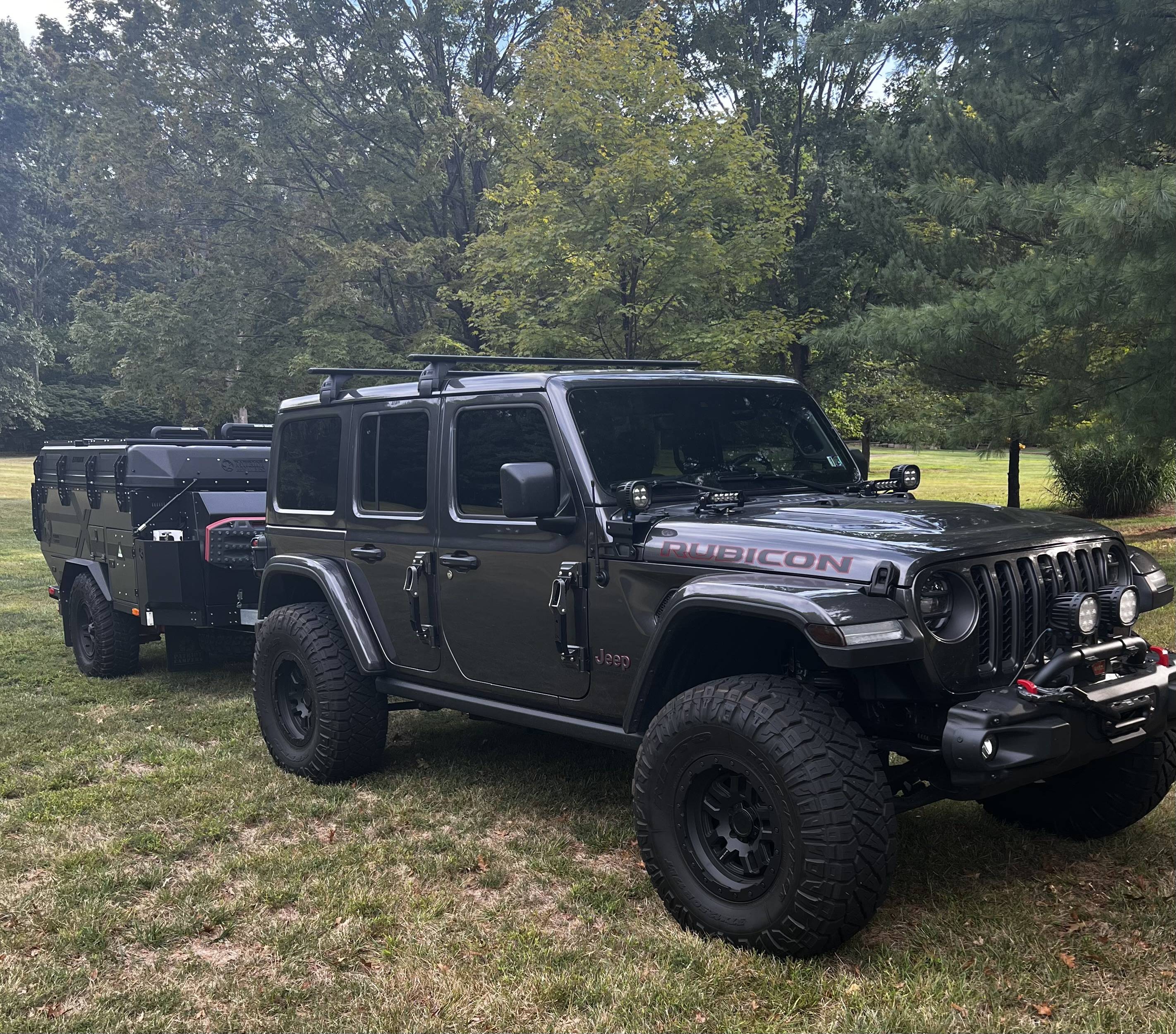

I dig your taste in Jeep and trailer. Here’s a pic of mine. It’s a diesel too. Although I’m on 35s, but debating the jump to 37s before Moab this summer. What did you consider “hot oil temp” you watched out for when you back off the speed?

Hell yeah your set up looks amazing! Yes, I mainly keep my oil temp gauge up and periodically take a peek at the coolant bar gauge. You'll see as the oil temp goes up the coolant temp will to obviously but it seems to lag behind the oil temp. I did regear to 4.56's. If you don't regear and probably don't really need to being in Florida but you may have to take it a little easier if you hit any big pulls coming west!

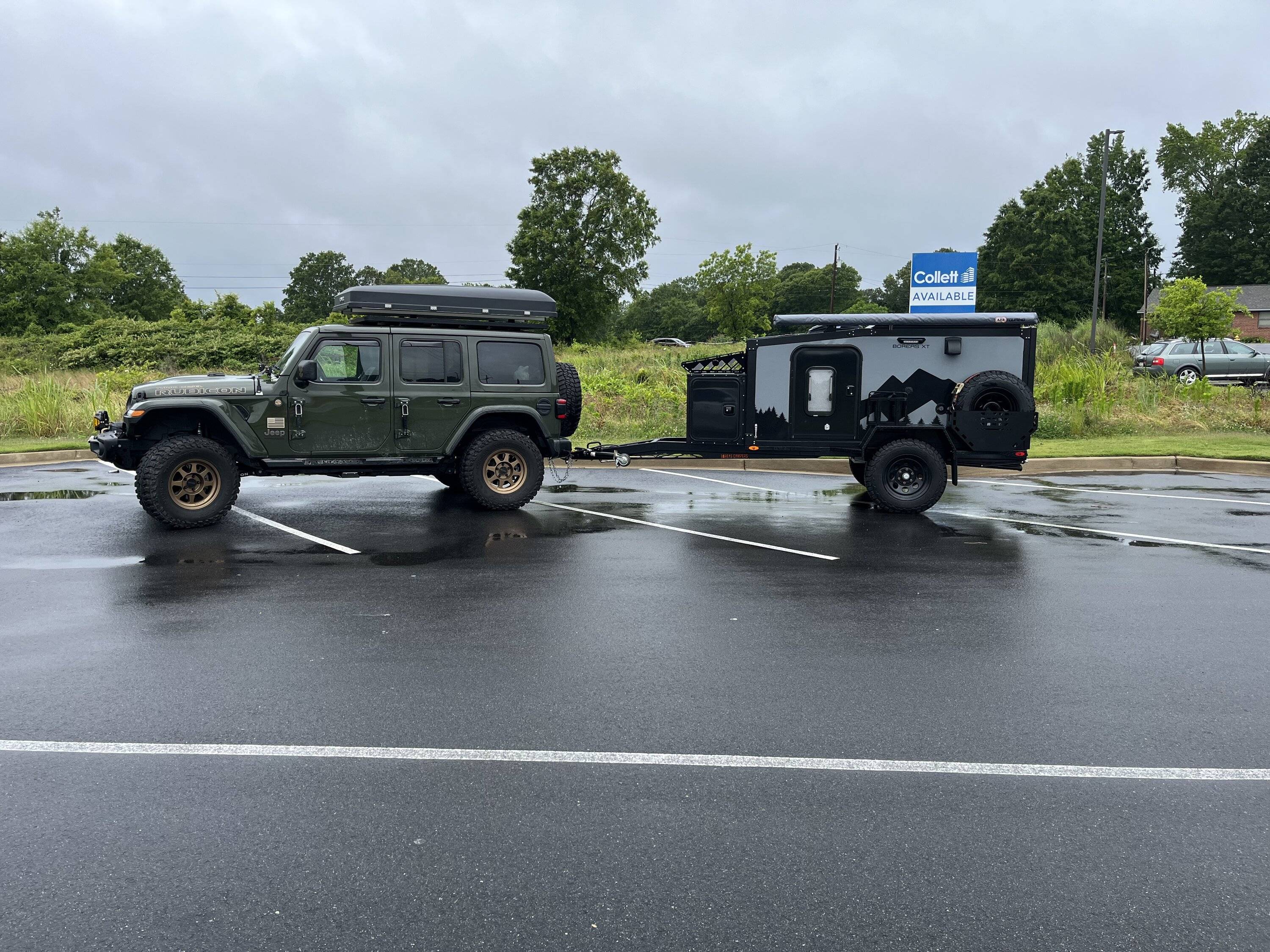

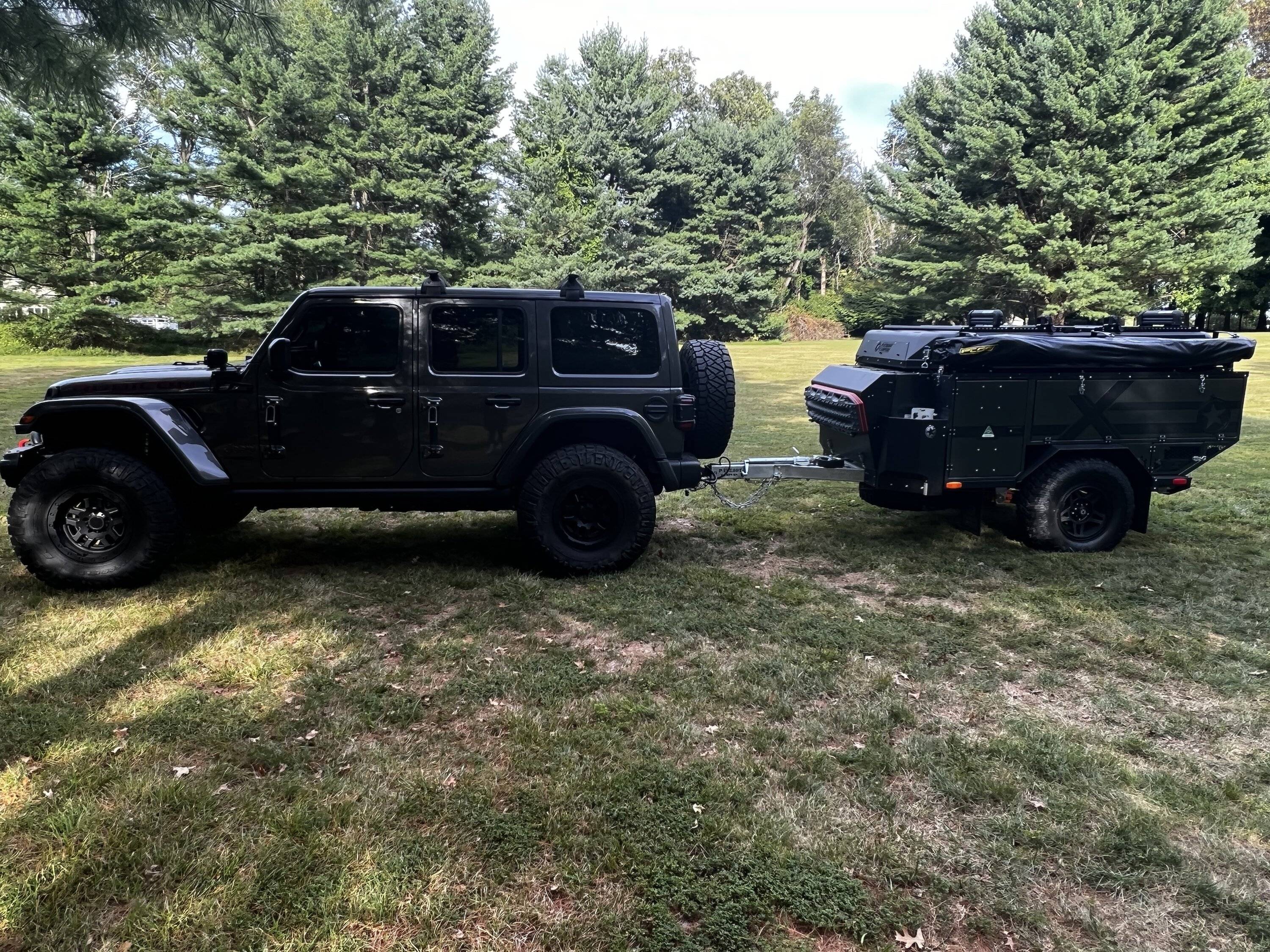

I tow a patriot campers x3 - about 2400 lbs dry and around 3300 when loaded with water, food, gear, bikes, packrafts, etc.
I have a Rubicon Diesel on 37s with mopar brake controller. Never had any issues and it tows great. A few days, I towed at grade in 102 degree weather for 3-4 hours and did not come close to any sort of overheating danger. I probably get around 18-20 mpg on average when towing
I also installed rear air bags inflated to 30 lbs in the Jeep to help with some slight sag, although it wasn’t absolutely necessary.
