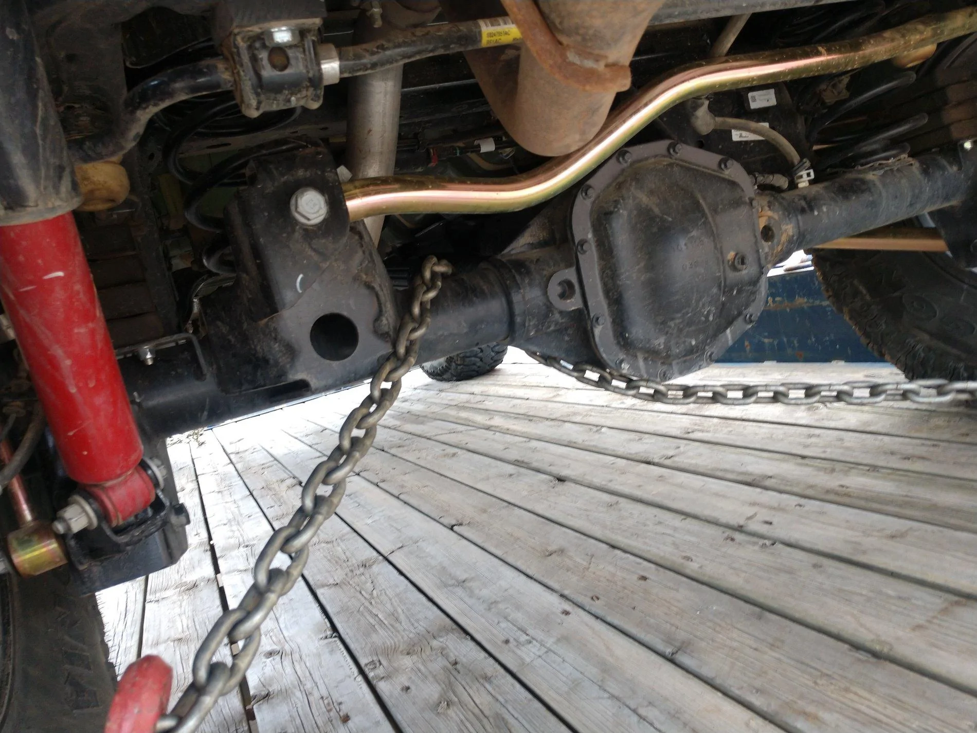

No thanks on the front, I never anchor a vehicle with sprung weight. It's basically impossible to compress the suspension enough to be truly secure. With each big bump in the road the trailered vehicle bounces, slacking and then snapping tight the straps. In the moment of slack, a lot of things can happenWe trailer every time we wheel. I ordered some ratchet straps with axle straps. Works great. Go around each side of the diff and then off both shackles on the front bumper. Straps hold up great, I hate using chains because they scratch up the undercarriage paint to much. No doubt stronger but more than enough for us

Oh I absolutely agree but 4 straps keeps its secured well. I’ve haul tractors, dozers, and track hoes for 20 years and always use chains and binders. For the jeeps and buggies, we’ve been all over the US and never an issue. I stop every couple hrs and always check the straps, ideal would be frame/axles but the bumper for us, is much easier and where the tie points fall are more convientent. I had a custom 24+4’ GN built with steel deck and 10 flush mount points welded in and they still aren’t quite rightNo thanks on the front, I never anchor a vehicle with sprung weight. It's basically impossible to compress the suspension enough to be truly secure. With each big bump in the road the trailered vehicle bounces, slacking and then snapping tight the straps. In the moment of slack, a lot of things can happen
I understand plenty of people do it, and it works - until it doesn't.
