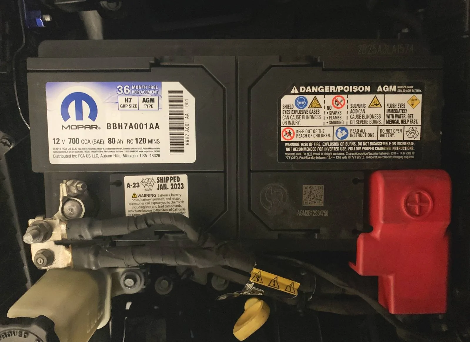

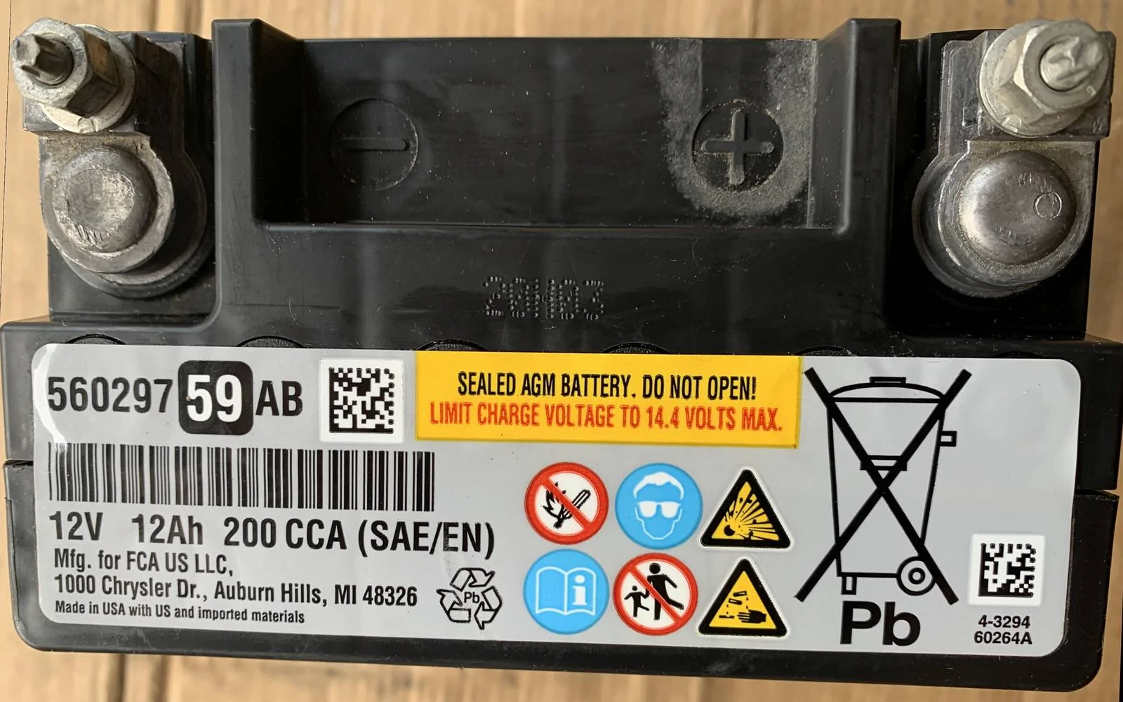

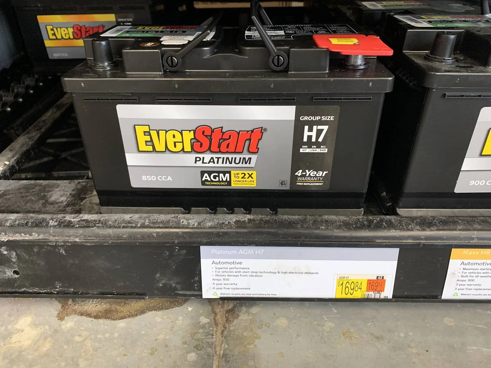

The Jeep battery system functions as one battery except when the vehicle is in a stop/start event. In that case, the small battery keeps cab items running. The 2 batteries are joined again for the vehicle restart.
Many Jeep owners have eliminated the complications of have 2 batteries by removing the aux battery negative cable.
Pulling fuse F42 is not necessary. Pulling F42 disconnects the Power control Relay. This keeps the auto start (AKA - Avengers) light from showing an alarm.
Removing the aux battery and fuse F42 does NOT change the way auto stop/start works. Your Jeep will function as designed.
The sum of the power (Cold Cranking Amps) of the 2 Mopar batteries is somewhere between 800 and 900 CCA. A single H7 battery can be bought that is as powerful as the 2 Mopar batteries together.
Aux battery:

Mopar main battery (this one is 700 CCA - some are delivered with lesser batteries):

Everstart battery from Walmart:
Jeep Wrangler JL This Confuses Me i-4rrpkhs-X3
