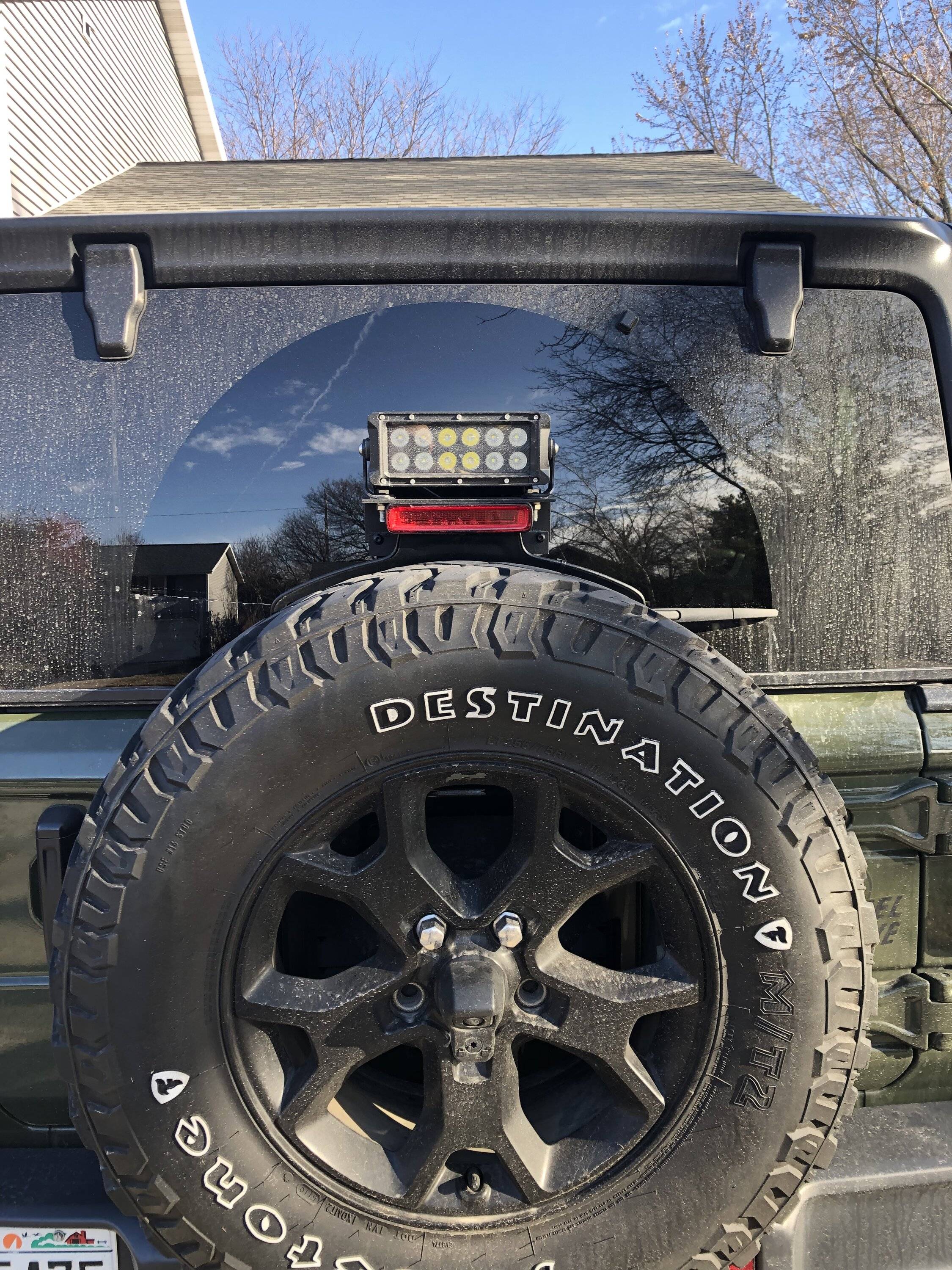

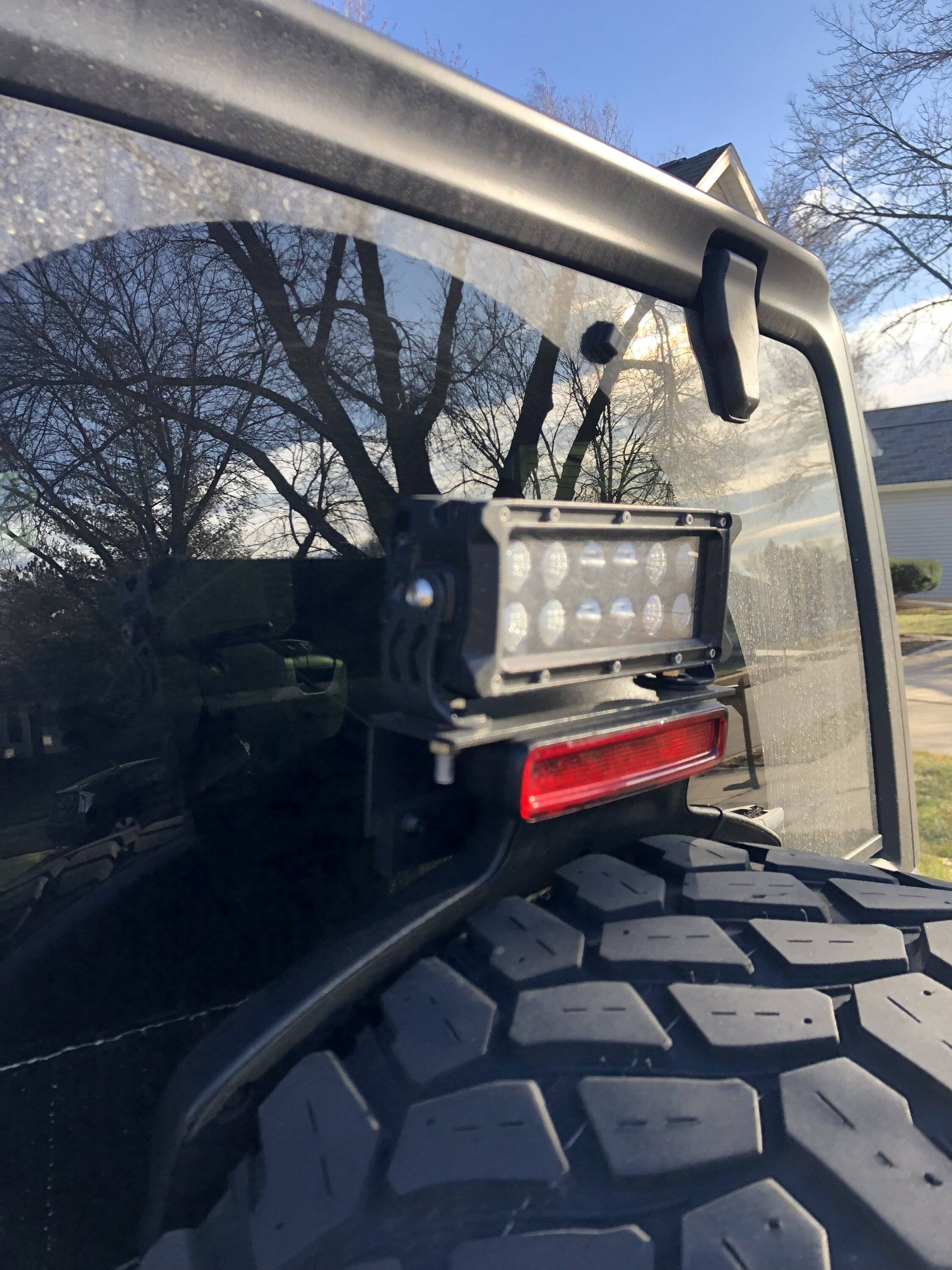

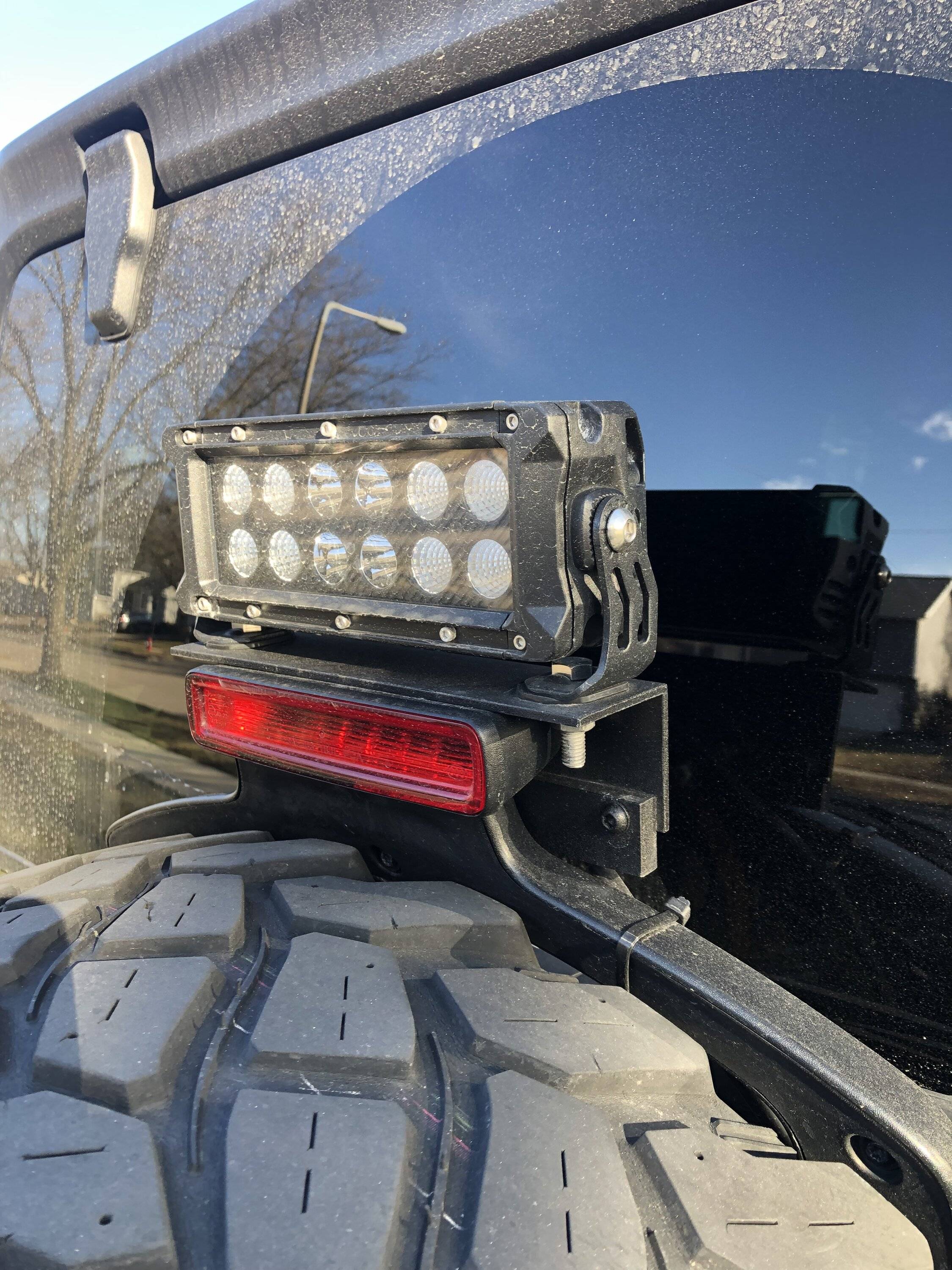

I was inspired by the AEV spare tire light mount on my Uncles AEV JK. I really wanted something like that for my set up but didn’t want to have to get the AEV bumper spare tire combo! So my dad and I fabricated a mount from aluminum flat stock some stainless steel bolts and rattle can of truck bed spray. The mount is bolted to the third brake light rack and supported internally. The light I used is the 8 inch harbor freight light bar. I then ran the power wires to my switch pod to control the light. The light is extremely bright and awesome for reverse lighting!
