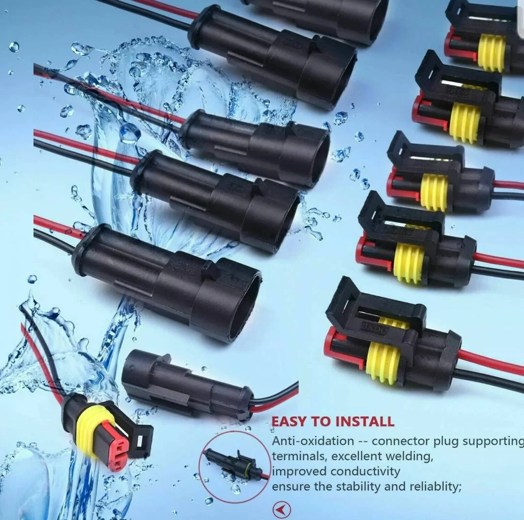

I used quick release connectors to connect a spare tire brake light ring.
Jeep Wrangler JL Splicing into third brake light harness. Screenshot_20200104-225939_eBay

Did you make a ”Y” style connector? Do you have a photo of where you spliced and your connections.
At first, I wasn't sure if I wanted to keep the OEM brake light installed so I just used a t-tap to connect my spare tire brake light ring and ran both for a while. After a few days, I decided to remove the OEM light so I cut the t-tap off and used the waterproof quick connectors. While I was at it, I added a quick connect to the OEM also in case it is needed to pass state inspection.
