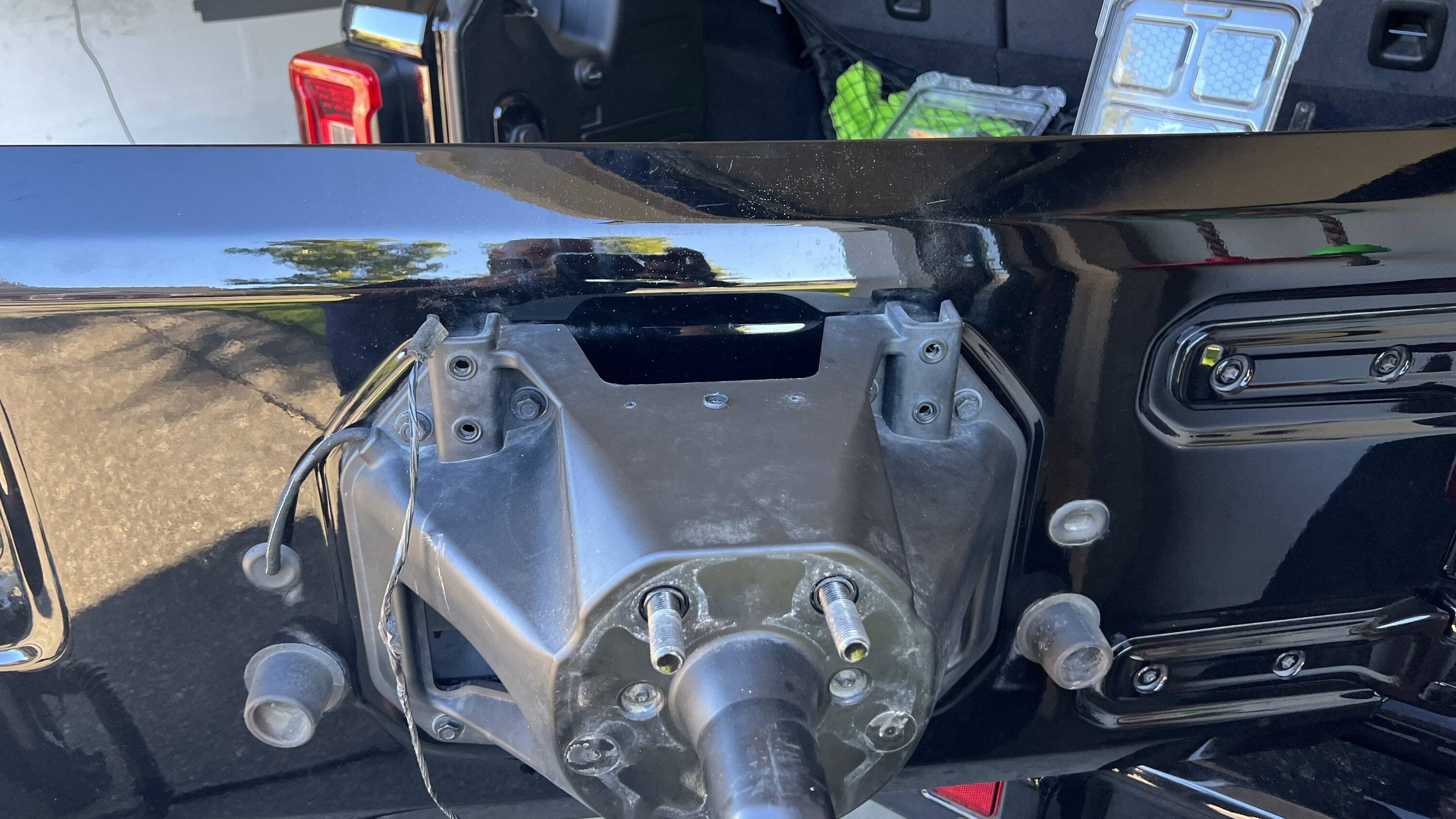

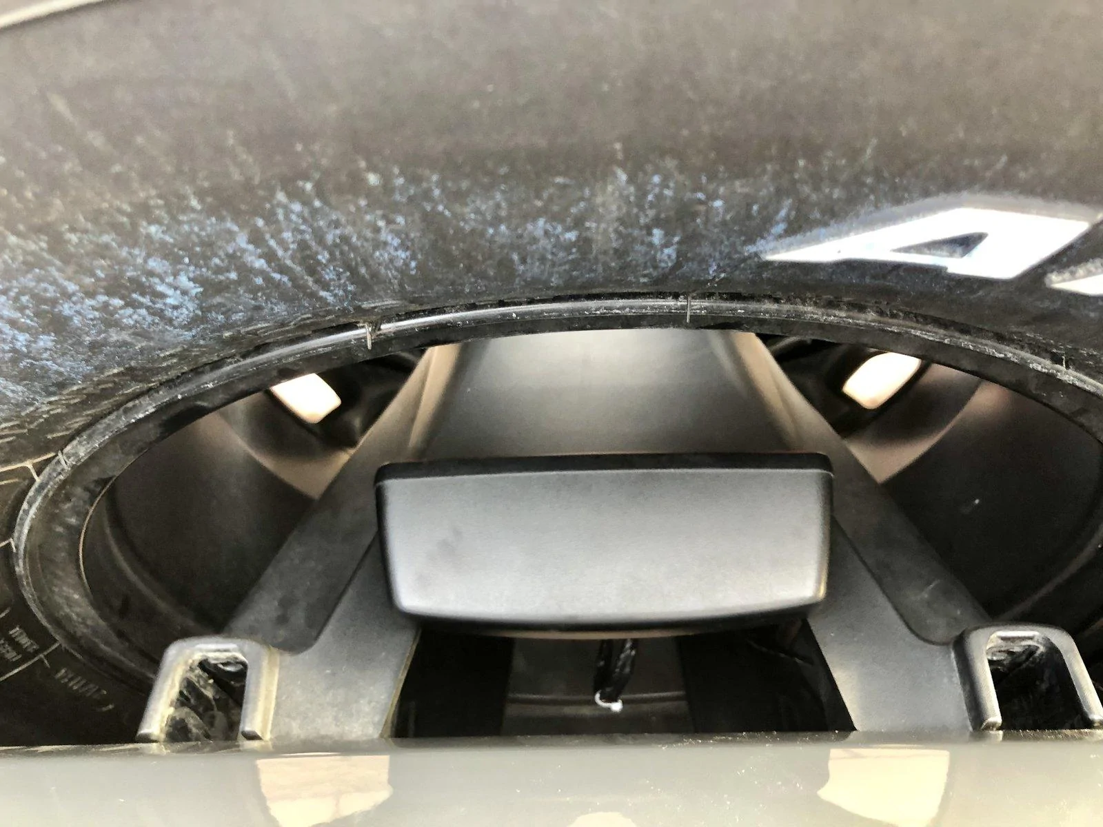

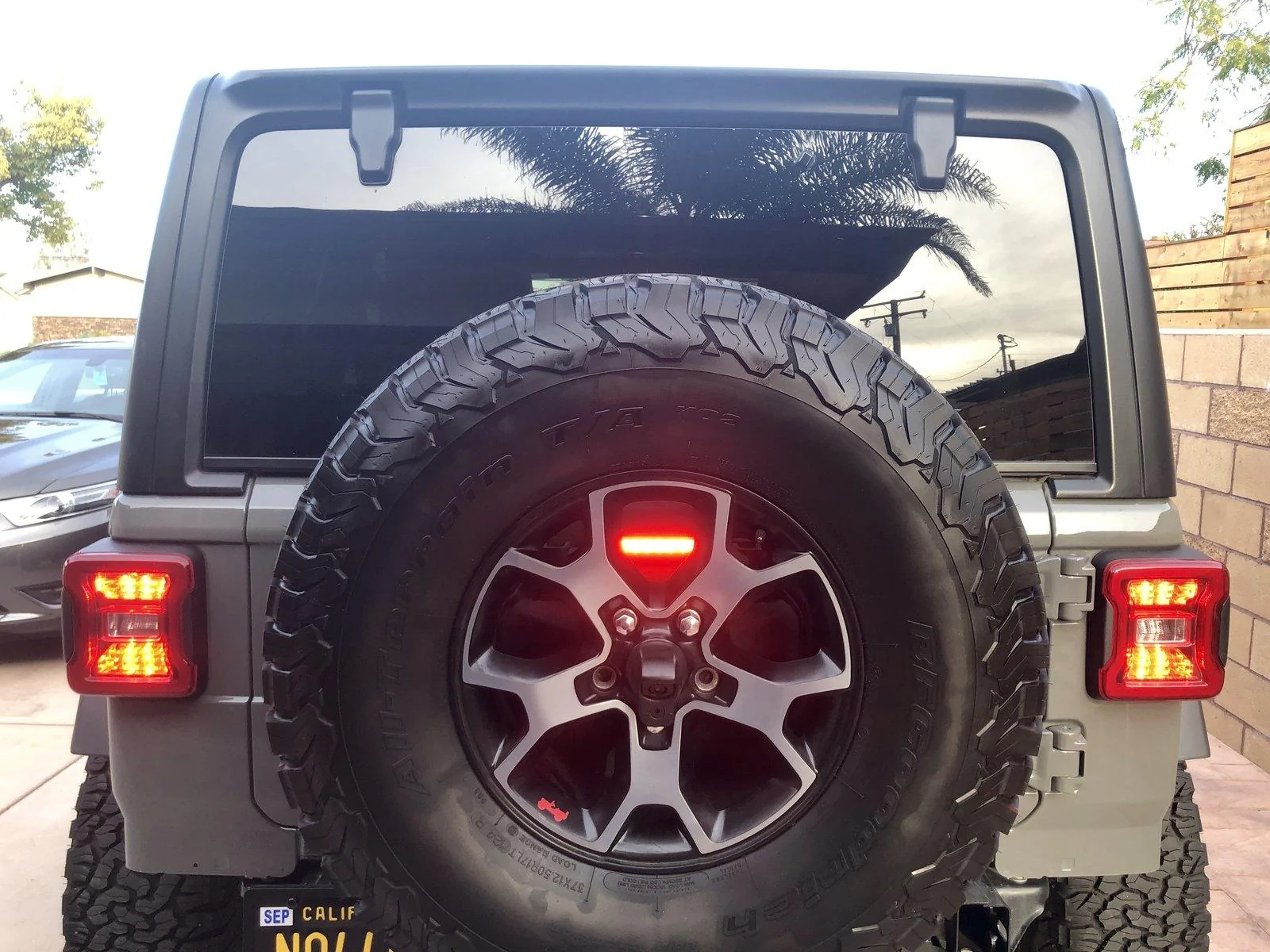

No cost 3rd light relocation for stock tire carrier. Just unbolt it all and separate the oem light. Use 3m 50lb tape to attach to the top of the carrier and done. Easy 15 minute job and it takes 1.4 pounds off the tailgate as well.
