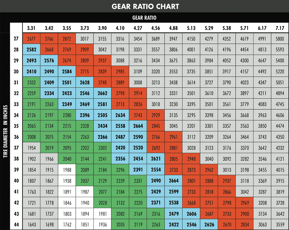

Agree with the lack of gearing options. IMO 4:10’s would be perfect for a 392 with 35’s. 456’s are to low for 35’s and will require 37’s to maintain low range sand running speed and highway MPG.
I agree on the gearing and that one of the main reasons I ordered a Xtreme Recon. There is talk elsewhere, I believe where there is on a gear ratio thread for 392 `s brought up, and the mention of increased RPM`s and something else
Here is a typical gear ratio chart just to get a close idea, best to have the real measurement of your tires.
Here is the link that you want to visit
https://www.g2axle.com/
https://www.g2axle.com/pages/view/gear_ratio_calculator
Green is best fuel economy
Blue is best overall
Red is best power

Thanks, great chart.According to this chart to maintain best overall with 3.73’s to not go over 34’s (285-75).There is a chart posted under tires that shows RPM to MPH. 373’s and 33’s are comparable to 410’s and 36’s, 456’s and 39’s(maybe 38’s)

Thanks,great chart. According to this chart to keep best overall with 373’s I shouldn’t go over 34’s(285-75). There’s a chart posted in tires that shows RPM to MPH. 373’s with 33’s is about the same as 410’s with 36’s,456’s with 39’s(maybe 38’s)
