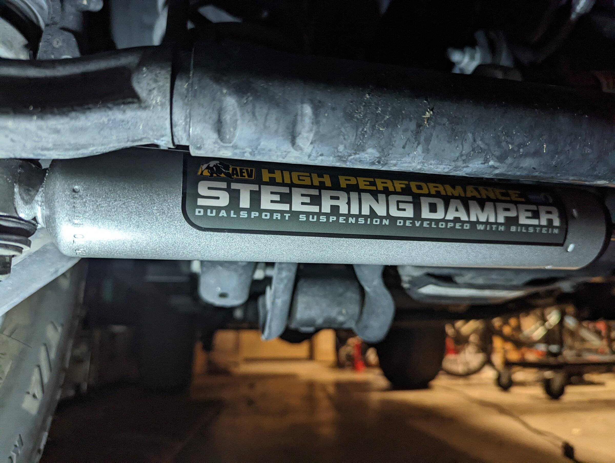

Re-Installed the TazerJL, after I did the update to the firmware. It's much less daunting the second time. First time I was afraid I was going to fry the computer.
I also ordered and installed the AEV Bilstein Steering Dampener. Probably not a good use of $100, TBH. It didn't do anything to improve steering, just adds mild resistance to turning. And, actually, I think it worsened the pull to the right.
I'm going to try the "pull the fuse" trick on the steering and see if it works. Maybe have another alignment done. I'm afraid the only real solution to this problem is a PSC hydraulic steering pump.

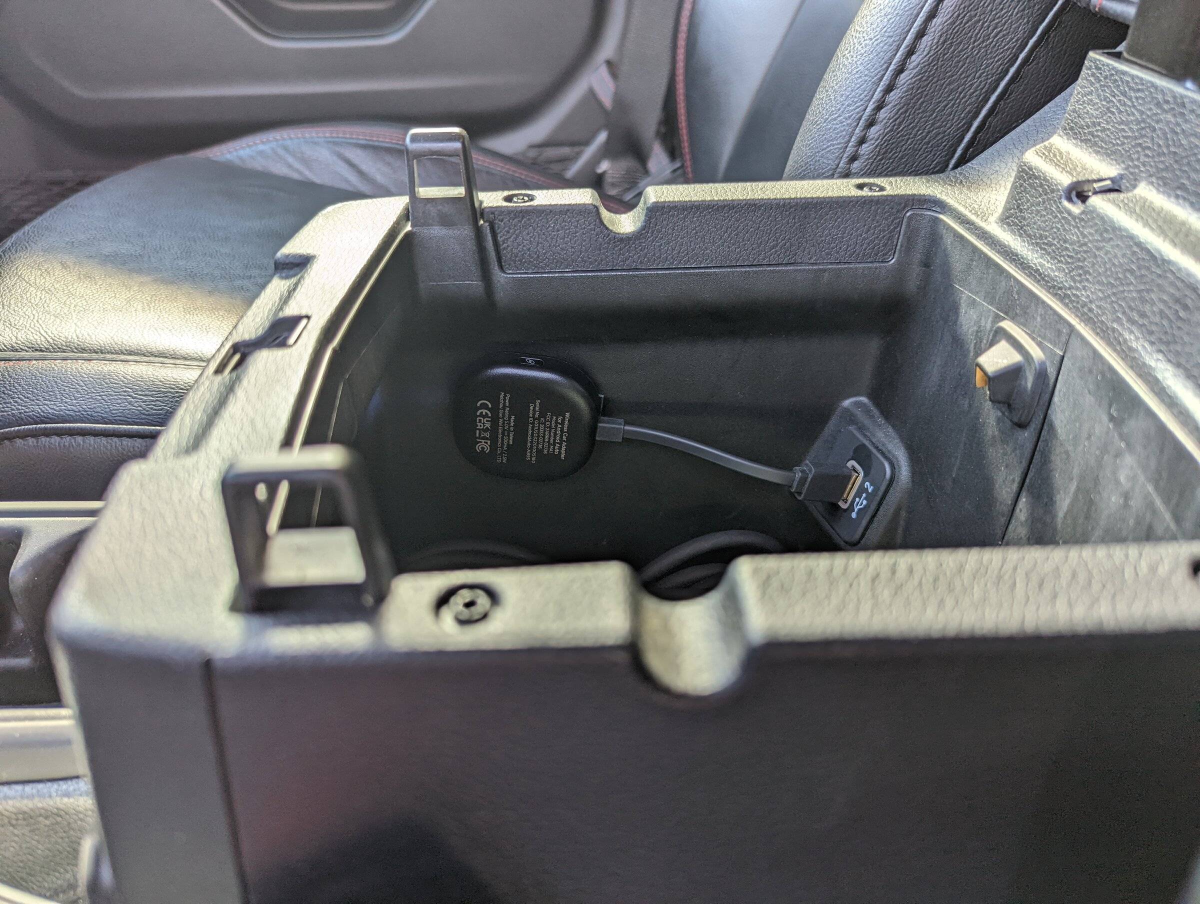

Forgot to mention this fun little toy. Motorola MA1, allows Wireless Android Auto, so no more wires. Pretty Great!
You get mopar lower CAs? Tighten the ball joint nuts?
Im going through the same issues.
