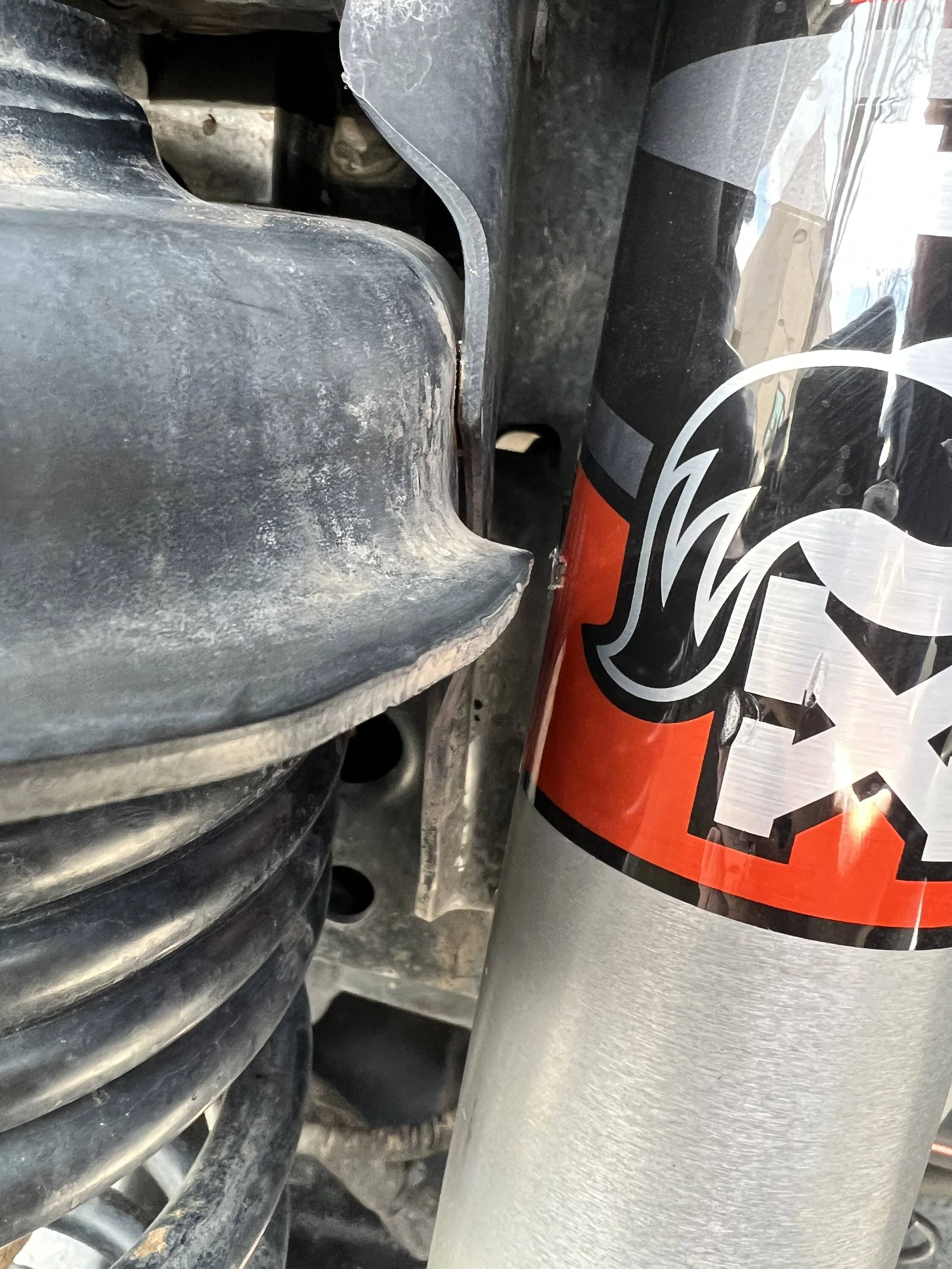

Took the high setting down to 1 and kept the low setting at 5. Been upping it one click every day. Got up to 4 and went back to 3. So current settings is 3 high and 5 low.
Found a clearance issue today. Appears the shock is making contact with the spring perch. Will remove the shocks and grind down the metal perch a little bit this weekend to make clearance.
You should look into buying offset mounts for the bottom versus grinding on your spring perch. As you articulate more I doubt you would get enough clearance by grinding without introducing a weak point.

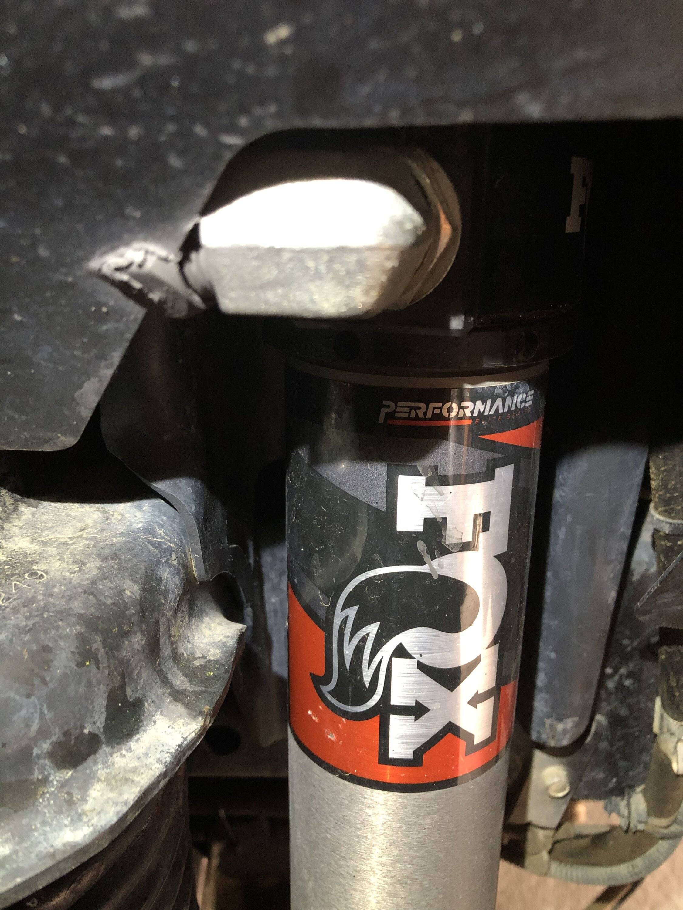

Hmmm...what lift are you running?
I have more clearance than what you show:
I have the Metalcloak 3.5” springs, Clayton control arms, and soon adjustable sway bar links by Evo.

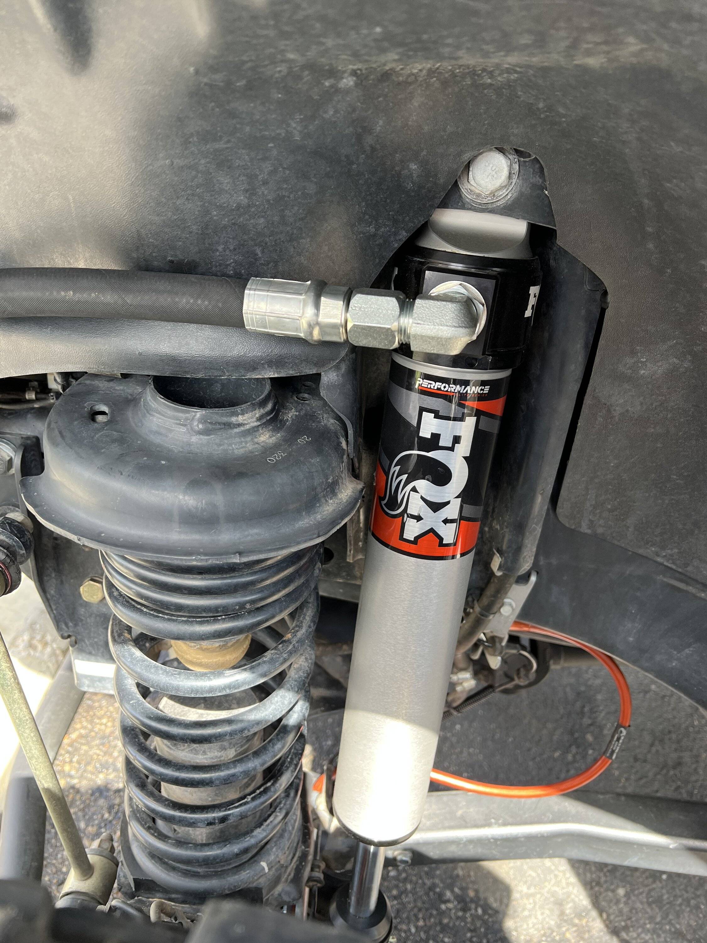

Here’s mine for reference…….I’m using the evo lower relo brackets.
Thanks for sharing. I worked on the clearance issues last night and realized it’s probably due to where I have the front axle sitting with the lengths of the control arms.

Yeah, I think spencer hit it on the head, his axle is probably positioned a little more forward ….
Yep; fully agree!
