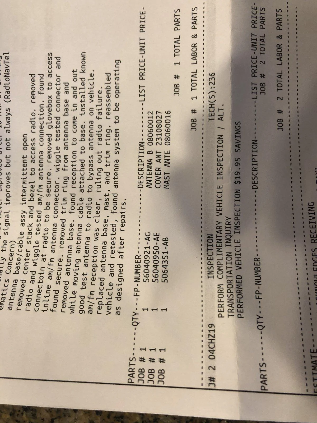

I've had my JLU for a little over a week and just noticed the FM/AM radio was not coming in on any channel. I checked the lower passenger kick panel and sure enough, the antenna coming in through the fender well was disconnected from the cable running into the back of the UConnect. I reconnected and everything is working fine now.

Has anyone found a solution to the FM radio reception issues? I've had enough, taking it in soon. I did my best to check the antenna connection under the glove box and kick plate. I don't see any bad connections. Has anyone had this fixed by the dealer?
