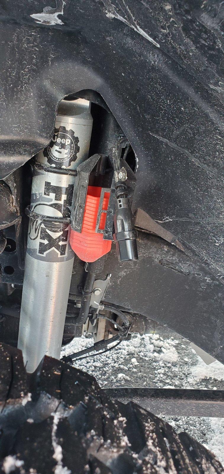

For all you engine block heater folks...here is a little "hack" I came up with.
Ran the plug down to the driver side shock. Strapped an extension cord plug protector to it and housed the block heater plug in it.
Dont have to wrestle with the hood if its covered in snow and ice to get to the plug. Under the well it stays protected.
Pop the cover and plug in/unplug...simple. and looks pretty cool too.
