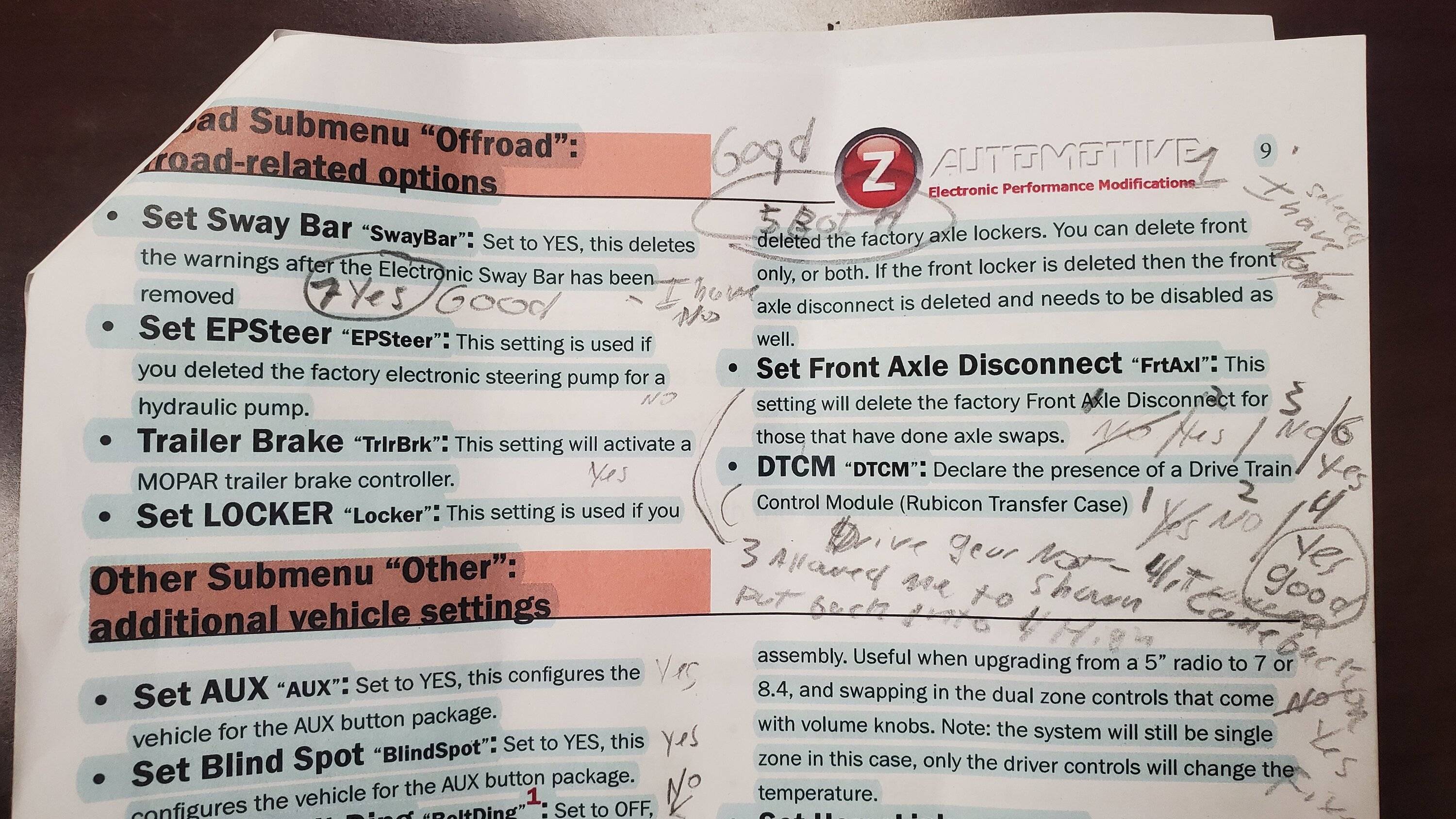

Tazer Instruction Manual UPDATE, a follow up to my initial post:
This weekend I was able to invest some time in an attempt to see if the Tazer’s User Manual (version 11.4.1) became more user friendly. In short, it was not. My primary focus was to set up the OFFROAD Submenu, this because one [or more] of the Tazer settings was preventing my Jeep from engaging the lockers and or transfer case. I say “or more” because some settings appear to be dependent on other setting. So, I invested 1.5 hours playing with all the Offroad settings. I’ve included a pic of my working document, this more so to share the madness that was going on in my mind as I passed thru 7 Reboots & 14 sleep cycles to finally get the Offroad Settings, set lockers, functioning. I’m still not 100% certain they are all accurate, but I was able to get my red locker dash switch working (light up) and engage the lockers. I am not taking a shot at Zautomotive. As I expressed earlier, I love my Tazer (when set up properly). The following examples will detail my thought process and what I experienced.
For awareness I have a Jeep Wrangler Rubicon 392. In other words, I have all the same factory equipment in the Offroad Sub Menu minus the Trailer Brake. Although I have the Tow Package, I do not have the MOPAR brake controller. I have not physically removed or added anything from the Jeep as it relates to this particular sub-menu.
I’ll be primarily providing the last measure of the 7 Reboots that left me with engaging lockers. Keep in mind that I went back and forth on a few settings because some settings were dependent on other settings.
An excerpt from the 11.4.1 User Manual along with my notes:
“Set Sway Bar “SwayBar”: Set to YES, this deletes the warnings after the Electronic Sway Bar has been removed”
I initially had this set to NO, as in I do not want my warnings deleted. My Electric Sway Bar is installed. A YES setting implies that the sway bar has been removed. I learned the correct setting for my Jeep is YES. When set to NO the Jeep does not ‘see’ the factory electric sway bar. This instruction is completely backwards.
“Set EPSteer “EPSteer”: This setting is used if you deleted the factory electronic steering pump for a hydraulic pump.”
Following the instructional format from the previous instruction, if “Set to Yes”, I have this setting at NO. A YES implies the electronic steering pump was removed. I do not know which one is correct. Currently set at NO my power steering is still working. As my power steering is working, this instruction contradicts the format of the previous instruction. With that said, I Do Not Know if I have potentially turned off a warning sensor for the power steering, or indirectly affected any other system that is dependent on the Jeep ‘seeing’ an electronic power steering pump. Understanding this instruction may be completely backwards as well, I have no symptoms at the moment to show me what the correct setting should be. Less ambiguity is required.
“Trailer Brake “TrlrBrk”: This setting will activate a MOPAR trailer brake controller.”
There is no if, “Set to Yes” in this instruction. I currently have this set to YES. I figure if/when I get a MOPAR brake controller I should be able to simply install it and it’ll function. Less ambiguity is required, as I could be completely wrong based off previous instructional attempts and the results.
“Set LOCKER “Locker”: This setting is used if you deleted the factory axle lockers. You can delete front only, or both. If the front locker is deleted then the front axle disconnect is deleted and needs to be disabled as well.”
This one here is a real doozy and I believe impacted other settings, as I went back and forth with my 7 reboots. Ok, the instruction clearly states I can disable the front only or the front & rear [Both]. It clearly implies I need to pick the lockers to delete. Again, I physically removed nothing from this Jeep. While viewing the EVIC screen my options are Front, Both, and None. I would certainly think None is the correct setting, I have not deleted either of my lockers; therefore, I should not select any of my lockers for deletion, right? Wrong. For me to actually get my lockers to work this setting has to be set to BOTH. This instruction is way to ambiguous.
“Set Front Axle Disconnect “FrtAxl”: This setting will delete the factory Front Axle Disconnect for those that have done axle swaps.”
Again, pretty straight forward if using the “If Set To Yes” theory; however, at this point in my reboots I had become pretty lost on the whole Yes vs NO selection, switching this setting back and forth to figure out what allows other settings to work. In short, I started off with a NO setting, as I’ve not done an axle swap. YES, ultimately was the correct setting, and allowed other settings to take.
“DTCM “DTCM”: Declare the presence of a Drive Train Control Module (Rubicon Transfer Case).”
Just like the front axle disconnect instruction this was pretty straight forward, I have a Rubicon transfer case, so I declared it with a YES which was the correct selection.
A FEW THINGS TO NOTE that are not relative to the Offroad Sub-menu. These are just some things I stumbled across and happen to make note at the time, my priority was figuring out Offroad settings…
Under the Lighting Submenu.
“Set DRL Location “DRL Loc”: Choose which lights to use as DRLs (results vary with vehicle model) - choices:
DRL
Turns
Fogs
High beams
Low beams”
Dedic”, is a selection that can be made. It is not noted as a selection and there’s no definition on what this setting is or how this setting affects the vehicle.
“Set DRL Dropout “DRL Drop”: Set to OFF, this will keep the DRLs on even when a turn signal is in use.”
There is no OFF setting. The options on the EVIC are YES or NO.
“Set Fog Dropout “Fog Drop”: Set to OFF, this will keep the fogs on even when the high beams are in use.”
Under the Other Submenu.
“Set Seatbelt Ding “BeltDing”1: Set to OFF, this will disable the chime when your seatbelt is off. The seat belt warnings on the dash will continue to function.”
Summary. Because of the ambiguity within just the Offroad submenu alone, I am highly concerned that many of my other settings are incorrect. And they may be incorrect because I have not yet noticed a symptom to correct it. More concerningly, I may never notice the impact, direct or indirect, on how some of my settings may be impacting the system of the vehicle as a whole.
I.E.
“Set Travel Link “TravelLnk”: This setting adds the ability to disable SiriusXM Travel Link, which turns off the weather pop-ups. Also disables SiriusXM Traffic information.”
I have my, “Set Travel Link” to NO. Is that the correct setting if I want to receive travel alerts? Does the NO mean I won’t get the alerts or does NO mean it’s not going to disable Travel Link and I will receive notifications??? There is no “If Set To XXX”. This same concern holds true with a multitude of the settings I’ve adjusted over time.
I have spent a good part of my day writing all this up. The reason is because I care. I care to get it right. I care because it affects the most enjoyable vehicle I have ever owned. I care because I know others enjoy their Jeep just the same. I write all this because I am not some internet troll trying to get a rise, no troll spends 3 hours reviewing notes and typing all this up to try and get a rise out of someone, I really do care, this paper is only intended to be constructive.
The individuals writing Tazer code are way way smarter than I, I haven’t the brain power and could never do that. I would consider writing a Standard Operating Procedure though. That is more in my wheelhouse …. If so desired, I can discuss offline.
What would really be best is if the user had the ability to plug their Tazer in and make adjustments while using their laptop, selecting boxes as we go along. This has to happen with updates as it is. Or perhaps a Bluetooth Tazer with a phone app is in the works ?
Take Care
~justin
Thanks for the thorough analysis. Maybe @Rhinebeck01 can do his magic with ZAutomotive to get these issues addressed.
