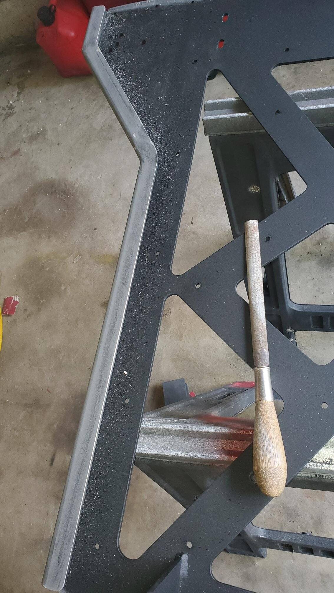

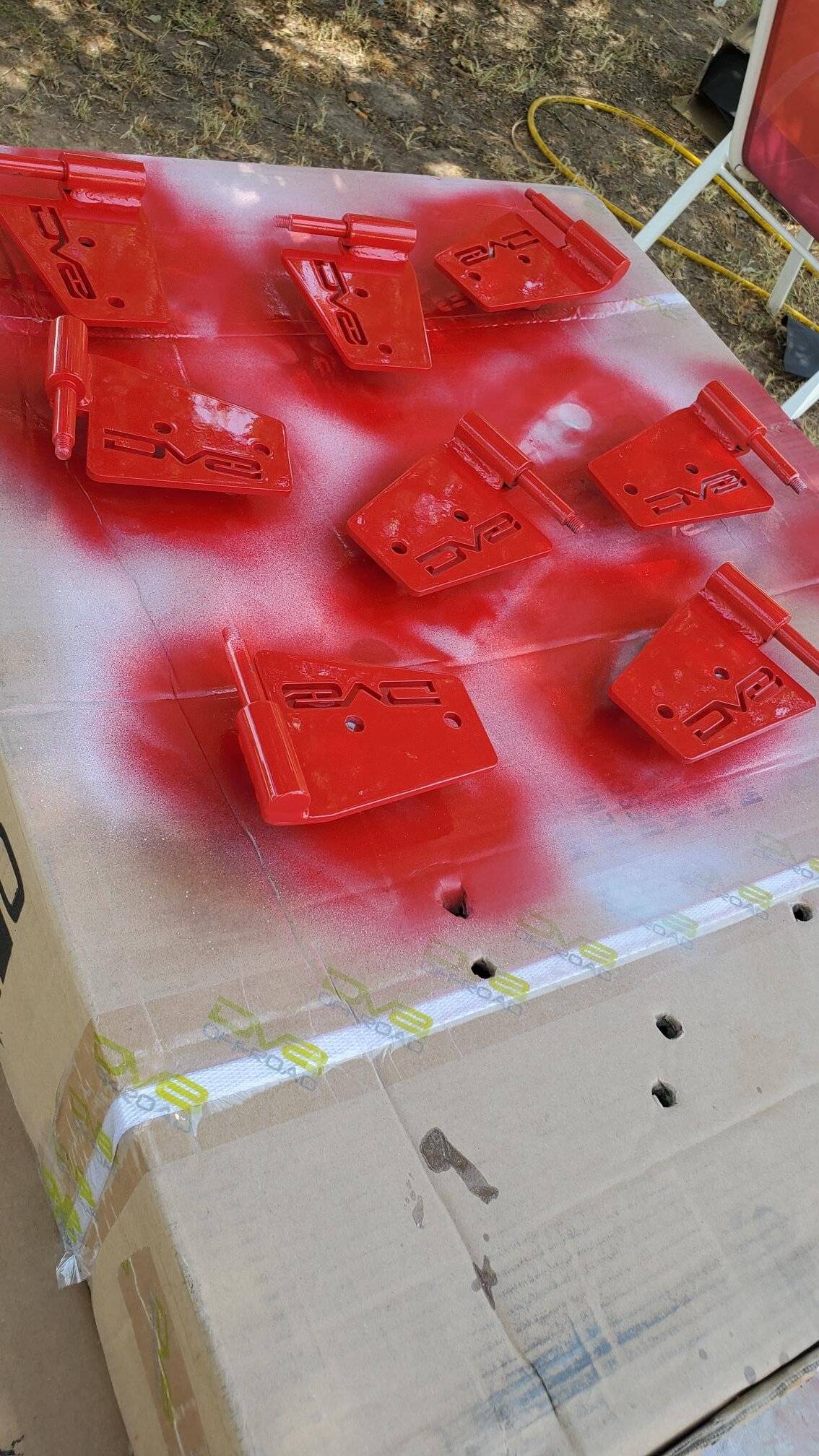

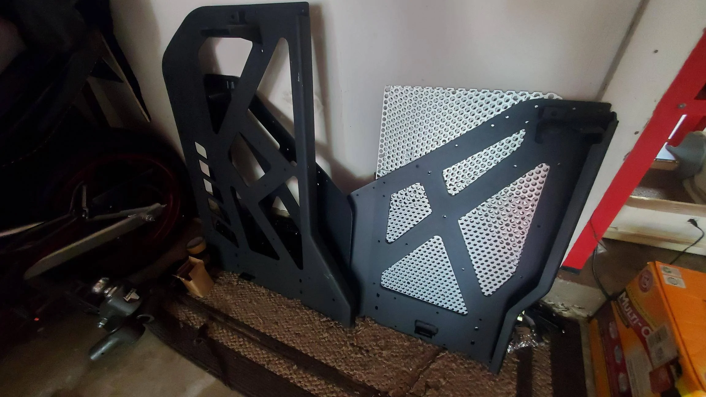

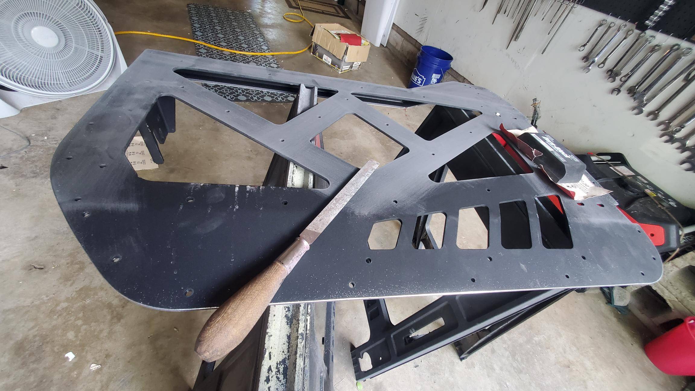

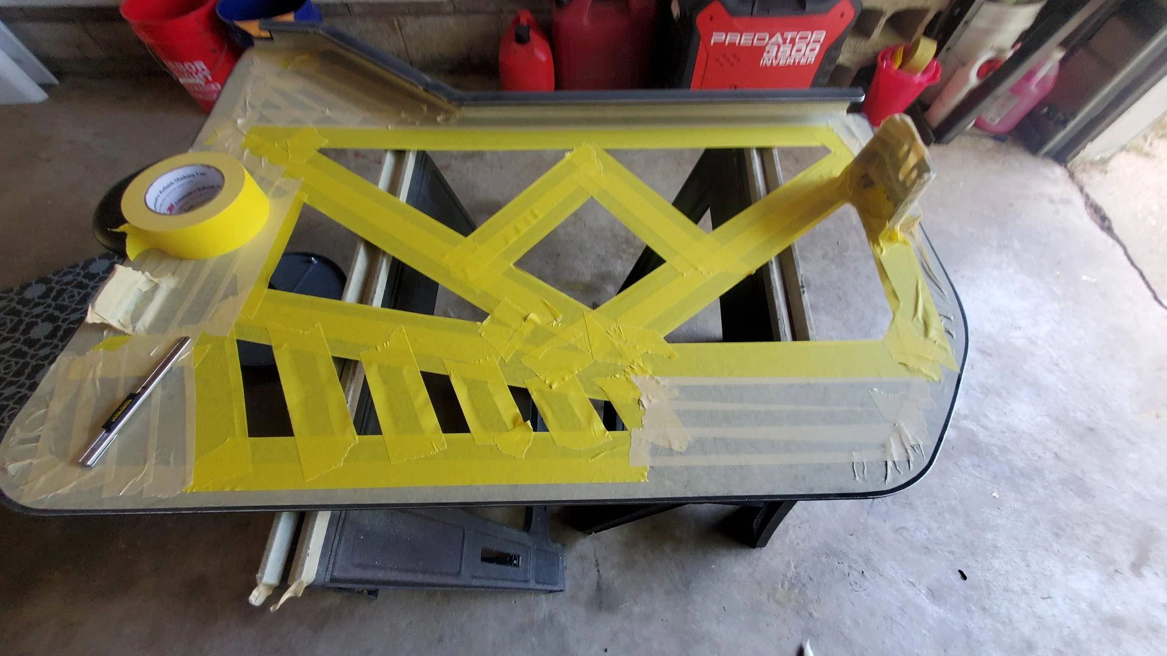

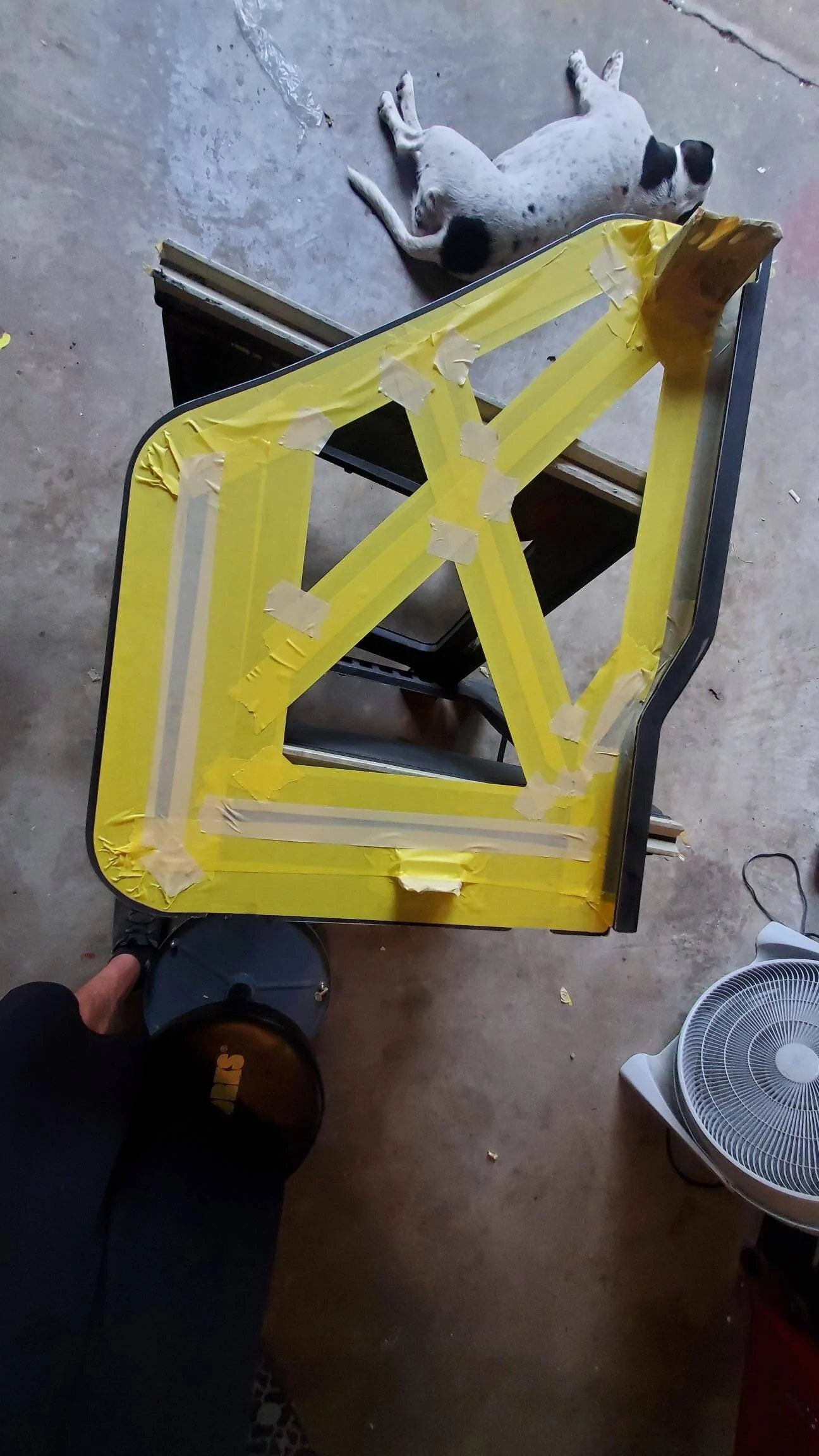

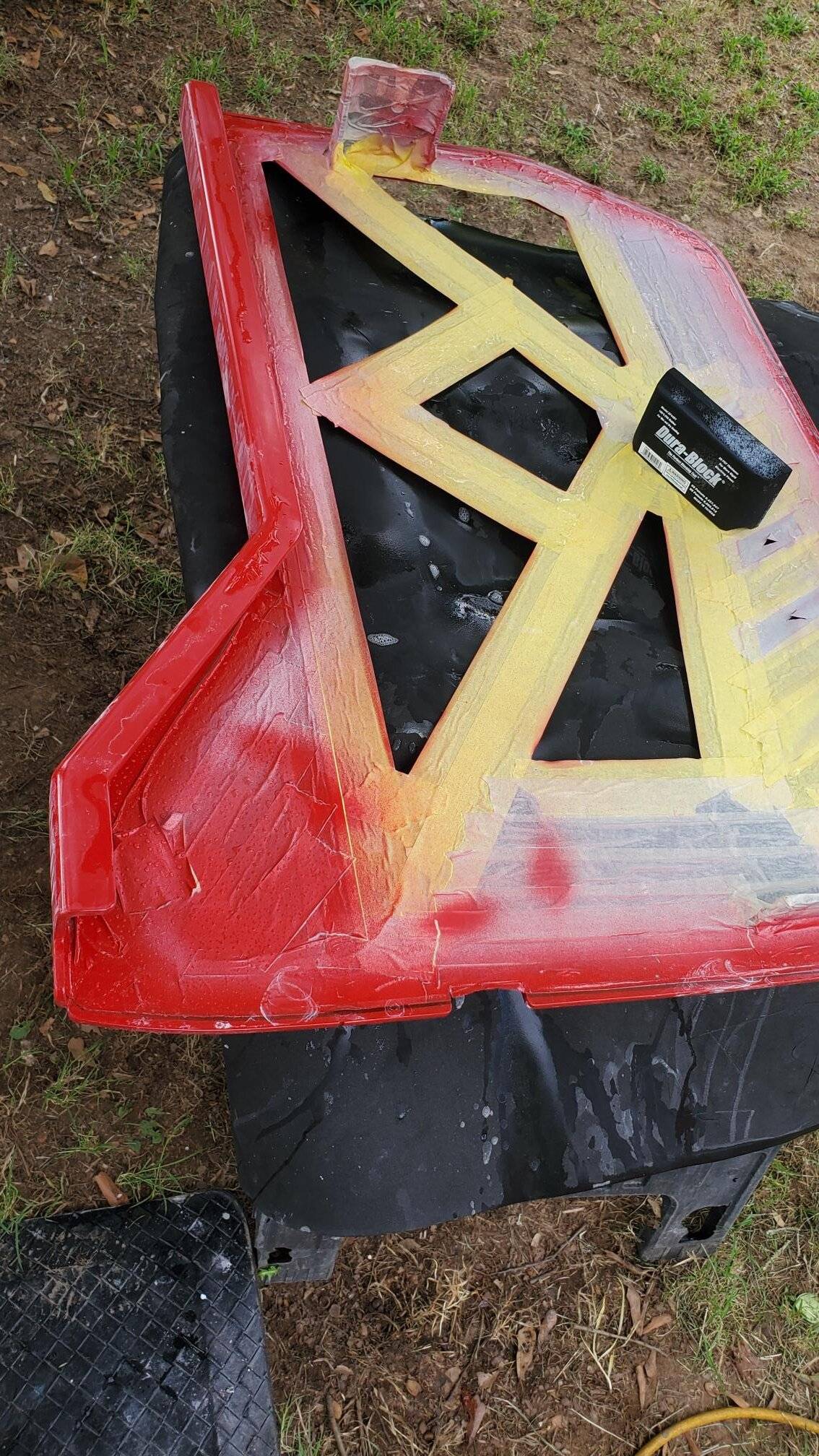

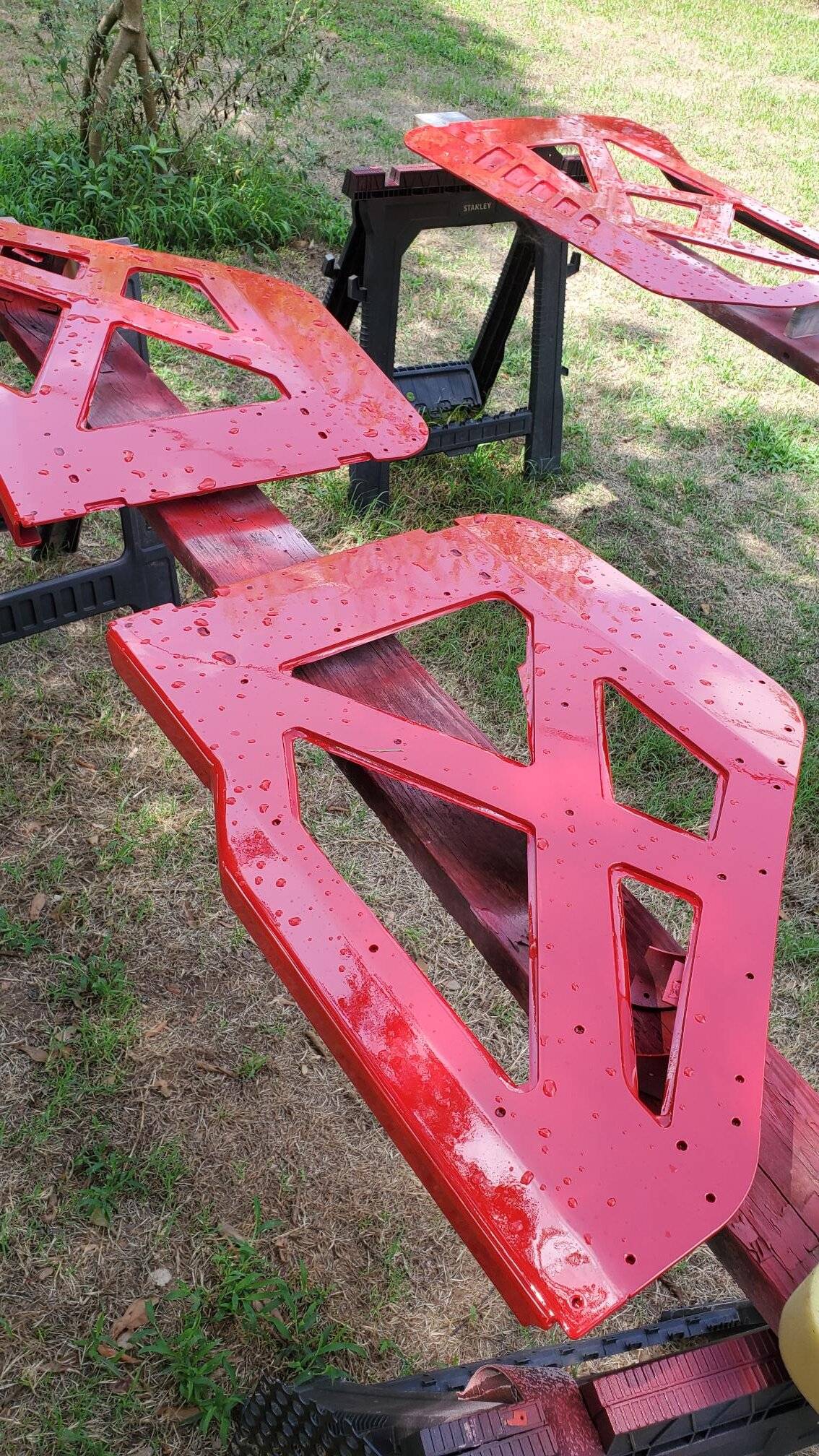

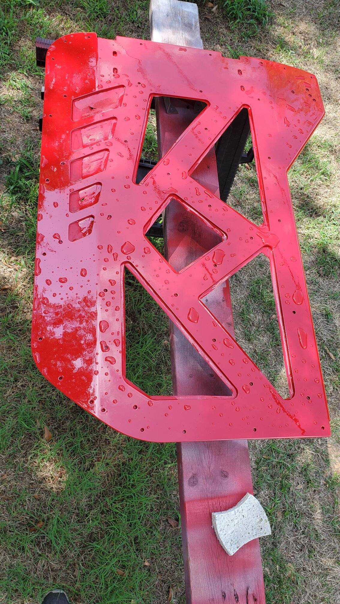

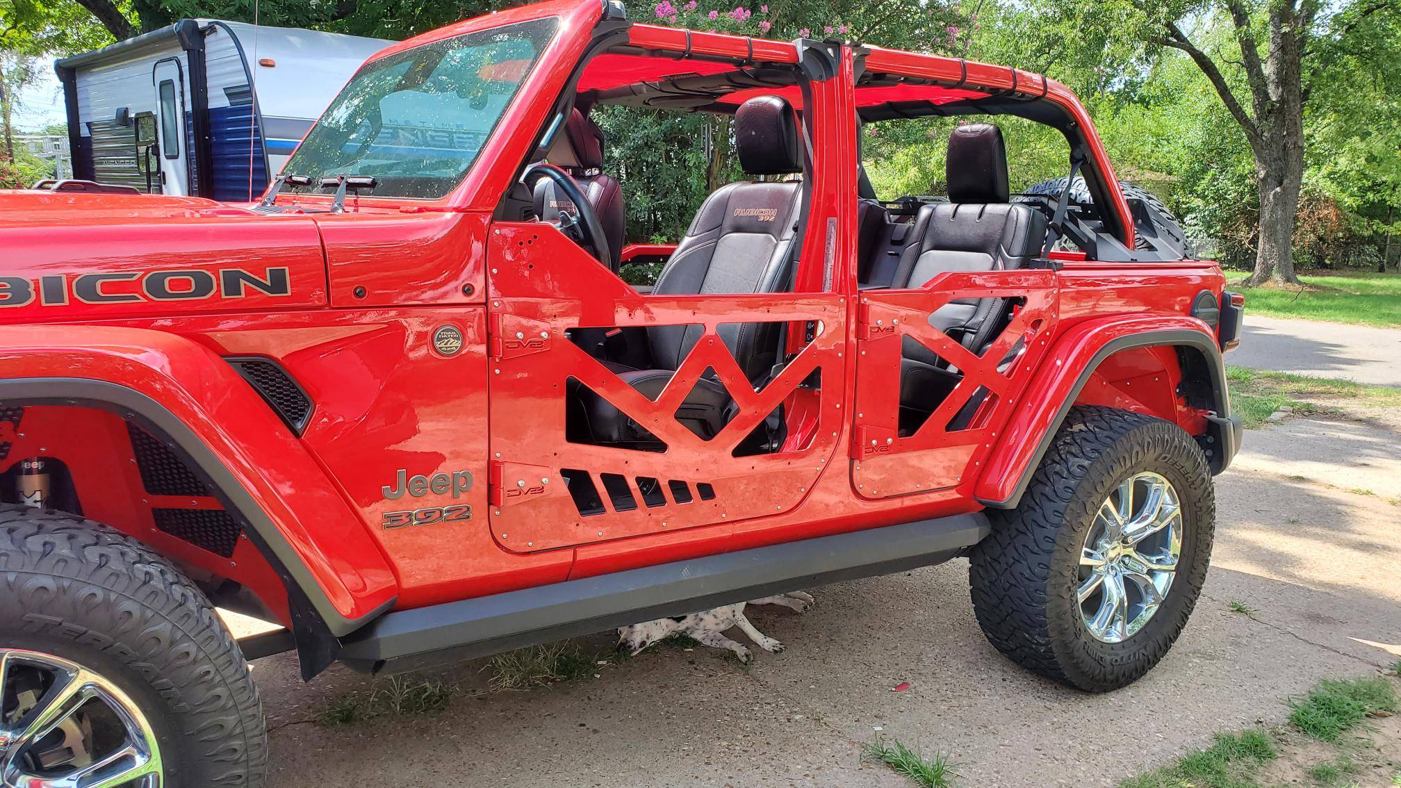

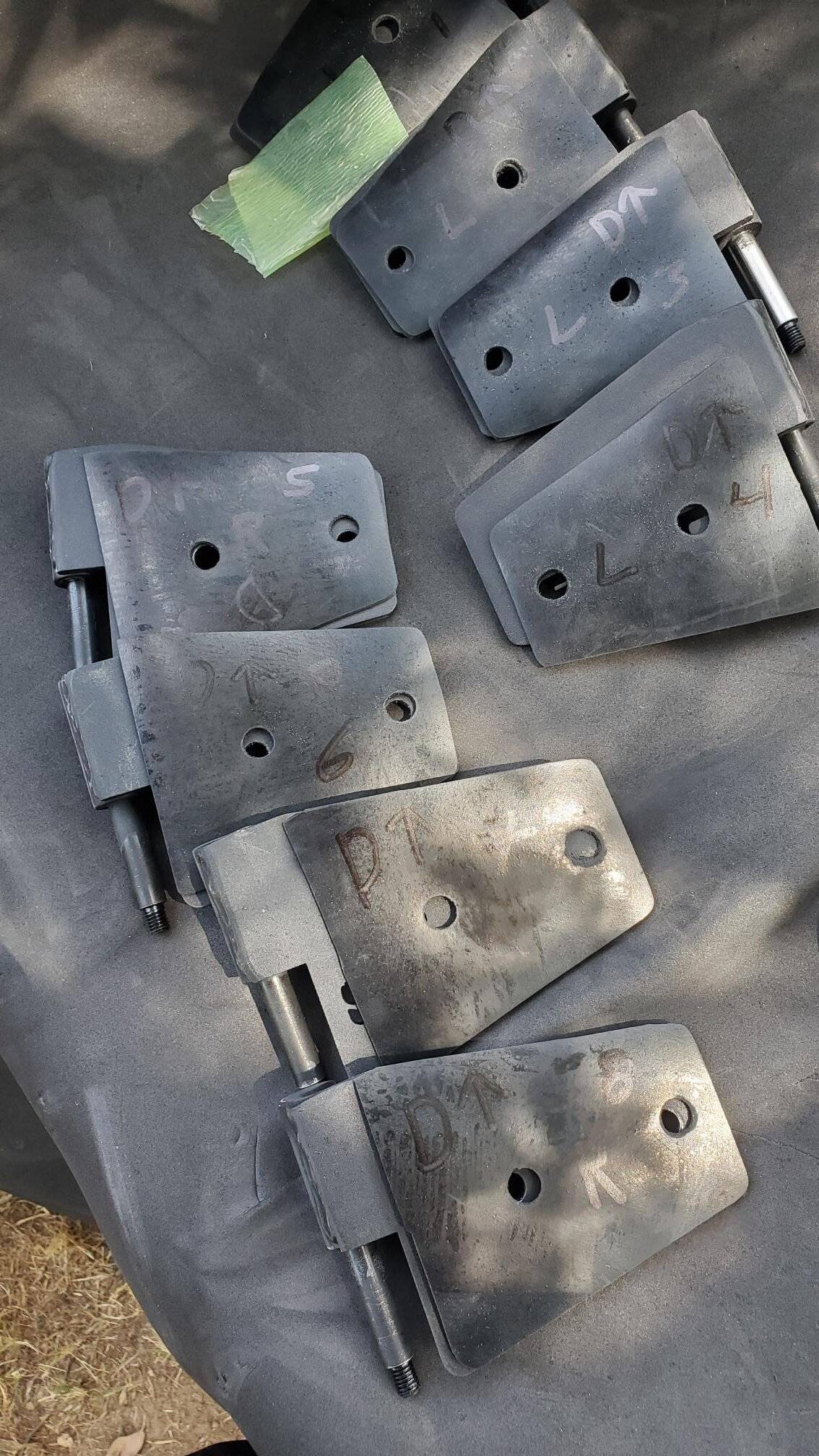

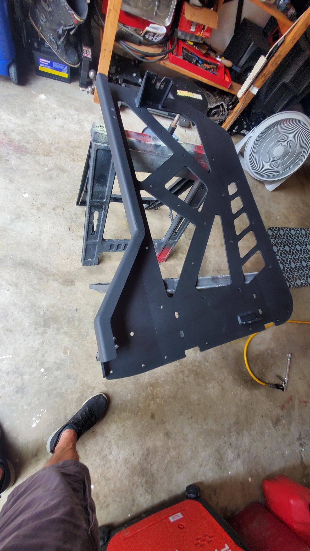

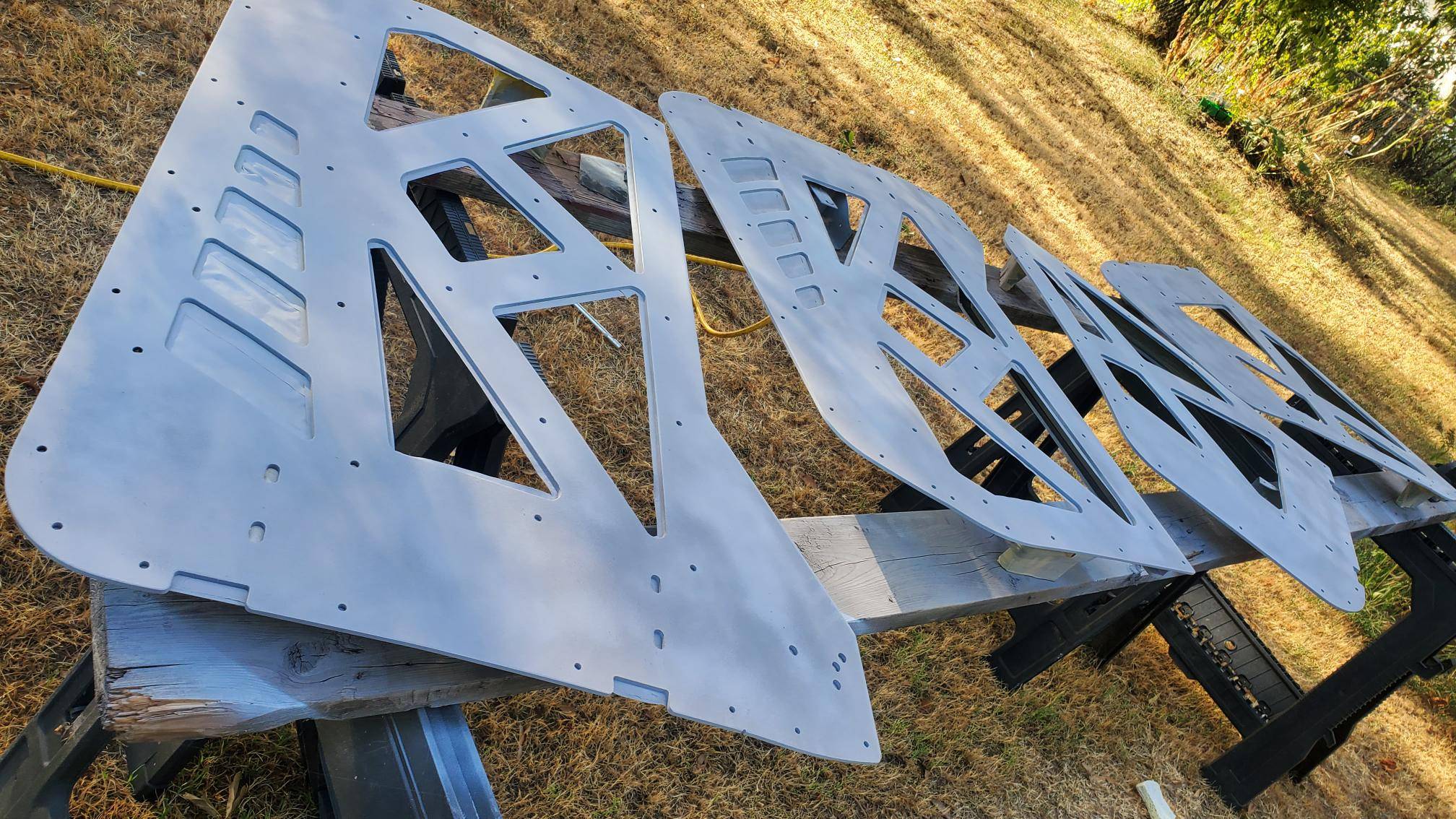

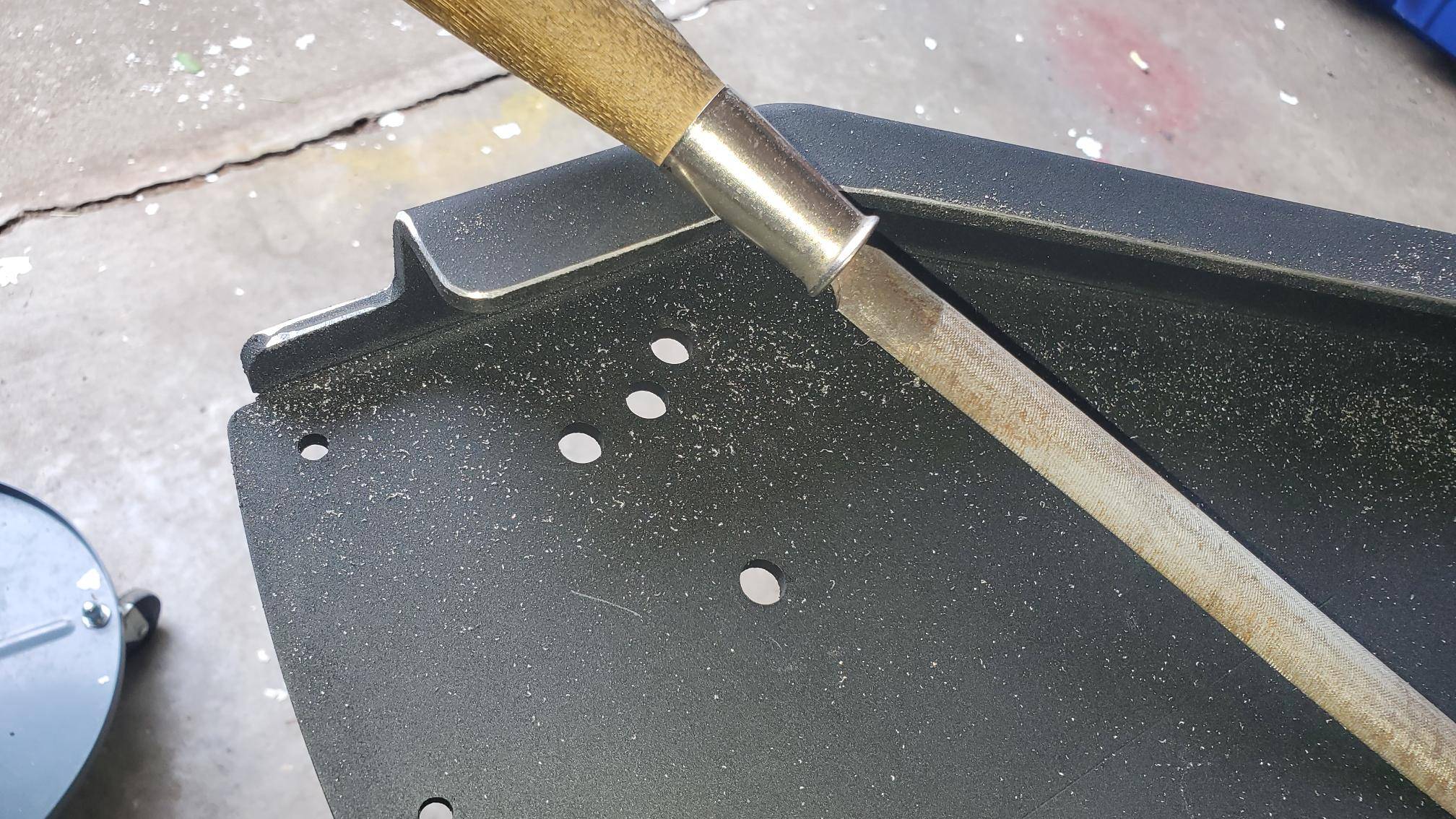

Finally got around to spraying the DV8 half doors to match the inner fenders, had em boxed in my livingroom for like 2 months.... Some of the pics don't have the screen mesh installed, i.e. the pic with my dog (Joleen, aka JoJo). I had just put them on for the first time. I wanted to see what they looked like and it was just easier to align the doors without the mesh.
Ultimately I prefer the mesh, it helps keep things from flying off the seat and into the street. This the main reason I didn't get the rock doors or roll bar doors. Also wanted to keep the door interior black, so lots of taping was involved.
Lots of prep work, started with removing any burrs. These are stamped aluminum doors so there were some sharper areas, nothing bad though, just want everything smooth and paint sticks to rounded out areas vs. tight 90* angle stamping cuts. Then the etching primer, regular primer, sanding, priming again, spraying color & clear. Wet sanding, cutting compound & polishing...
If I were to do it all again, I'd do some things different. Good enough for now though.

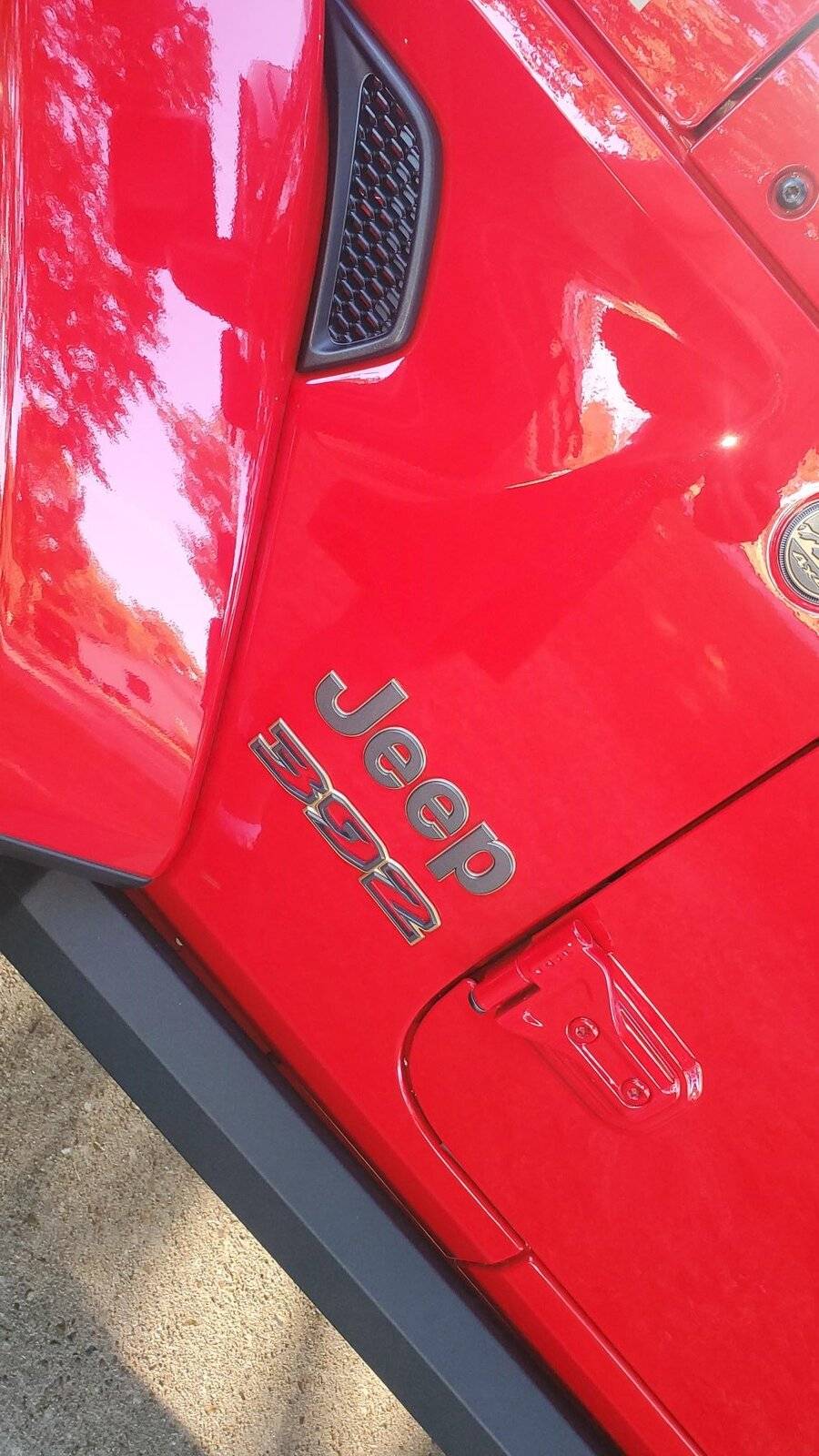

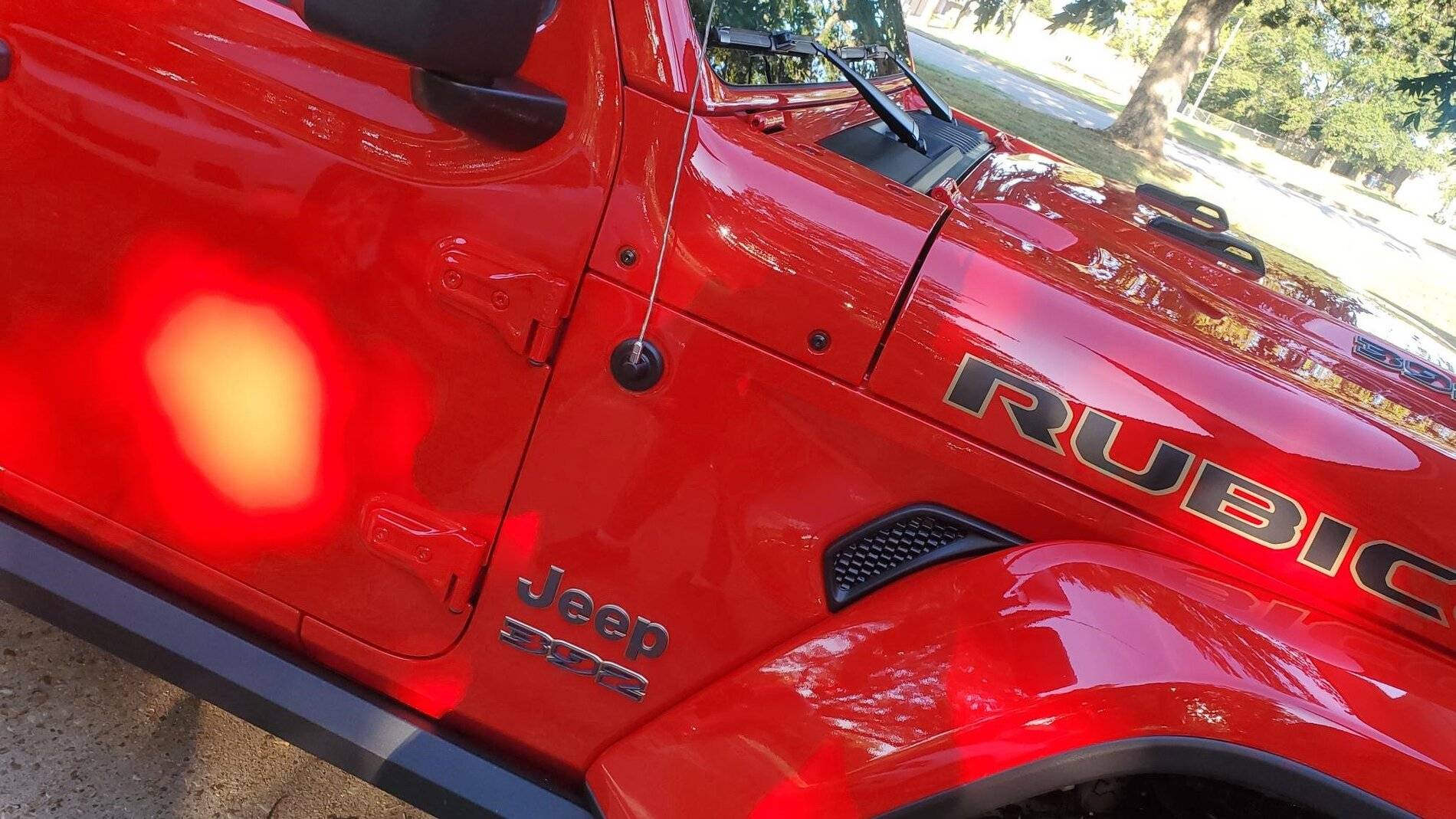

Curious how you fastened these after removing the pins?
I ordered them right from the dealer like back in June. There are two different part numbers, one for the left the other is for the right side of the hood. The pins on the back align differently for each side which I didn't know so my right emblem was on back-order for months when I could of just ordered two left side emblems. I ended up cutting the pins off the back anyways....

Probably 3m vehicle tape.

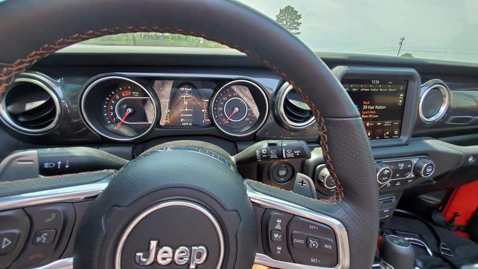

How to you engage turn assist. I see that it is available in teh instructions but they don't say what button it's mapped to or how to map it or engage it.
Hold down the Right arrow button and then one of the 3 quick set button options (cruise up, cruise down, and the right one (don’t remember it off hand). When you press one of those (still holding the Right arrow with your left hand), it will let you scroll through the available quick set options (and TurnAssist is one of those). Once it is set, as long as cruise control is off, press the button you just programed and you will see it say it’s on. Then once you turn full lock to either side, you will hear the ABS pump going crazy trying to hold the corresponding tire still.
