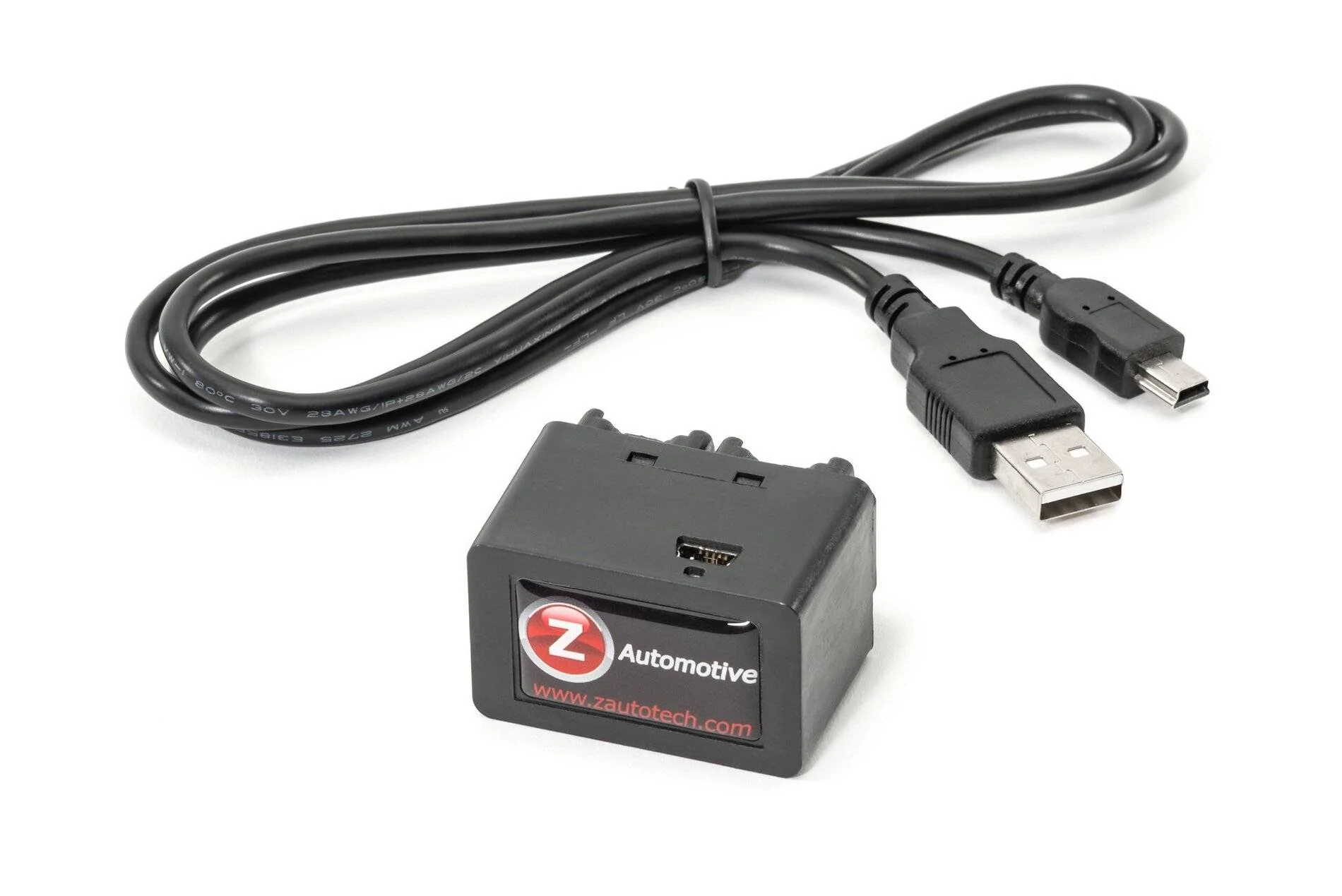

An Excellent Investment, the TAZER Mini!!!
As I have slightly oversized tires (from stock 33 to 35") this the primary reason I purchased a Tazer Mini. I'm sure some of you have heard of this device, but if not... This device 'reprograms' the vehicle's speedometer and shift points when plugged into the Security Gateway Module (SGW) located just above/behind the OBD port.
As an example... Prior the Tazer Mini install while having my oversized tires on, when the speedo says I'm going 80 mph in reality I was doing ~ 88mph. However, this little gadget does much much more. (From their website [Zautomotive] I'll copy/paste some of the other functions below.)
But real quick.. it does have a function to disable the front wheel drive, or rather, have only rear wheel drive on, so, I had to try it. On a back street at a dead stop I romped on the gas and Holy $hit!!! I started to roast my tires as the 392's ass end dropped! Now I only did that just once to witness a Wrangler actually doing a burnout, and a hell of a burn out it was!
With that, I would not recommend leaving that setting on. Maybe give it a quick whirl to witness the same as I, a Wrangler roasting the tires, LOL. I can only imagine doing that frequently would ultimately snap something in the rear end - it's simply too much torque. For race, the 392 launches much quicker in 4 Auto, but it's still pretty cool to see.

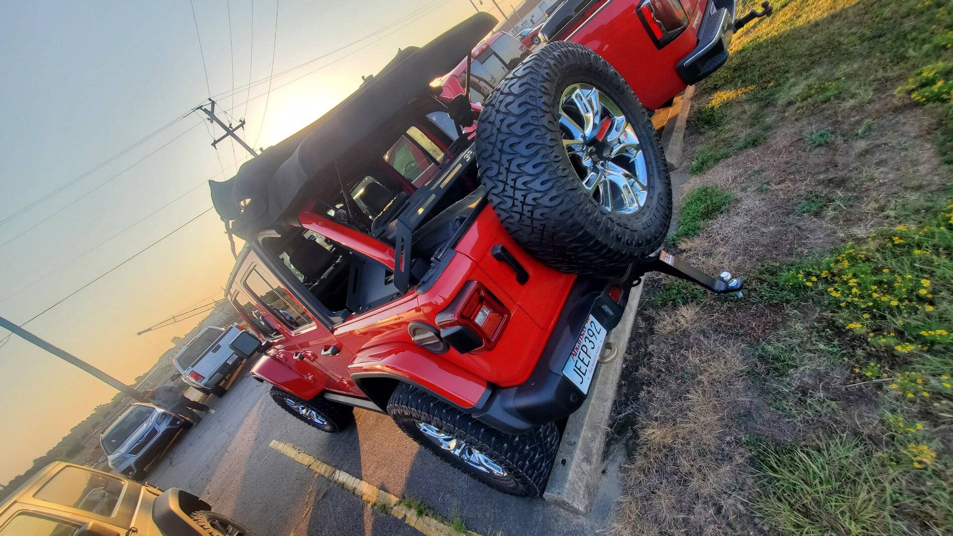

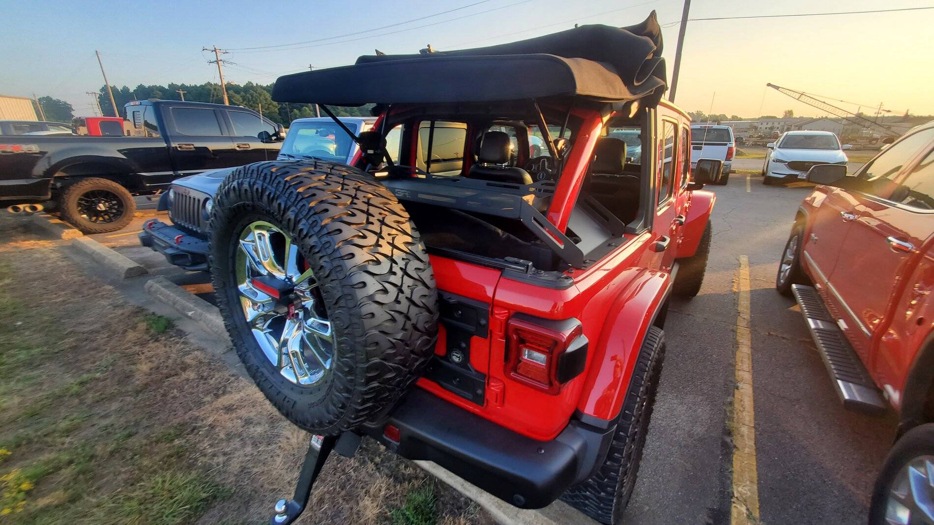

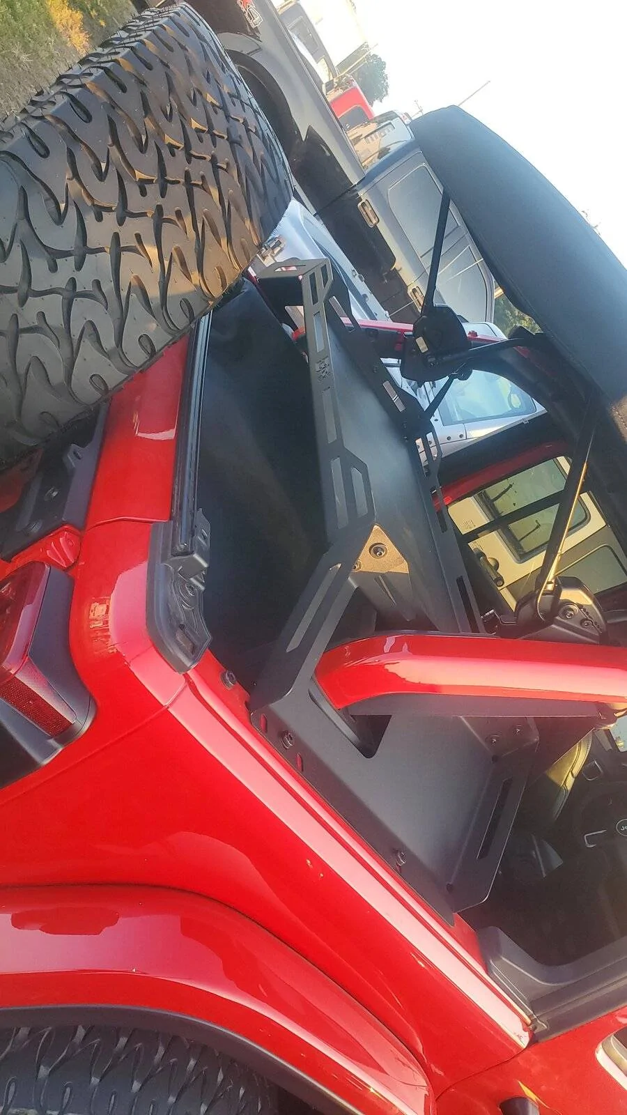

Installed a rear cargo deck. The primary reason is to detour thieving hands when the soft top is 'off' (or on for that matter). I have a nice 12" sub and amp back there, and although I have a high-tech security system with a proximity sensor, that is not enough to keep someone from grabbing the sub box and take off running. The cargo deck would slow 'em down a bit I'd hope, at least giving me enough time to react as the FOB on my keychain starts freaking out. I have also found it nice to set stuff on as I dink around the vehicle, primarily my beer ;).
The only downfall is the inability to completely lower the soft top. Now if I did some custom work I could make that happen, maybe down the road.

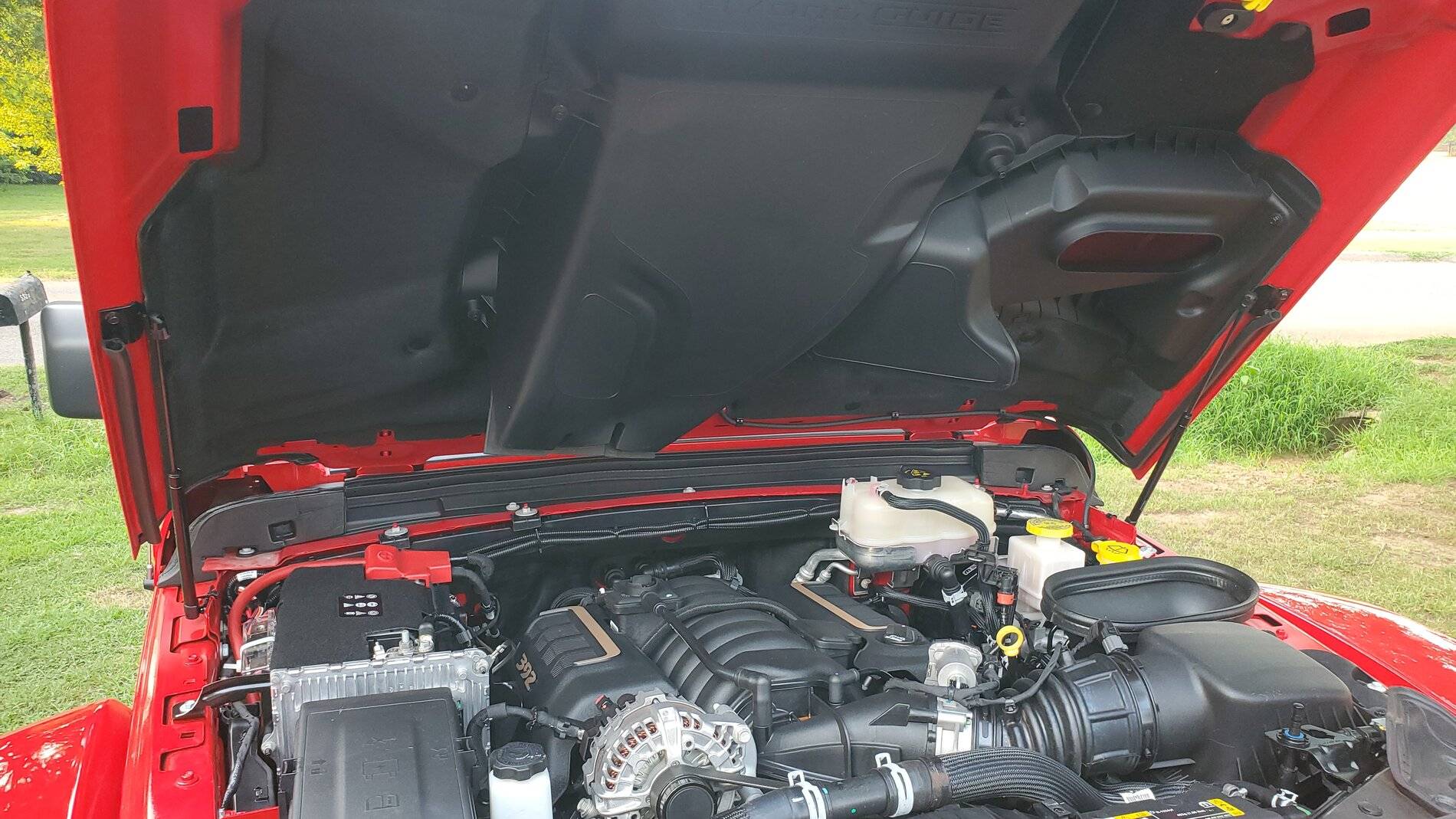

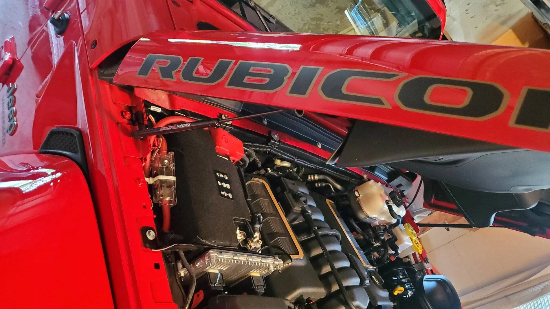

HOOD LIFTS! A nice little add-on. From Redline Tuning I installed gas spring hood lifts. Redline Tuning makes these lifts for Wranglers but also for the more specific 392 as the hood is a bit heavier having the HydroGuide. I did a little video to see them in action; however, I'm unable to upload the video, wrong format I guess [mp4], or, this site does not allow for short videos.?.
This raises the hood about 3 inches higher than when using the rod/prop. About a 30 minute install.
Redline Part Number 21-20007-02
There is a little mod that has to be done on one of the factory brackets under the hood, with a Dremel I cut a little section off the edge of a black bracket that's attached/bolted to the right fender [see the silver bolt] to allow for clearance. Not a big deal, you're not cutting into anything expensive. You can kind of see the cut on the bracket [bare metal]. The bracket is in front of the battery, in front of the in-line fuse for the sub/amp.
The hood opens up nice and smooth. I actually appreciate this little add on much more than I thought I would.
