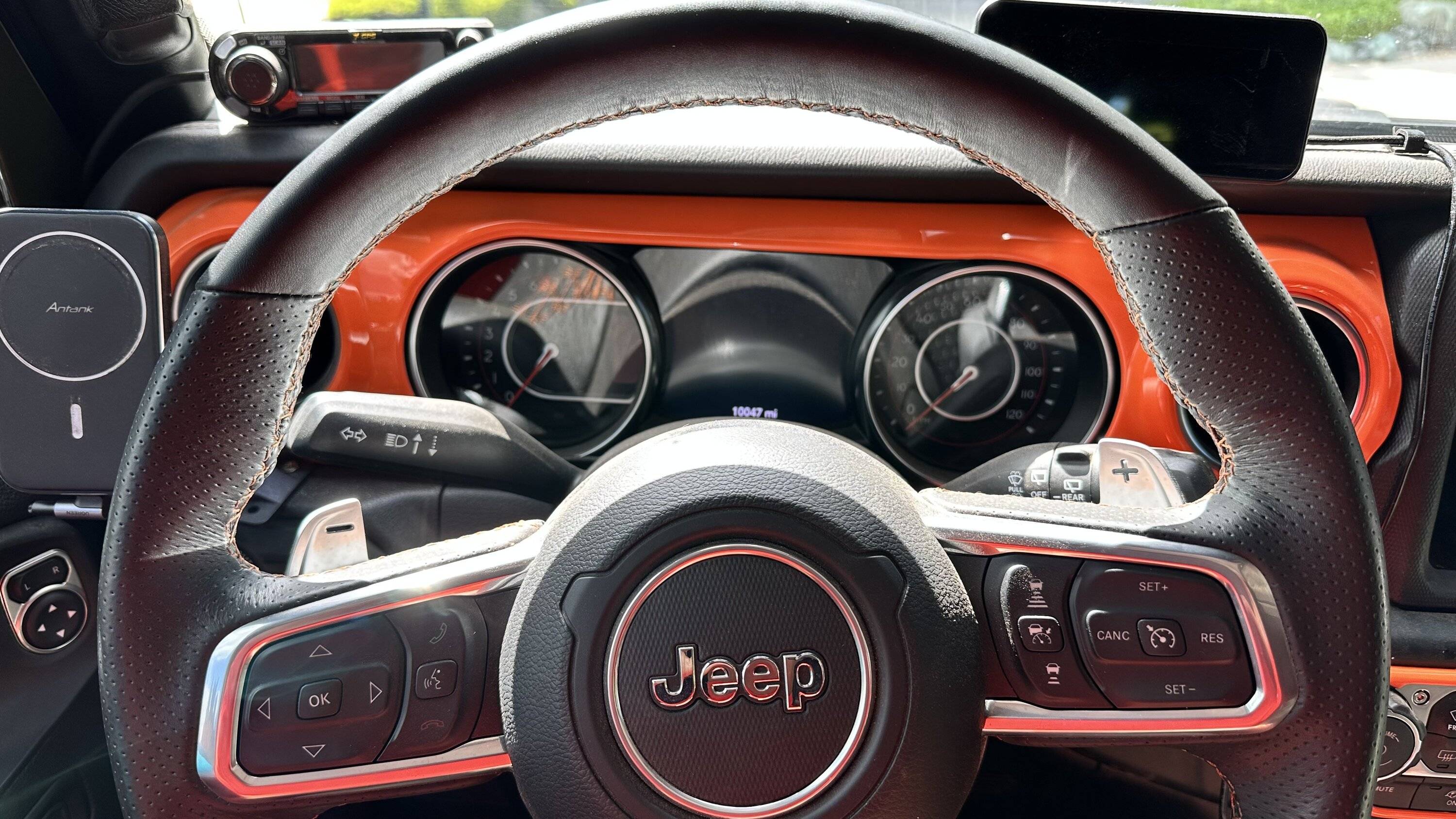

Found this thread while searching for a resolution to my problems.
Wanted to report on what I was missing:
During the sleep cycles, you need to count 60 seconds after EVERYTHING goes black.
I thought everything went black when you open the door, but no.
If you raise your head, you can see that the odometer is still on:
Jeep Wrangler JL Tazer - Increasing Tire Size Not Changing Speedometer IMG_8848
One has to wait 45 seconds for the dash to go black and then another 60 seconds, so a total of 1 minute 45 seconds, and do it twice after waiting the 150 seconds of the Full reboot.
And also don't forget to drive on the freeway for ~20 minutes before checking if your new speed is correct.
