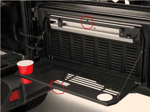

Totally get that and the only things in this case that really apply are #1, 2, and 3 and the only ones I have control of would be #1. I took a look at the tailgate table today and it seems that the culprit is the latches that they have along the top. They are loose even when closed since there is no rubber around the loop used to close the latch. I looked online at the Mopar picture again and noticed that they seem to have some set screw at the top that would help with keeping the table from rattling as well. Not sure if your version came with this since mine didn't and has no holes drilled for that feature. I am going to try and wrap some electrical tape around the latch loops so that when they are closed it holds the table with a greater force.

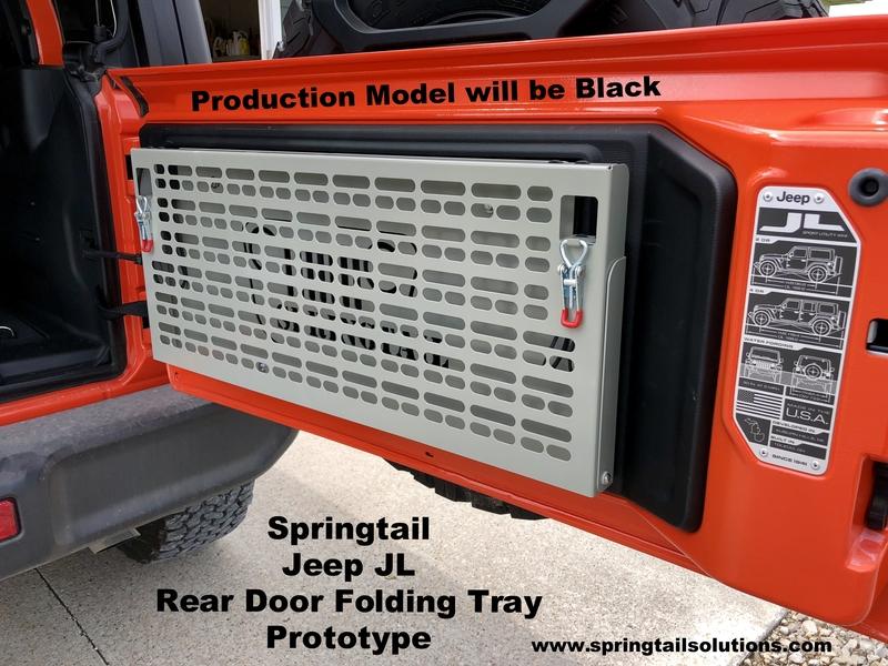

I guess now is as good of time as any to show you what I have been working on....
