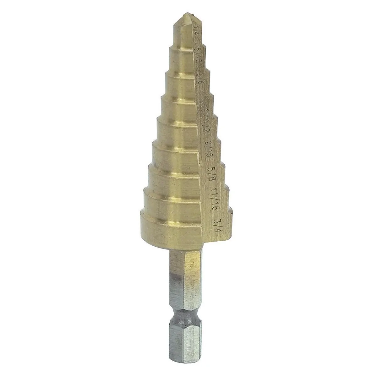

this is the standard switch that comes with any Rigid light bar, the switch isn't lit up when it's off so there's no power draw, it just lights up like the images when it's flipped on
thanks! I started with a small drill but moved to my dremel tool in order to slowly widen the hole until the switch fit in snug without making the hole too large
Thank you!

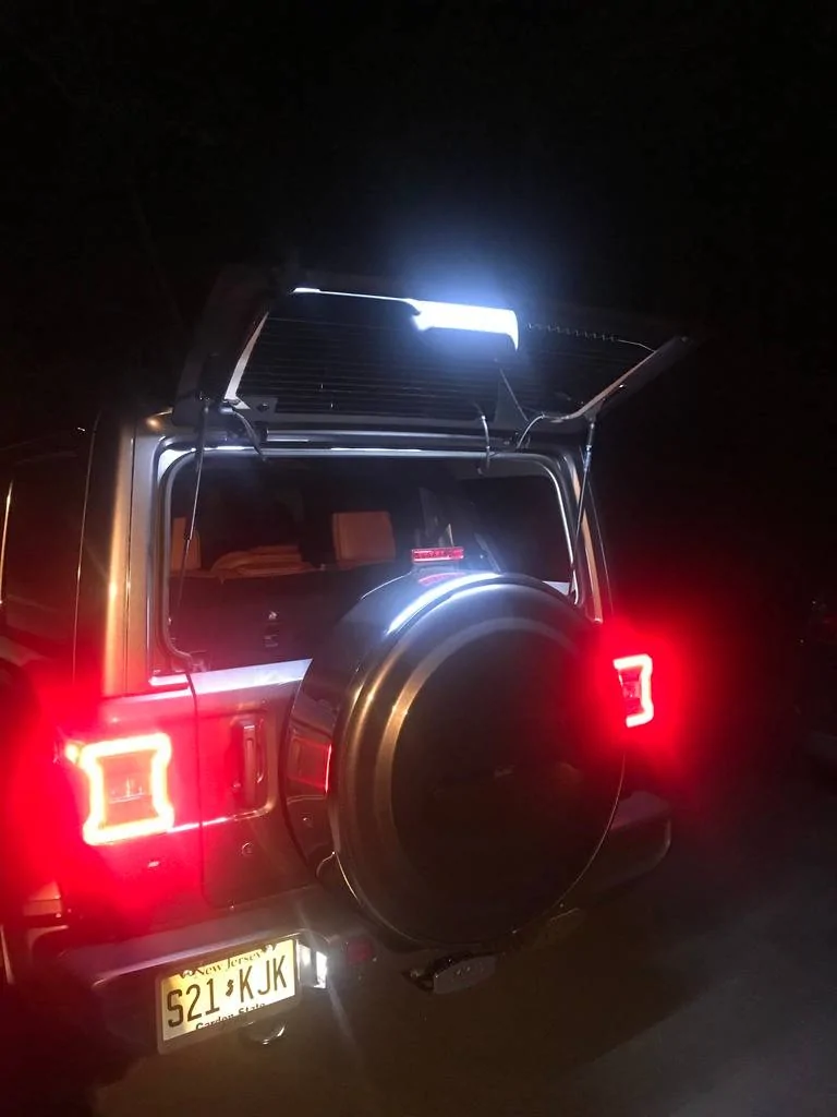

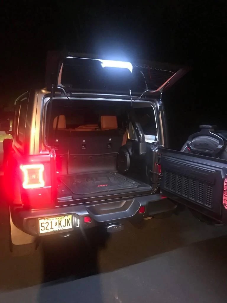

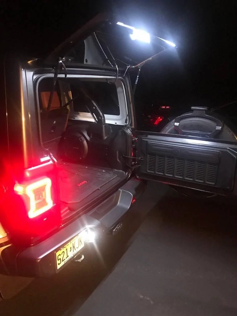

This evening I installed the Brawlee light. I ran the cable through the hard top channel. I am going to install a Rigid Industries rocker switch this weekend, I didn't have a dremel to use. I also used additional 3M tape in between the existing round tape it comes with.

That is perfect!!! Exactly what I was looking for! Thanks
Make sure there’s room behind it and you don’t hit some wires or whatever back there . :like:

Agree 100%!! It was kind of tough finding a spot with clearance behind it a lot of spots don’t have enough room.
