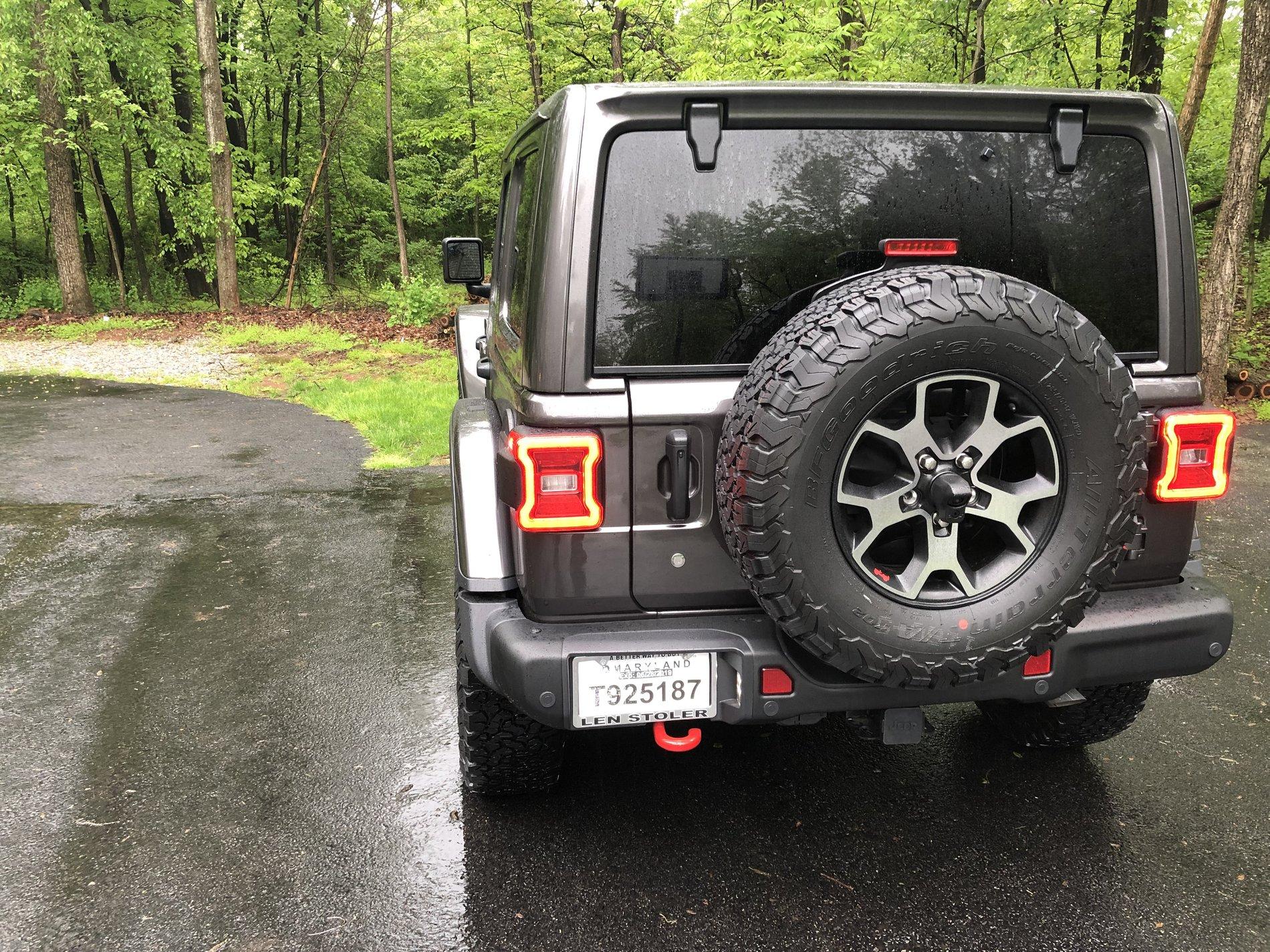

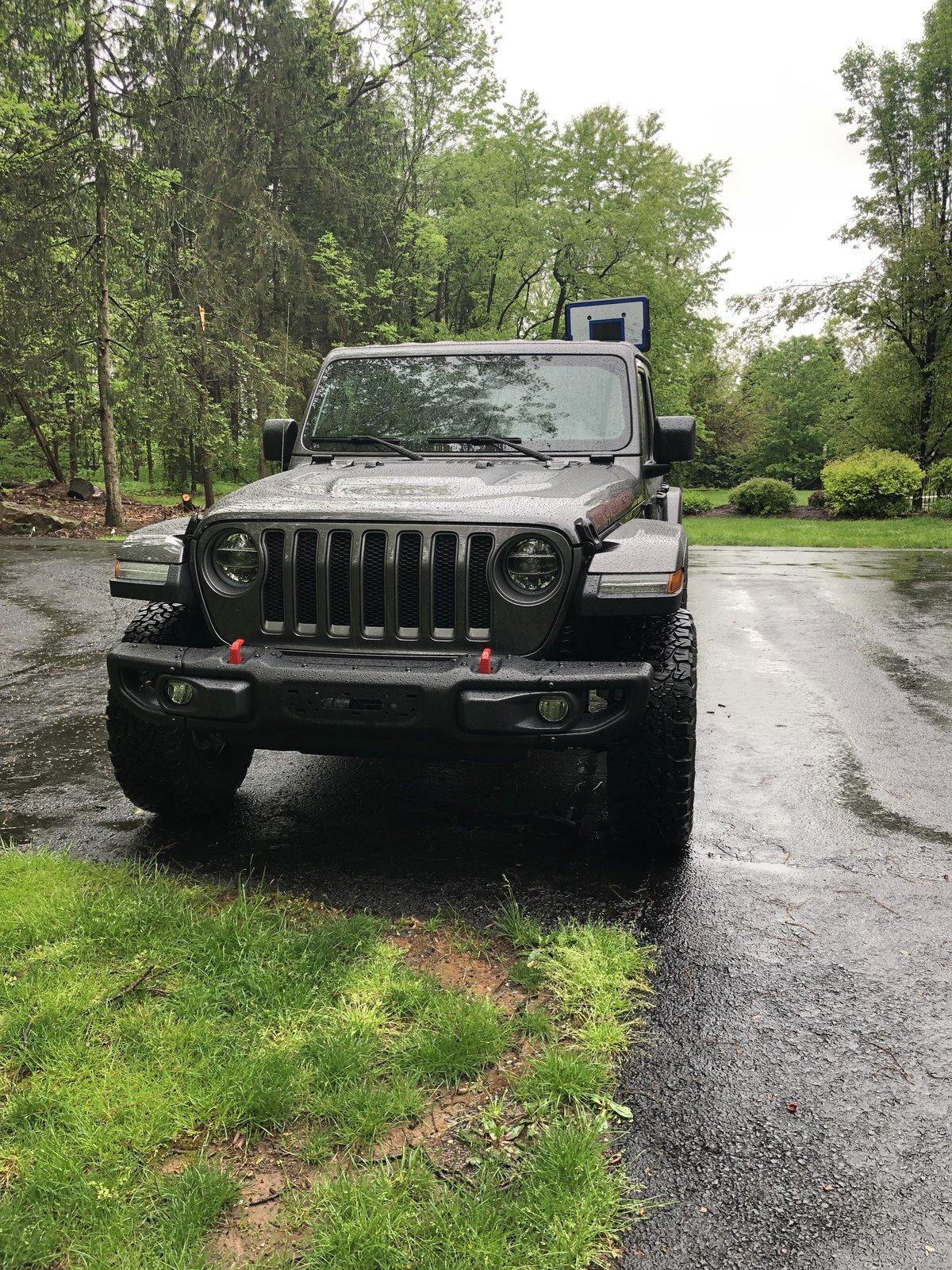

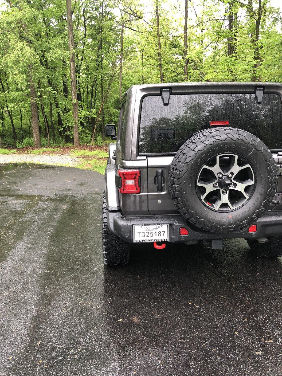

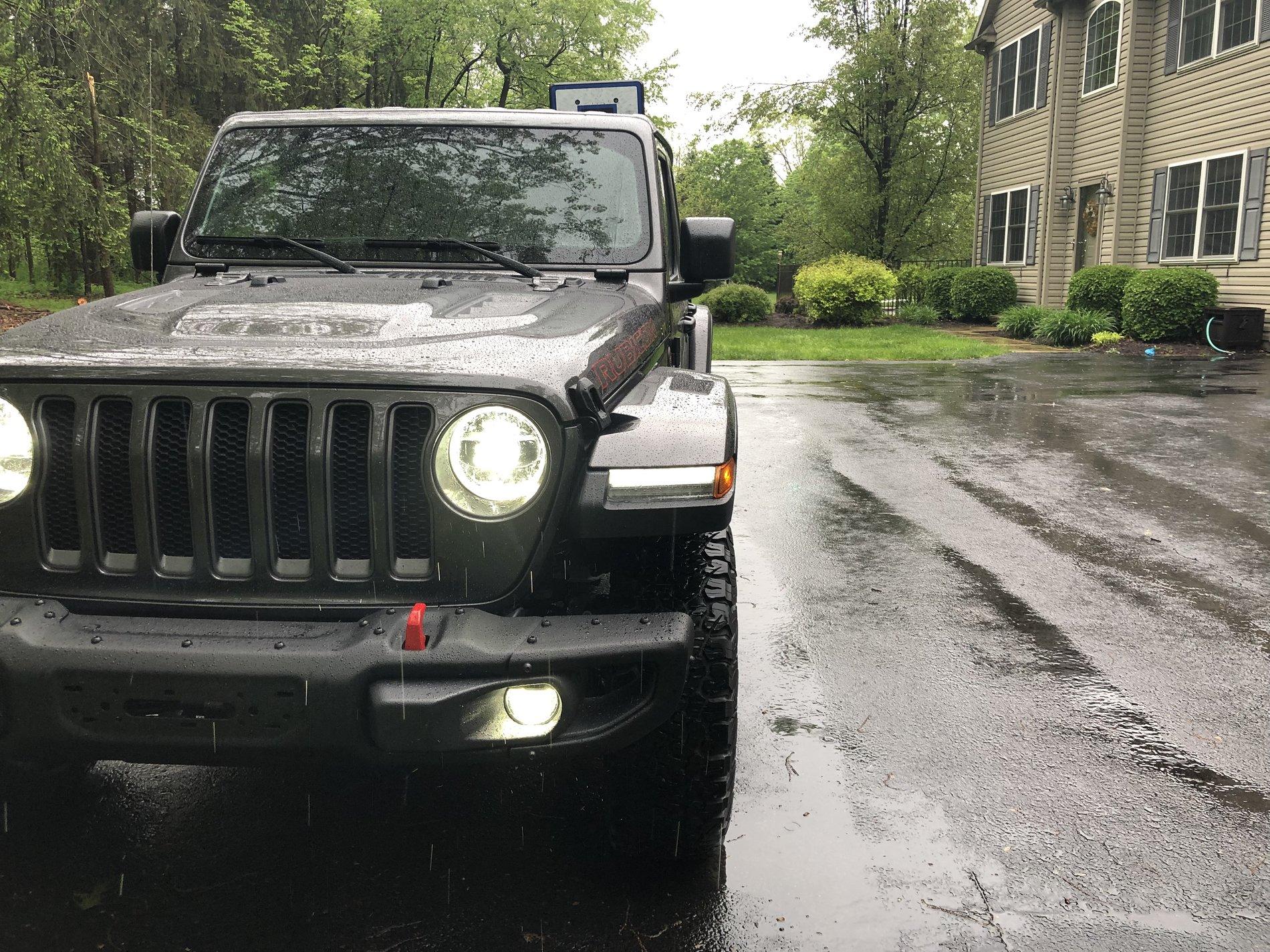

I have Synergy 1.75" spacers. Give a great look, and a very slight change to better steering, especially on turns.
I think anything less than 1.75" will be hard to install on Rubicons or I might be wrong.
