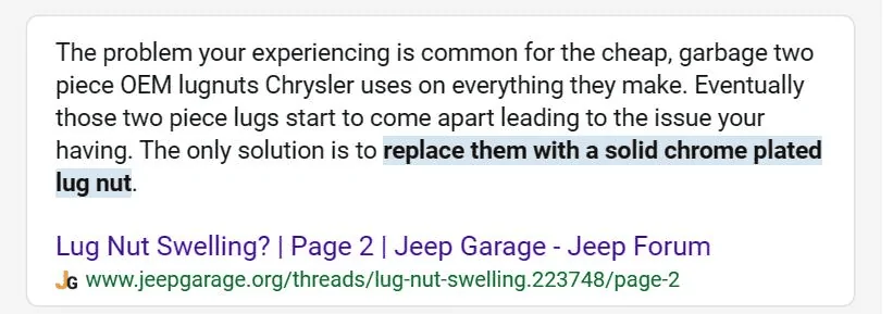

My LUGNUTS are swollen!
Not having heard about this until today, I did some research, and it seems to be a common problem, JEEP.
I went to get my tires rotated and balanced and was told that I had this issue. Not having heard about it before, I contact the dealer, O'Rielly's and Walmart (3 distinctly different businesses) and received the same answer: This is a problem with the stock CHEAP lugnuts on my 2021. I was also told other vehicles have had similar issues.
