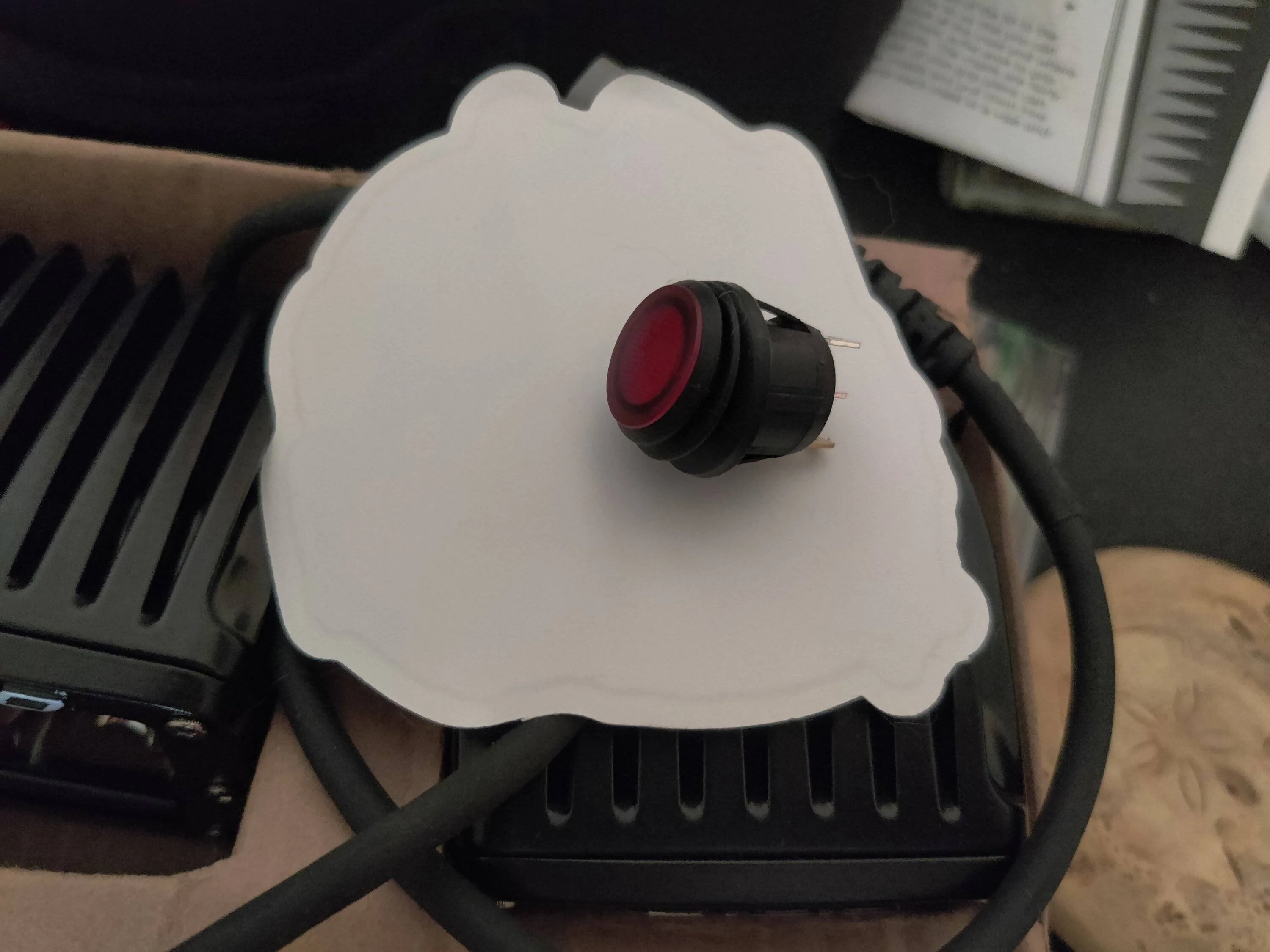

Hello all.
I picked up some Rigid 3" cube spot lights at the jeep invasion on Thursday. Have DV8 brackets coming. There are no instructions with them ( longer story) I mean install is easy I can do that. But as far as where you come through the firewall with the wires and through the top there's nothing. Probably look for a video.
I have a question though. They came with a supplied switch and I don't have any kind of a controller yet. Question is where have any of you mounted this switch? For anybody out there that used it. I can make a bracket but was curious what others may have done.

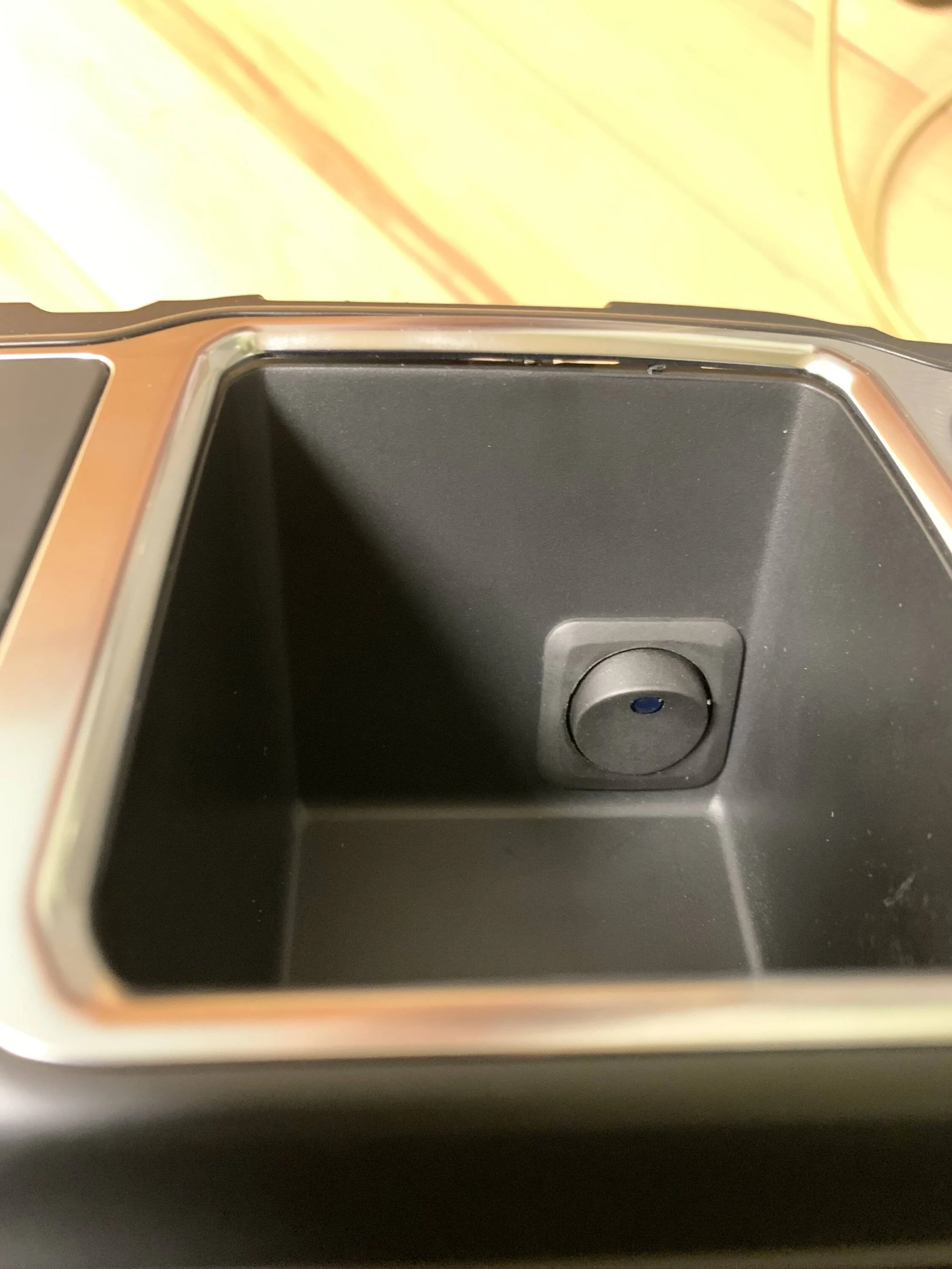

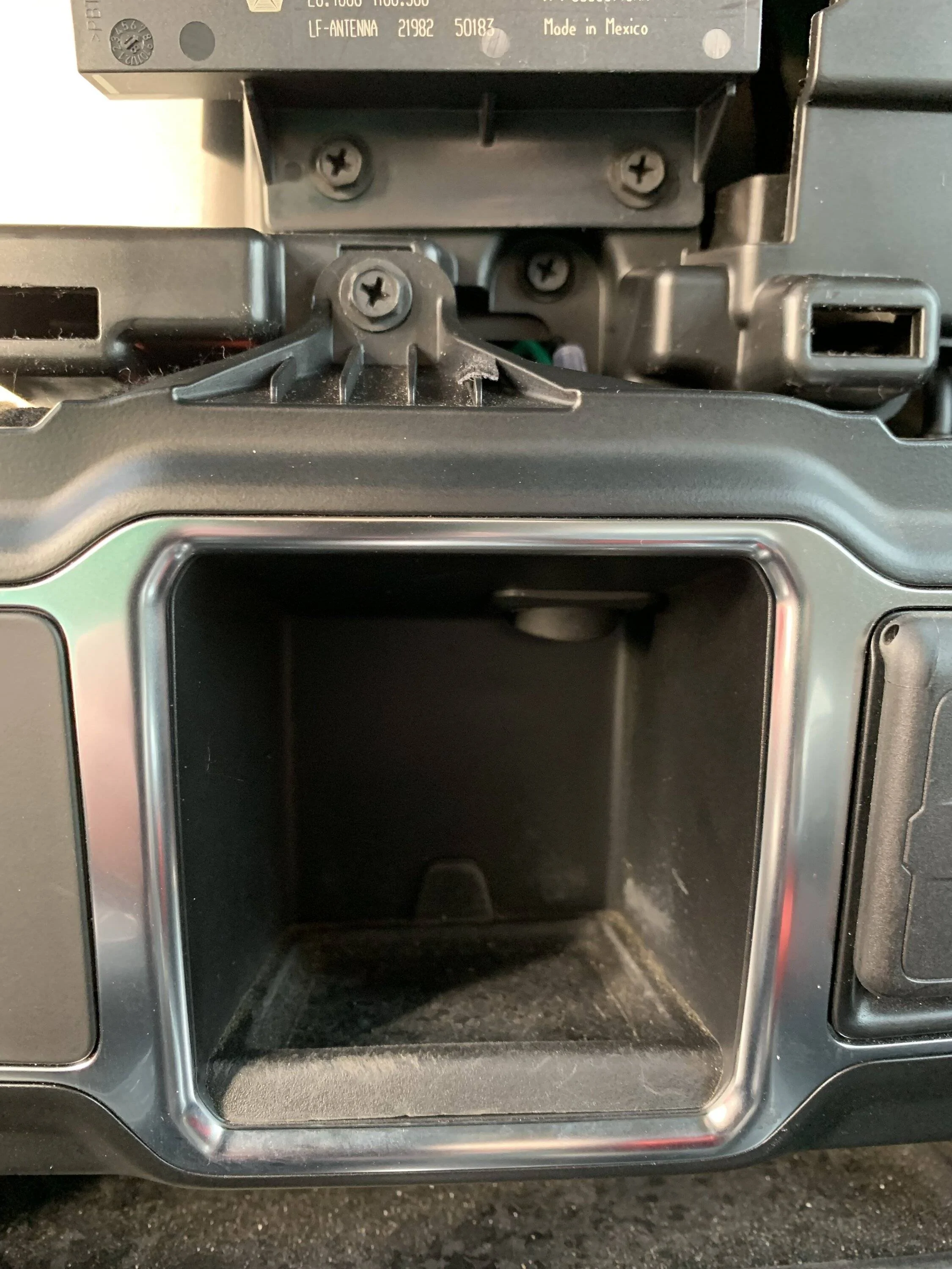

If your JL is an automatic, there's a plastic plug on the firewall below the brake booster. You can pop that out and drill a hole in it to feed the wiring through then snap it back in.
As for the switch, I'm not sure if you have power windows, but I don't. I mounted my switch on the top of the cubby where the window switches would be.
Jeep Wrangler JL Switch placement IMG_4477
Jeep Wrangler JL Switch placement IMG_4480
I thought about mounting it on the trim panel under the steering wheel or a few other locations, but there's a lot of stuff going on behind the dash. Definitely look behind and make sure there's enough space to route the wires and switch before drilling. Good luck!

Placing it in the cubby was a place I had not thought of. Although with the wife she might stick something in there, turn the lights on and I will be running down the road in the daytime with the lights on. So I will have to think about that placement.
I may also shop for a switch bracket.
