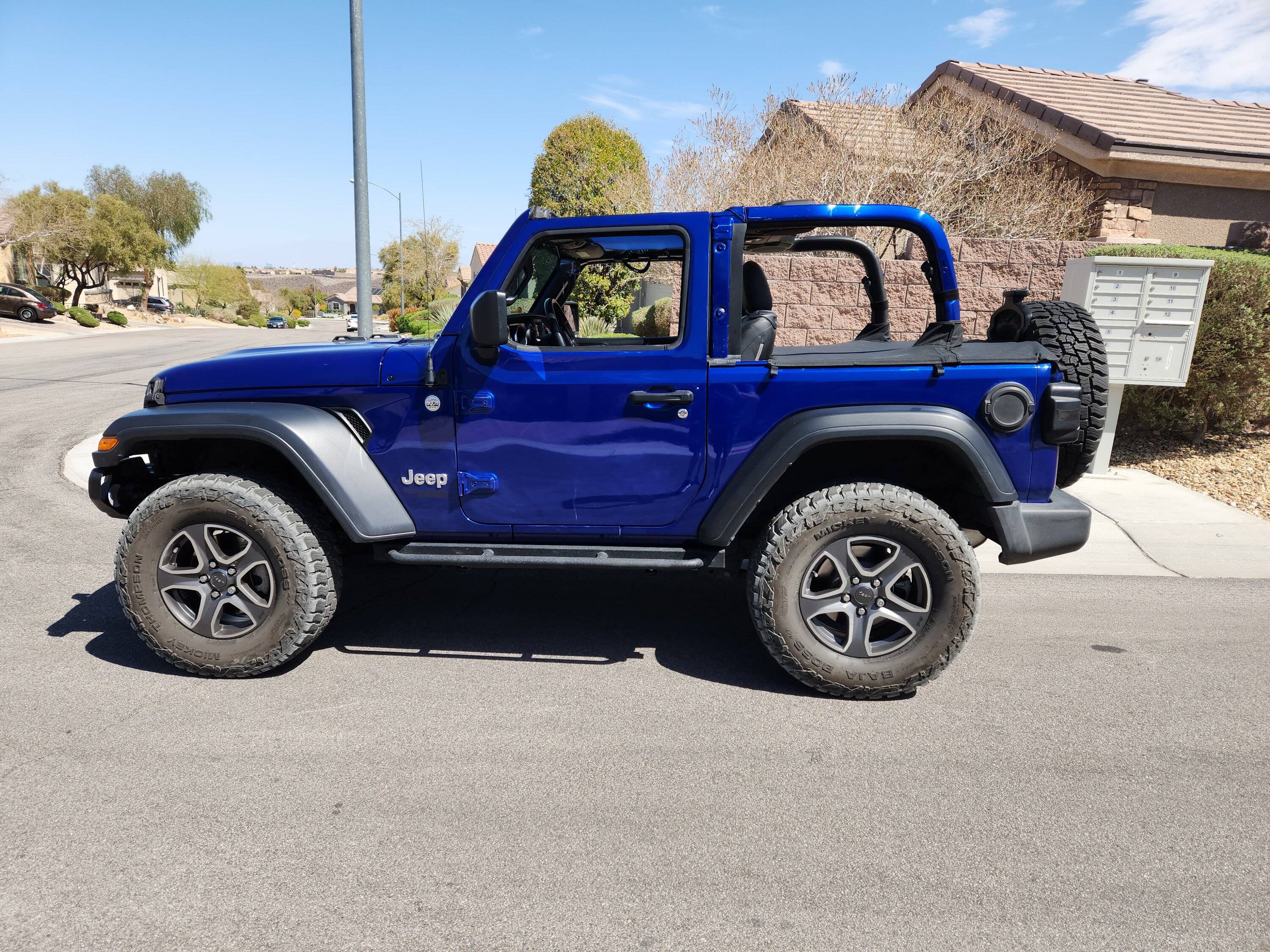

I installed a brand new (>300miles) Rubicon Recon (4 door) suspension on my 2 door sport s. 2.0t hard top & tow package.
stock spring pairings:
591/592 & 109/110
Rubicon Recon takeoff pairings:
661/662 & 228/229
Lifted all four corners equally by 2.5"
Installed the longer LCA's at the same time and the handling is, if anything, a touch better than stock.
Since a stock Rubicon is approx 2" higher then a sport, I'd expect you to only gain a half inch. Check the spring pairings compared to yours and you'll get a better idea of what to expect.
