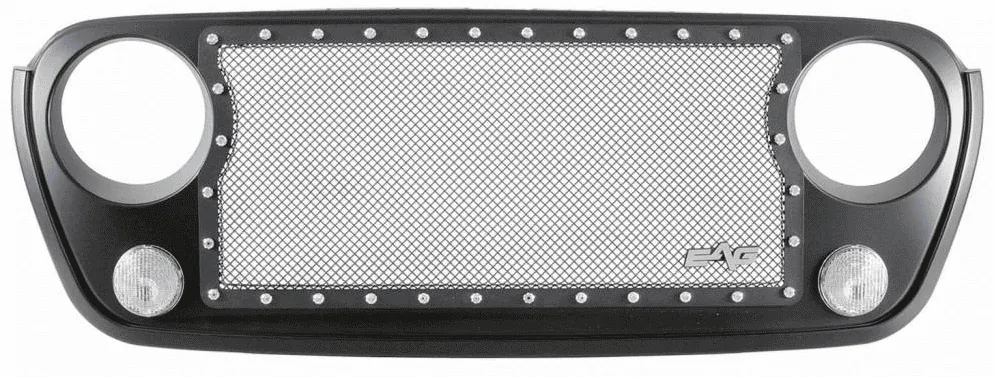

I ended up ordering this one, only because it so crazy cheap ($90). Unfortunately, it was the last one they had in stock.
Jeep Wrangler JL Stylish grills that aren't ANGRY. Do they exist? 1645995667221
Not sure of what to make of the JK fog light mixed with the JL headlight curve.

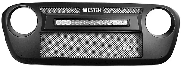

The Westin HDX JL grille looks alright I guess..
https://www.westinautomotive.com/product-detail/34-1115/hdx-led-grille

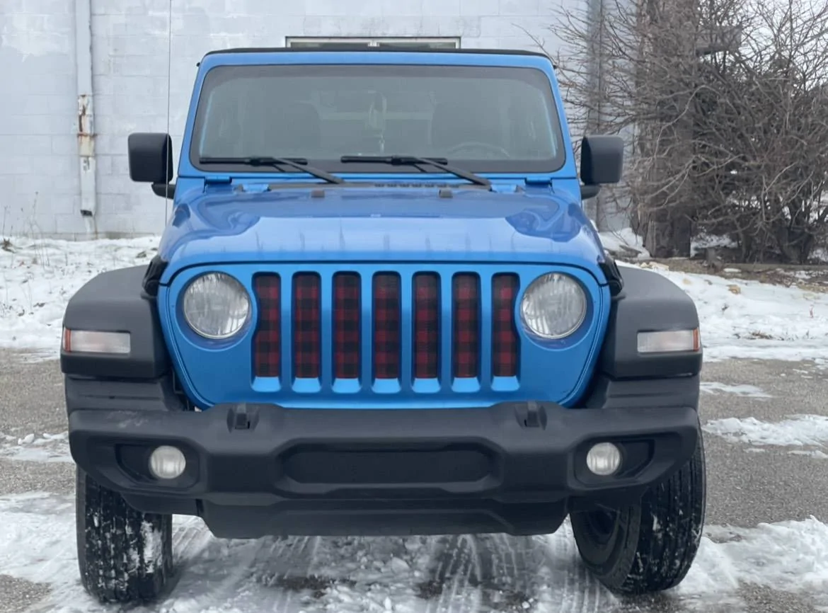

Could always go with a wrap. Keeps the 7 slots.

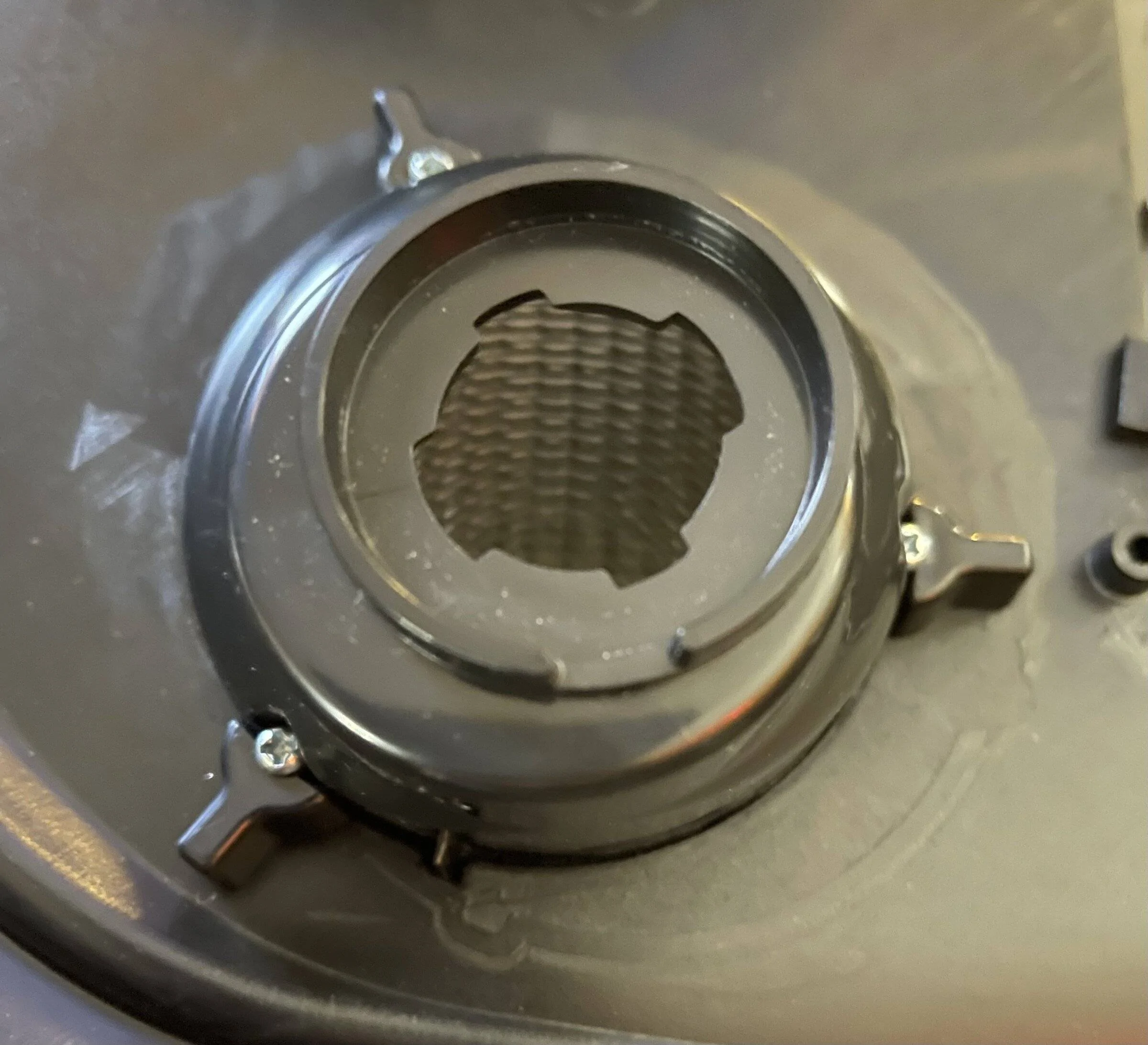

The backside allows for the wire mesh itself to be removed, and it looks like those are real JK light holders, and they can be removed, too:
Jeep Wrangler JL Stylish grills that aren't ANGRY. Do they exist? IMG_0317
Here's a closeup of the back side of the light holders. I'm not sure if those are going to be good for a turn signal to be relocated or if the fog lights might instead relocate into this space? Probably not for fog lights because of the filter.

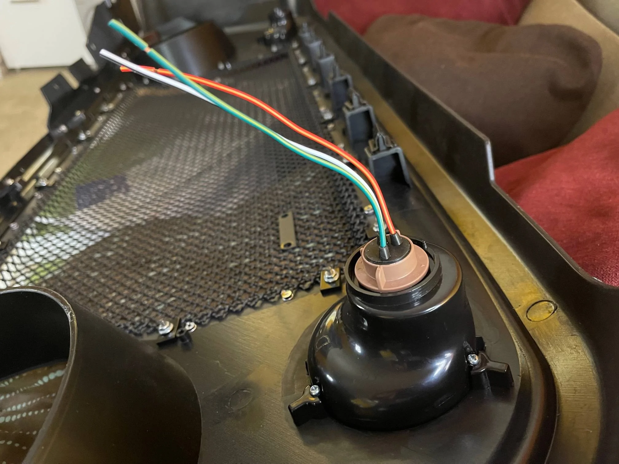

I've verified that these are holders for JK style bulbs:
Jeep Wrangler JL Stylish grills that aren't ANGRY. Do they exist? IMG_0338

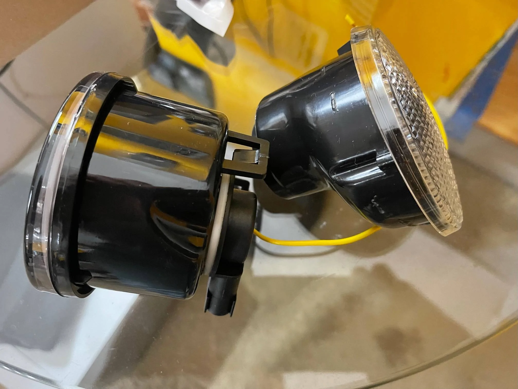

Taking it one step further, I also found that I could completely remove the turn signal housing and replace it with an aftermarket assembly for the JK.
Using an all-in-one aftermarket signal may be an even better idea, so I was able to purchase a pair of LED JK Turn Signal LightsWhite DRL Amber Smoke Lens Front Grille Parking Lights for 2007-2018 Jeep Wrangler JK... for only $10! That's ridiculously cheap!
Jeep Wrangler JL Stylish grills that aren't ANGRY. Do they exist? IMG_0339
Jeep Wrangler JL Stylish grills that aren't ANGRY. Do they exist? IMG_0340

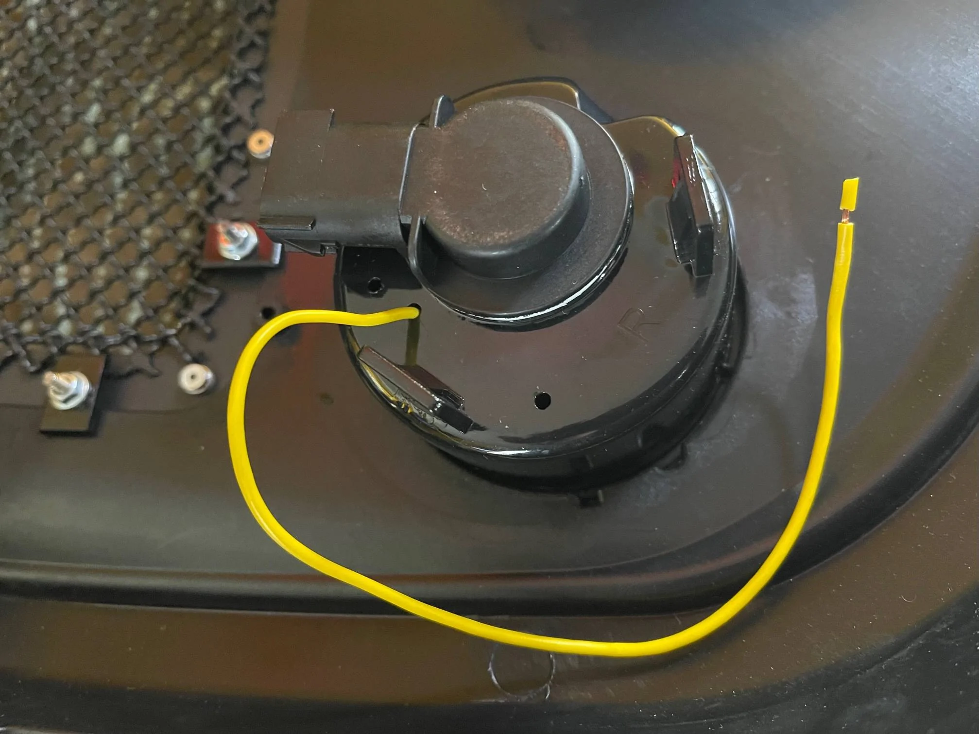

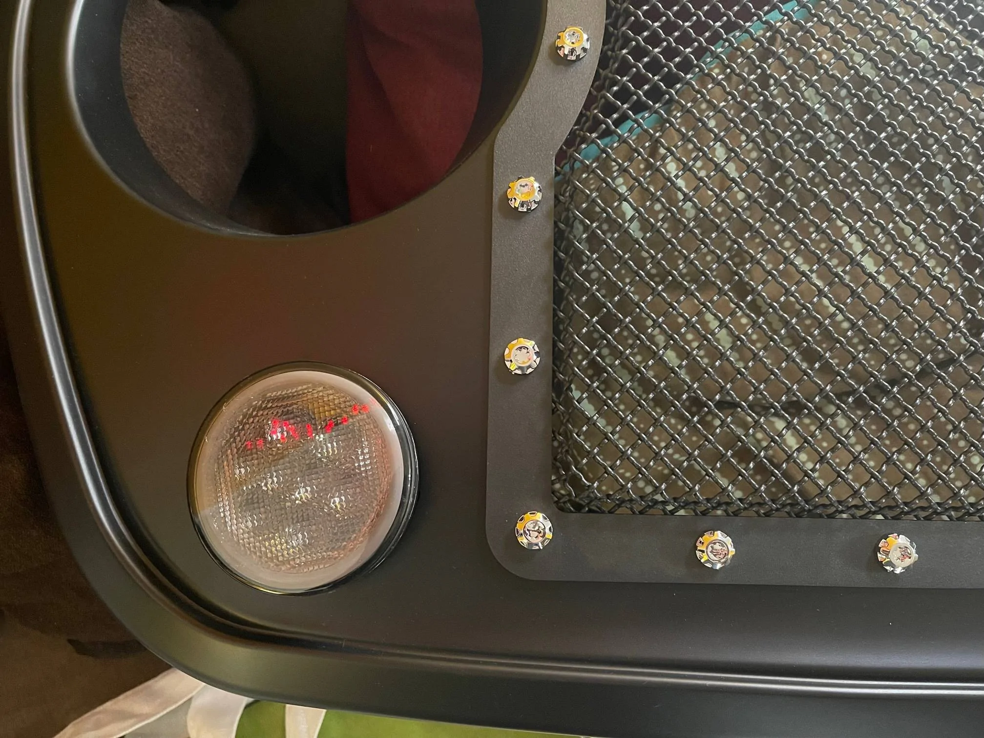

Drill a few holes on the backside to hold the mounting tabs in place with the provided screws, and you've got a solid working turn signal with DRL. All that's lacking at this point are are pair of JK style connectors and then wiring everything up to the vehicle.
Wow. I'm impressed! This option has been very under the radar...
Jeep Wrangler JL Stylish grills that aren't ANGRY. Do they exist? IMG_0342
So, in summary...
These JK style grilles from EAG seem like a great low-cost option for those looking to pull their fenders while still retaining a working pair of signals. Only major downside here is that this isn't plug-and-play, so it's going to be up to the owner to handle some minor fitment and wiring tasks themselves.

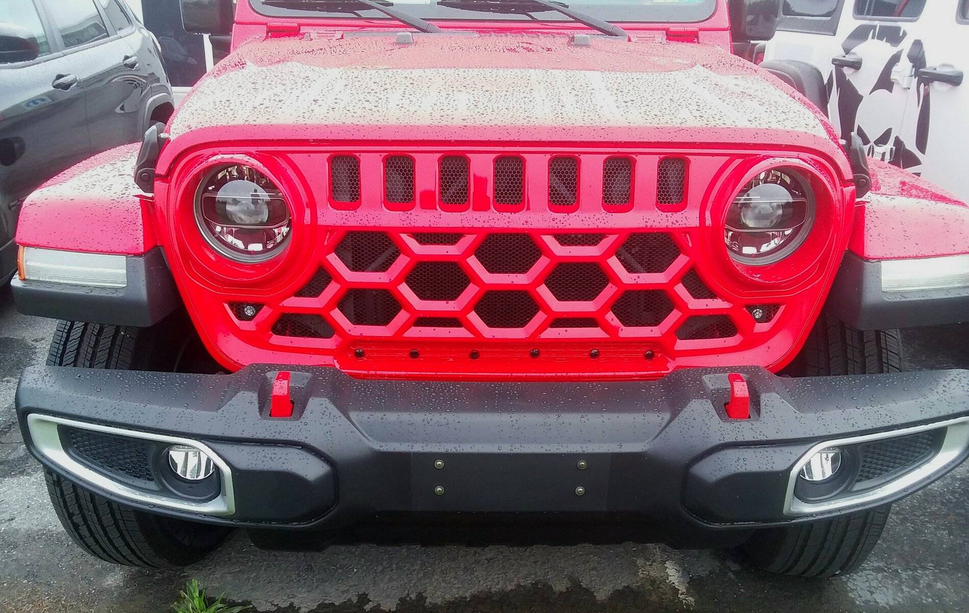

As for non-cranky aftermarket grilles, this...specimen...was on my dealer's lot a little while ago. It was sold as quickly as every other Wrangler, so three cheers beers to the new owner.
Just visible on the edge of the photo is the also-rare Righteous Skulls, Dude! edition Rubicon.

Hey! That looks like ExtremeTerrain's Air Design Pro Performance Hexagon Grille for $325. Round eyes? CHECK. Seven slots? CHECK. They know how to hit the right boxes.
I've always been a sucker for some cyberpunk styling. But at that price point, I'd have to argue between it and the Westin HDX grille (shown earlier)...
Jeep Wrangler JL Stylish grills that aren't ANGRY. Do they exist? 1646593262348
They've been trying forever to sell these things at ~$1500 a pop, which is ridiculous. I've only seen one or of two of them in the wild. But now it looks like Westin could be clearing out their inventory because they're willing to let these go for only $350 shipped.
I can't say that this is worth $350 either. But knowing that they credibly tried to sell these things for over a year (if not longer) at four times the price ends up checking the box for a bargain hunter. Even if this is just a large gaping maw of a grille with an integrated light bar.
Westin's big mouth makes for a good story to tell. But I could go all Deus Ex with the hexagon grille and start to go cyberpunk with the rest of my Wrangler. It'd work well with my custom controller on the headlight RGB halos. Add in a Fab Fours ViCowl or a Hooke Road Visor and Cowl Body Armor Windshield Frame Cover and it starts to tell a cohesive story.

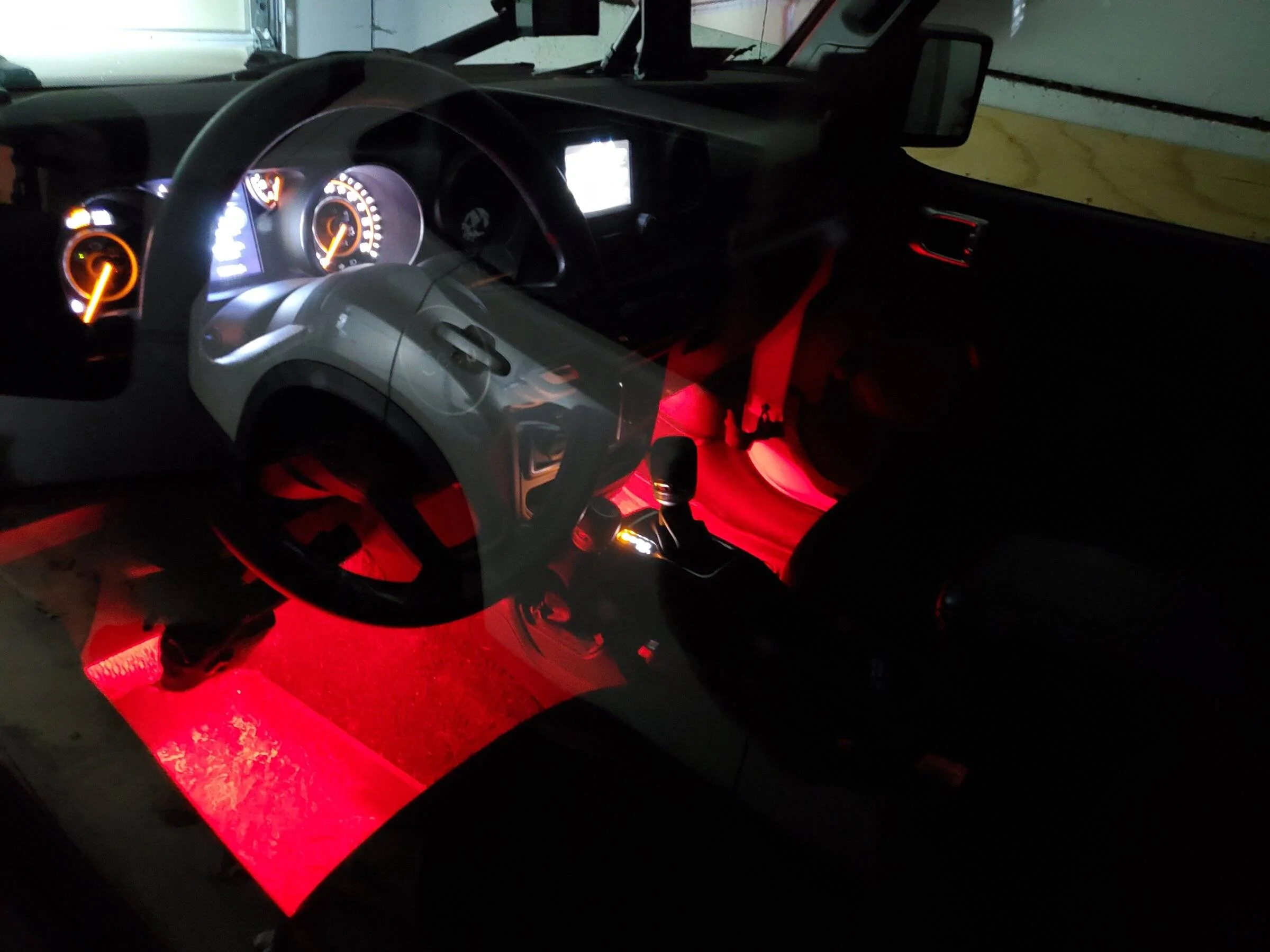

Yellow is a good cyberpunk accent I feel like. Also red if you have a black interior. I leave my footwell glow on red for the most part, feel it gives a good dystopic vibe.
